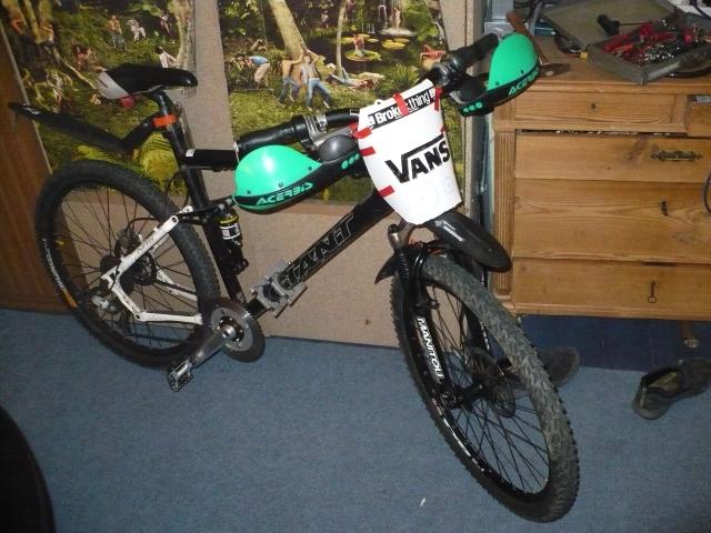

got too much OT, this is the continue of my build. Today I will start making the frame clamps of the gearbox. But first some pics of the bike ( a 2003 Giant XTC Mammoth):
(I bought it for about 400 bucks from the bay, it was only that cheap because the fork leaks and the front brake was missing)
This is the latest version of the drive:

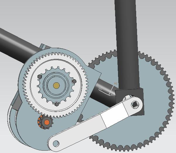

that's right. A DICTA freewheel between rigt crankarm and the chainwheel prevents the cranks from turning while using the motor. I got it from eclipse bikes.http://www.eclipsebikes.com/chainwheel- ... p-998.html The other standart chainrings (44T and 32 T) are just bolted with the standart four srews on it. Yet I don't have a front derailleur, maybe I won't need it anymore when getting support from the motor. I can still shift the front chainring using my right foot :D
Another one on the secondary drive shaft (the one with the small sprocket and the big plastic gear) prevents the motor from turning while pedaling. It's visible on this picture (the sprocket on which the big plastic gear is mounted):
In total there are three freewheels build in when it's done.

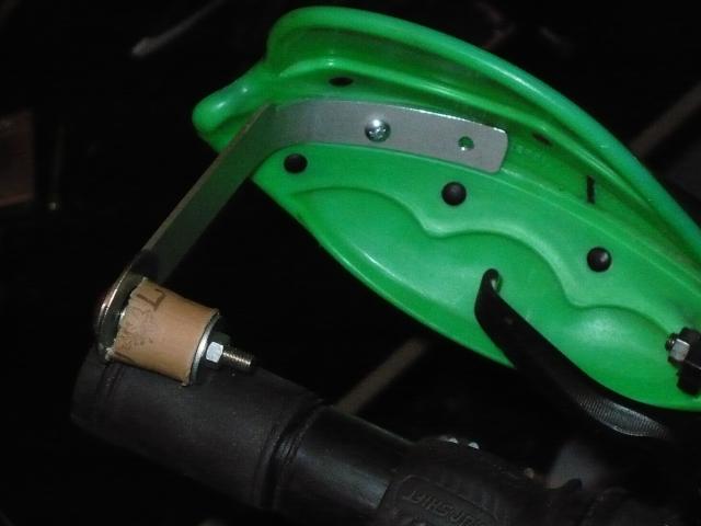

the handguards are simply fastened by a drilled synthetic cork, pushed into the handle bar and then squeezed by an M5 screw. note that the aluminium bar at the side is homemade

Another concept with the 80-100. It is calculated for 4KW @ 4000rpm peak and 2.5KW@ 3000rpm continous.
The chain drive won't survive this very long. That's what I'm researching about concepts with build in gearbox. ATM im thinking of an SRAM S7-Speed hub box build into the output axle of the final drive. This would reduce the tourque it has to handle by factor 2.5. CAD-Pics on that topic will follow soon.
Another idea would be to integrate the shift chain into the gearbox like this phaser gearbox:

The Phaser Gearbox won't work long because it has a 13tooth (or less) sprocket on the crank arm. Even a very light person will make it fail when it engages :(
primary reduction to a jackshaft? what do you think?
