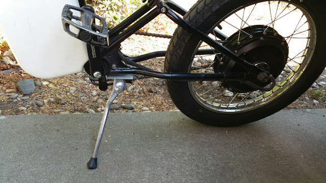

Post by Alan B » Aug 01, 2015 7:01 pm
This is probably going to break in short order, but it is the first attempt at a kickstand on this machine. The mounting location is a bit complicated and mingles with the mount for the chain tensioner.
