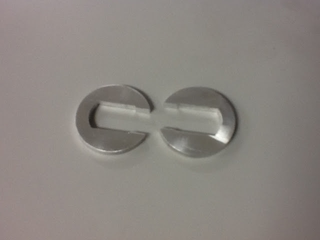

Looks to me like the FW side could use regular flat washer(s) between the axle shoulder and the dropout- 5/8 nominal size would likely work out fine- does this seem right or reasonable to you?
When I'm making up the prototype C washer out of aluminum, 1" OD, what would the most optimal thickness be? Still ~2.5mm? I may be able to do this before the end of the week, for dead certain before the end of next week.

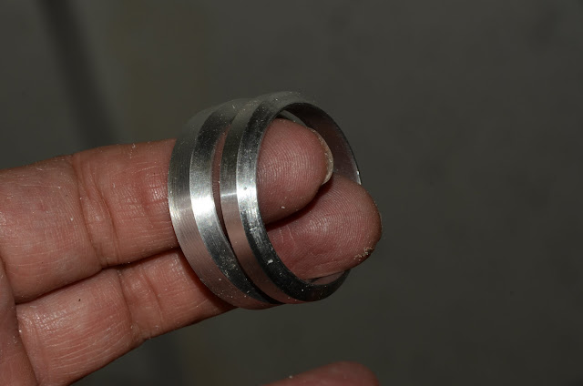

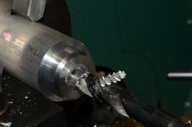

To make a 6mm Schlumpf cone washer:
Start by slicing off some 2" 6061 Aluminum barstock using a special non-ferrous metal cutting blade on a 12" chop saw:
Chuck it in the lathe, turn the OD, face it, cut the 45 chamfer, then remove material from the ID, starting by drilling, then follow by boring out the extra material:
Keep boring until the desired ID is reached:
Part it off, cut the reverse inside taper (not shown) and clean it up, (note the real Schlumpf part is on the right):

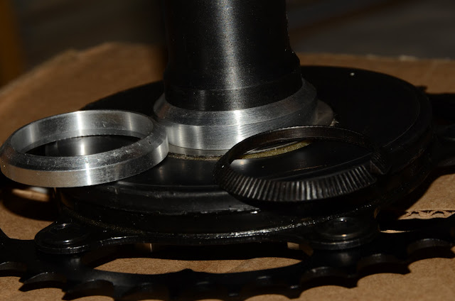

Stock 4mm spacer on the right, homemade 6mm spacer on the left:
Slide it on the Schlumpf drive (4mm aluminum Schlumpf on the left, 0mm steel Schlumpf on the right):
Hopefully this will work where the 0mm and 4mm washers failed.
I had a long day today, getting this made feels good. Hopefully it will do the trick!
Note that they recommend aluminum spacers with steel frame bikes and steel spacers with aluminum frame bikes.

Postby acuteaero » Thu May 31, 2012 9:53 pm
I swear I'm going to make some sick washers for you just as soon as I finish eating, here.
-H

Postby acuteaero » Thu May 31, 2012 10:44 pm
Bam!
Now, to see if they fit right, and how well the design works-

Postby Alan B » Thu May 31, 2012 11:02 pm
Wow, those look great!

Postby Alan B » Fri Jun 01, 2012 7:49 am
Notes regarding the ATS Schlumpf on the Greyborg frame:
The 6mm aluminum spacer was JUST adequate. It may require 6.5mm. Several things seem to be just about touching - the swingarm sticks out beyond the bottom bracket in the ring that surrounds the bearing, and the swingarm tubes, and the screw head for the swingarm bolt. The back of the Schlumpf is a plastic cover keeping lube in and dirt out, and it may be occasionally touching, but there is no pedaling resistance so it is a soft touch.
This 6mm aluminum spacer was not included, but is available from Schlumpf dealers. It can be fabricated if you have a lathe, but it is a $7 part that takes an hour or two to make the way I did it. I chose to make it because it was not clear how long it would take to order one.
Note that for steel frames an aluminum spacer is recommended. The drive comes with a 0mm steel cone ring suitable for an alloy frame that needs no extra clearance.
We also had some additional problems from the shipping damaged ear on the drive in mounting the chainring and getting it to run true. Chainring spacers were installed and the parts tweaked to get it to be fairly true. When the hubmotor is mounted it will become more clear where the chainline is, and the chainring may have to be spaced further out. We did what we could without the motor, hopefully it will be adequate at least to start with.
