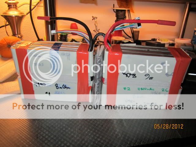

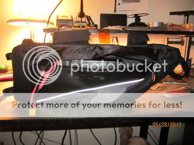

A impulse buy off Amazon, a cheap ($24) triangle bag a Sunlite Epic tour XL. With that bag in mind I started taking my 12s2p square brick of a battery and made it into a flat rectangle. Luckily when I soldered it I left just enough wire to let me simply lay flat without any mods to the battery.

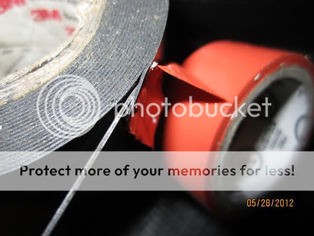

Using a roll of 4" 3M Scotchrap All weather corrosion tape. Stuff is 10Mil thick. In this picture I used normal electric tape and a #2 exacto knife for size comparison.

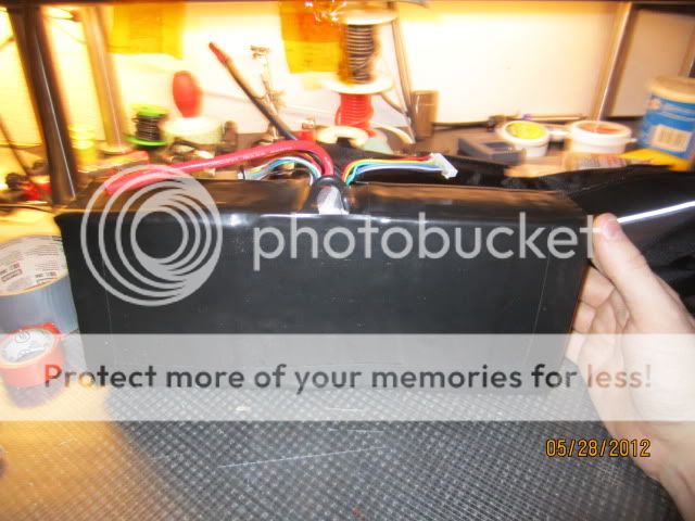

Adding 2 large circuit boards to both sides of the battery for strength and used some thick foam on the bottom I wrapped the battery in 3 layers of the tape. Looks real sharp not covered in duct tape. :)
The new 12s2p battery fits perfect in the bag. Very happy with this impulse buy of the bag working out so far.
