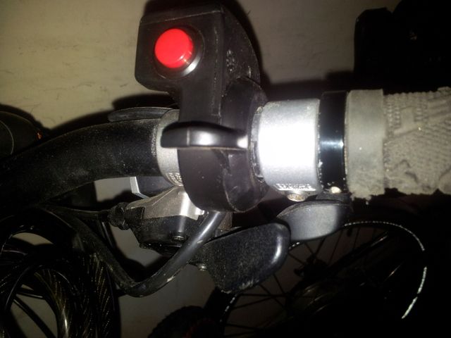

Hey guys - I came up with a simple option that seems to be working: I got a simple round handlebar grip, trimmed off about 30% and slide the shifter and brake lever toward the end of the handlebar. That left JUST ENOUGH room to get a trigger throttle installed and clamped. Build thread with pics shortly....

I ended up robbing handlebar grip to pay throttle. Here's a photo of what it looks like:
A trigger shifter would completely solve this problem and allow me to return to using the stock (anatomic) handlebar grip.
Status Update: A pretty long 28 mile road test is done and the "very far in" throttle worked like a champ. Note that this is a right-hand throttle which is mounted upside-down on the left side.
