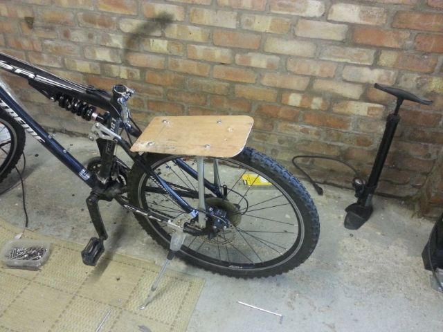

A comment about the above bike. Standard racks hold the battery too far back. It really needs to be right up against the seat-post and as low as possible for best handling. I'd put the spare wire and controller in one of those triangular tool bags at the top rear of the frame triangle, and I'd make my own rack to get the battery in the right position. To make a rack is very easy with some aluminium tube and a piece of plywood.
Ah nice that rack looks good and still allows for rear shockies.
This is temporary for me, my last bike was always a rack mount and, yes it sucks so much having all that weight up back.
I was planning on a new battery soon and/or I was going to get a triangle bag and mount it in the triangle.
