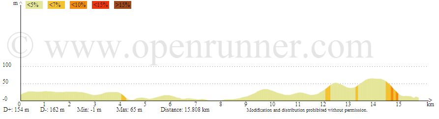

I've been riding a bofeili mid drive e-bike (details here) for a few months, have racked up about 2200km and I'm itching for a project.
I use my bike to commute about 16km each way every day come rain, wind or whatever. I get an average speed (including lights, etc) of 27-31km/h and I'd like to go faster (surprise) and ride a nicer bike (looks and build quality). I used to bike a lot on reasonably nice bikes and the bike parts of my current ride are really not doing it for me.
I don't really want to travel over 50 - my entire commute is either on 50km/h roads or separated bike path.
There are a few hills on the route but nothing really serious, I think.
I pedal the whole way and rarely use the throttle, current setup is 36V10Ah and according to the display peaks around 640 watts. I like to pedal and would like to use mostly PAS. I currently charge at work and can continue to do this if it's a battery that is safe to charge unattended.
