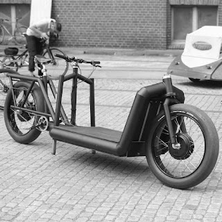

https://www.facebook.com/AnywhereBerlin/?ref=br_rs
I found these guys that built a very heavy-duty frame, but then used a pair of hub motors. Totally not street legal in my state.
Is there a vector controlled hub motor that would do the job with only one?? I doubt it. But then maybe I could use just a controller with a smaller three phase motor, assuming I could find one.
