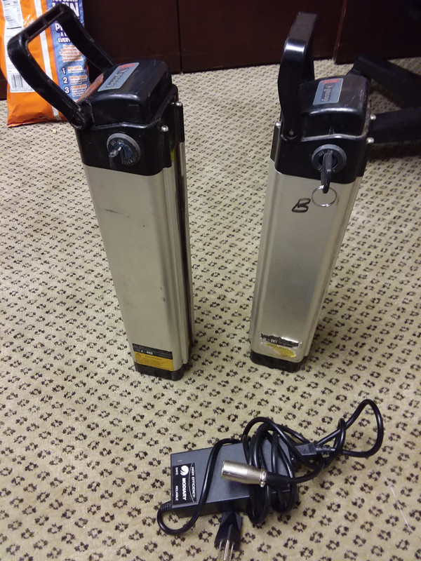

The packs I have (photo attached) I think have a battery management system in there already - the old e-bike would shut off when the pack was drained. But it sounds like I need to open these packs up and take the cells out, get a couple more individual cells, and wire them all together to get up to 10S / 36v.
Can I then use the voltmeter/BMS inside one of the packs on the new frankenpack?
Battery packs made with 12V sla batteries don't use a bms. I't s just three 12V batteries wired in series that are charged with a 36V charger. If that pack has a volt meter on it, you can use it but will probably be hard to see when riding. I'd assume the the cutoff voltage for a 36V sla system will be 31-32V. A 36V sla pack usually charges to about 40V, while a 10s lipo packs full charge is at 42V. You really don't want to run a 10s lipo pack below 35V even though you can go as low as 30V on it according to most lipo specs. Anyway, inside your case you should see 3 12V batteries in series. just remove then and replace them with 2 5s lipo packs in series for 10s. You can put a 10s bms on it if you want to. Personally, I wouldn't bother, but technically you should for safety. I prefer to mange them myself when needed.Not really much to it. Just connect the positive and negative of the 10s pack to the same as the positive and negative wires the 36v pack was connected ]o and you're done. Check voltage and charge as needed. 10AH of 10s lipo should get you more than twice the range as the 36V sla pack and also more acceleration power and speed.

Ok, project update.
I actually have two 7S LiPo packs. The plan is now to combine them in serial to make a 48v pack and overvolt the bike.
Will the charger I have (meant for the 24v packs) charge the combined pack, or is it's lower voltage going to mean the pack only charges to 24v? I suspect the latter, and I will need a new charger.
Assuming the original controller was a 36V controller, you'll likely need a new 48V controller for a 14s lipo pack. As for charging, you'll probably want a new charger rated for a max 58.8V output for 14s lipo. Or, you could split the 14s back to 7s and charge them with a 24V charger as long as the max output of the charger does not exceed 29.4V.
Yes, those sure aint EVG lead battery packs.
Once you put them in series, you will have 48v, which will quickly fry your Heinzmann motor. Even quicker it will fry the original controller.
Tear those apart, find out they are dead inside anyway, and then start over with something 36v.
They're not dead inside, they have a full charge.
I'm thinking that I'll wire them in parallel instead and make it a 24v 16ah pack and undervolt the motor instead. Same hardware across the board (my budget is close to zero) and top speed is not a big concern for me. This is a commute bike not a fun bike.
