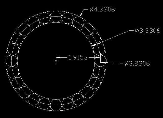

im not done this is just to flush out whats in my head and learn. i know its crude but it was arts and crafts time with my boys when the light went off on how to solve a problem .
http://i251.photobucket.com/albums/gg30 ... runner.jpg
based on these magnets x 24
http://www.kjmagnetics.com/proddetail.asp?prod=D8X0DIA
the black rods would be epoxy'd to the top the yellow to the bottom . once pressed on the shaft they produce the halbach.
if its feasible what would be the best material to machine the disks out of ?
i have to visit the shop and clean up the motor i want to run it in . i should have shots of that in a day or so
if anyone has cad skills but no shop or $ for bits and wants to trade for machined copys of what i do id love to talk .

Postby Thud » Tue Nov 17, 2009 6:19 am
enoob,
are you settled on the size? the 3/8 dia. here:
http://www.magnet4less.com/product_info ... cts_id=115
seem much more experimenter friendly on the check book.
For the cad work-what are you looking for specificly?
just a simple array with the dimensions like this?
the devil is in the details. :wink:

Postby enoob » Tue Nov 17, 2009 7:37 am
lol . yup thats what im lookin fer. now ill mic the id of that stator and see but i had intended on useing what ive seen here to take a shot at fabing one up . :lol: we'll see .
also makes building a jig easy peasy.
thank you

i was also kind of hoping that with the round profile i can get the air gap from stator to magnetic pole down to an optimum ? ive begun to see magnetic flux as something that flows like water but can be compressed and squished ? if so the round profile leaves alot of room.
other wise it had occured to me that some schedule 40 pipe in a 4" od to hold the magnets and something non magnetic bonded in the id may do the job.

Postby Miles » Wed Nov 18, 2009 3:10 pm
It's not just whether there's point contact between magnets, or not - it's also the area of contact........ Reluctance of the air is about 1000x that of steel......

Postby enoob » Wed Nov 18, 2009 3:11 pm
Thud wrote:rhitee,
Those are nice models, thank you for posting them.
9 magnets seem to be a recuring theam in the halbauch array. Are there any other configurations?
If I am interpreting the graphics correctly the 9 will unite to make 1 pole.
Origanly I assumed it was the lower pole count that was detrimental at the scale some of us are working at or
perhapes it is just weaker magnets, very small magnets assembled to create the H.A.
Either way, I apreciate the visuals. please keep contributing.
nice models indeed . more than i had expected to see on this . kinda thought inrunner was a shunned word here :)
would the arrangement of the round magnets in a circle contacting each other change much ? or do those models hold even when the magnet array is bent ?
im going to go look at it again thud but i think we get 1 pole every 4 magnets ? ill see if i can find the vid of the guy with a small inrunner halbach that he put under a magnetic viewer. he has large air gaps and an aluminium ring to hold them in but i found it interesting. ah here it is
thanks miles . unless some one says different ill look at making the outer ring of the rotor in steel . shouldnt be to tough, core of alloy and perimeter of steel ?

Postby Miles » Wed Nov 18, 2009 3:21 pm
I think that everything enclosing the magnets needs to be steel.

Postby enoob » Wed Nov 18, 2009 3:29 pm
Miles wrote:I think that everything enclosing the magnets needs to be steel.
roger that . if i read things right maxumum potential is reached when the steel is at least the same thickness of the magnets . after that i thought i read that steel through to the rotor shaft can can cause parasitic magnetic loss. is it worth the effort to us a non magnetic material in the very core between the rotor shaft and the steel holding the magnets ?
the bonus is ive got steel and aluminium at the farm that i could work into this. yay i love free.
