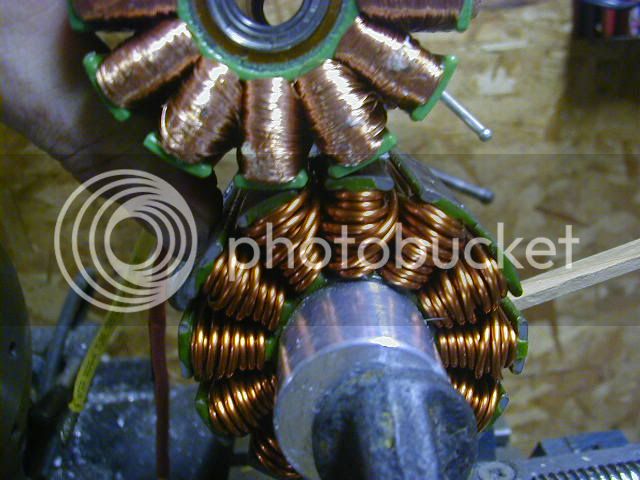

In close up, you can see several "flyers" or loose wires scattered about the stator. Lots of human error found throughout the assembly...several single strand shorts were obvious..but these are wound with 90ish strands of 33-ga wire so I don't really know if this motor would survive very long in its intended applicaion. My big concern is the shorted phase wire...so I dremel'd all the razor edges back & smoothed any areas that may come in contact with the wires.

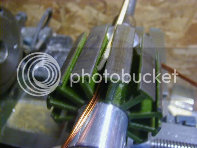

1st, I use a cut off wheel on the mighty dremel & make a slot through the super glue that the cheaters used to hold the windings onto the stator. We are very careful not to cut down to the stator & damge the precious green epoxy insulation on the stator.
Once through the boundry layer of glue, I use a utility knife to cut the remaning windings. Careful fiddling with a Jewlers screwdriver & needle-nose pliers will clean out the stator.

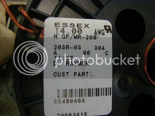

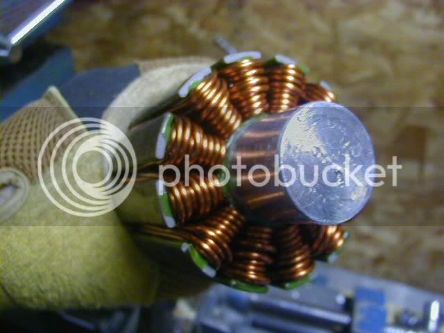

This motor originally was an 8-turn/delta & will become a 6-turn/wye with 2 X 14-ga wire.
Just to overveiw the changes:
(all #s taken from "Drive Calculator")
parameters------------Stock-------rewind
copper cross section--18.9--------25.0
R (mOhms)-------------30.1--------13.5
Delta R ----------------20.1--------9.0
WYE R------------------60.2--------27.0
COPPER GRAMS-------254.5------357.7
Addendum: just confirmed the re-wound Kv is 133
I spun the motor in a lathe at 800-RPMs & it genrates 6.01V on each phase
rpm/volts = Kv

(remember...low expectations) Here it is all wound up & ready to rock.
& next to another stocker:
