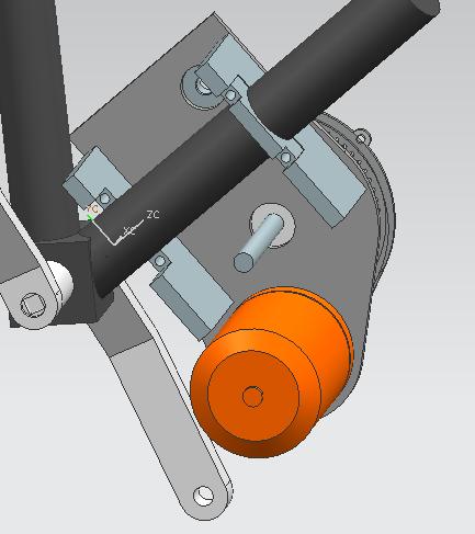

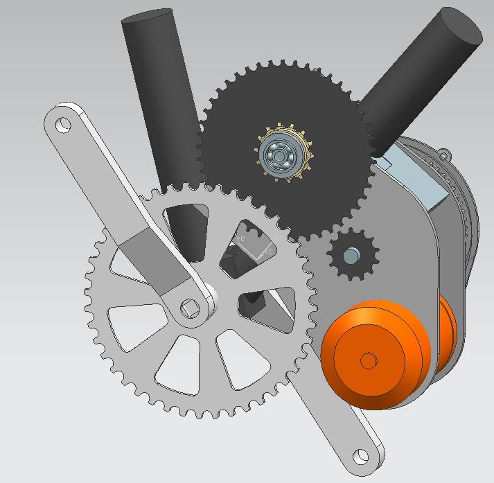

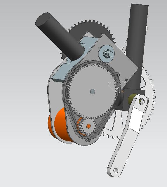

Post by crossbreak » Oct 24 2011 5:22pm
Thanks a lot for all of your help!
Since I could not get a 80-85, I got a 80-100 for the rear drive. The Hub-Motor project will proceed next year. I will open a new thread for this project when I start working next month, I'm still waiting for some parts.
Here are some CAD pictures. The mjaor work is done I think. Reduction Ratios: 1st gear: 30:1, 9th gear 9,5:1

That looks like it will work well for everything, except the bicycle chain at high speed on the second reduction stage.
I would strongly recommend going to a chain designed for high speed operation, like #219. Bicycle chain just doesn't tend to last well at 10x the speed it was designed to operate.

crossbreak, I love your design (in the OP). A few more touches and It will be worth spending some time and money on.

I am intrigued by your animation in your OP and am wondering whether index marks could be placed on the planet carrier and outer ring which would allow fairly precise estimation of the gear ratio by counting.
Miles   100 GW
Posts: 11026
Joined: Mar 16 2007 4:15pm
Location: London UK
Re: RC-Type Hubmotor
Post by Miles » Nov 22 2011 5:33pm
salty9 wrote:.... am wondering whether index marks could be placed on the planet carrier and outer ring which would allow fairly precise estimation of the gear ratio by counting.
Or, you could use my spreadsheet calculator...... :)
