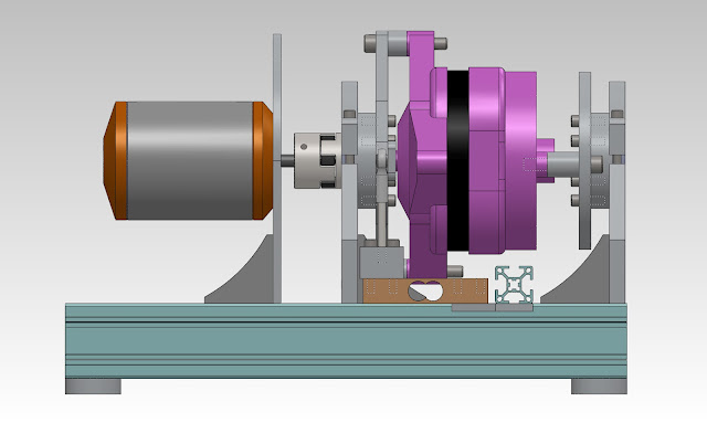

I've been thinking about a design for a compact table-top dynamometer suitable for testing ebike-scale motors for a LONG time- as I'm sure many of you have found yourselves, when thinking about motor and controller projects I always end up back at the need for a dyno to get real data about efficiency/power. As Fetcher's sig says "One test is worth a thousand opinions"-- and the "butt-dyno" is really just an opinion. :wink:
So, after going back and forth over ways to build something like this for ages I've come to this method- I finally sat down and roughly modeled the assembly yesterday. There are unfinished parts, and many missing parts, but it should be enough to get the concept across. I'm keen to hear your feedback if any particular aspect of the design makes an impression on you. I have given a lot of thought to the design and most of the choices have some sort of reasoning behind them- but I'm open to suggestions, and would be happy to elaborate on my thoughts as well.
As you can see, an automobile alternator (in pink :lol: ) is used to absorb mechanical energy. The alternator is suspended on large-diameter thin-section bearings from vxb.com. A Love-joy coupler is used to couple to the motor under test. Aluminum structural extrusion from Misumi is used to support the various elements.
Why an alternator?
  • Cheap and easily available. This is a Delco Remy alternator used on some GM vehicles- I think maybe Northstar powered Cadillacs. There are tons of them available from junkyards, dismantlers or rebuilders.
  • High RPM capable. Since they spin usually something like 2x crank speed they will see 10-12K rpm in service. The rotor is simple, rigid and monolithic.
  • Electrical properties- externally controlled field strength. Essentially, I figure if you shorted the armature phases and drive the field it'll behave pretty much like an eddy current brake- but if you attach a fixed resistive load to the armature coils it'll provide a means to get part of the heat production out of the alternator- while the variable field still allows for torque control. I plan to build a 3-phase load bank using nichrome wire- another topic for another day- I think that picking a moderate resistance value for the load and driving maybe 0-20V on the field should allow for plenty of torque load flexibility across the RPM range needed for a given test- added bonus, if a 3-phase load is constructed it could be re-arranged in "star" or "delta" configuration to allow extra flexibility if necessary :idea:
What are other options that I thought of?
  • Home built eddy-current brake- not a very tough project, but likely to take more effort and cost to build. Also, depending on the size and design will not have the continuous power capability, since all the heat is concentrated within it (will need to be larger for a given power capacity)
  • Commercial eddy current brake- I'm sure something industrial surplus would work great- but the supply is not consistant of these sorts of devices
  • PM motor- in order to regulate torque the load resistor must change value- much harder to computer-automate than just the 20V/10A purely resistive field load.
  • Inertial- An inertial flywheel is great and simple in concept- but can not measure continuous power (no good for thermal capacity tests) and it's harder than it seems to come up with a, say, 12", 25 lb flywheel system that isn't unduly scary, particularly at high speeds :o
  • Water brake- the smallest water brake in current production I found was the Stuska XS-19 which I was quoted about $2k for, as well the torque capability becomes non-linear at speeds under about 2500 RPM- it's just not that well suited to this particular application- though sinking energy into water is indeed a good way to do it :twisted:
  • Friction brake- non-linear, hard to control, requires large mechanical setup to hold all the parts (disc, hub, caliper, shaft...), heat buildup
Exploded view
So- mechanically- the alternator is sandwiched between two plates which are bolted to the front and back using the pre-existing mounting features (with standoffs that are not pictured). These plates have a large center hole and bolt circle, which allows the "bearing boss" bushing piece to mount to it- this part will have a circle of tapped holes to match the mounting plate. The bearing will press over that boss piece and then be captured in another set of mounting plates front and back which are attached via 90 degree plates to the base extrusions. As you can probably guess the motor to test will be mounted on a similar plate and bolted to the extrusion via 90 degree plates. All the parts are aluminum, the outer plates are 1/2" thick, the inner plates are 3/8". The idea is to have the outside contours waterjet cut (I <3 WJ) and then finish-machine bearing bores etc. The rear inner mounting plate mirrors the shape of the rear end of the alternator- it will spaced far enough away so that a shroud could be attached and air forced through the alternator for cooling.
Alternators generally have an annoying semi-stubby, threaded, non-keyed shaft- in this design this can be dealt with once- in order to attach the Love-joy coupler, then any motor to test just needs the mating coupler. I imagine this will probably involve turning the bore of the coupler, keying or pinning the shaft of the alternator. The couplers are cheap, so it's no big deal to machine them to fit any given motor shaft.
A load-cell will be attached to the reaction torque arm- the holes on the arm are 100mm, 125mm, 150mm, 175mm and 200mm from the centerline of the alternator shaft. I have some vauge ideas about a simple data capture system to send torque, speed, voltage and current information to a computer where they can be logged and analyzed.
I think I'll leave it there for the moment- please write if you have questions or comments! I've run this concept over several folks before, but I certainly will value the feedback of the community before I finish detailing the design and start manufacturing the parts!

I made some more time to flesh-out the model after work today- check it out:
I realized that it would advantageous to have a longer torque arm to reduce the force on the load cell- the load cell pictured is the 25LB one from eBay seller scale_bargains . Same as Burtie is using on his cool dyno http://endless-sphere.com/forums/viewtopic.php?f=2&t=35176 I also realized it would be more effective use of material to make the arm and the mounting plate separate parts- done and done.
I was hoping to use Hal's cool model of the HXT80100 motor over in the 3d model repository thread http://endless-sphere.com/forums/viewtopic.php?f=28&t=7832#p119900 but :cry: it was not immune from the file corruption demons. I think my dummy motor is about the right size, even though it is ugly. The motor mount plate is big and stupid with the idea that any number of bolt-hole patterns could be drilled in it to accommodate different motors. The key is that Lovejoy coupler- to allow for a little fudge factor in positioning and to make a standard easy-swap connection for swapping different motors around.
I also realized that the outside contours of every part really aren't critical, these parts could all be made in a manual mill and then cut to rough shape on the bandsaw. I also might just CNC mill them all out--- because that might just be quickest and cheapest for me.
I have tried to optimize this design for easy and repeatable construction- if I build it and it works I plan to release all the drawings, models and BOMs, and document the construction process. Dynos for everyone!
So, any other ideas from the peanut gallery? What do you like about the design? What don't you like about the design? Feedback: Positive or negative- I'll take it :D

Postby Biff » Wed Feb 15, 2012 2:55 pm
The alternator should make a really good load for lower power. I am not sure how powerful those alternators are, I have heard of people pulling 1kW out of a regular alternator for brief periods, if you find you out grow your alternator, it would be pretty easy to replace it with something bigger.
I imagine the load cell you have found on ebay is pretty cheap, and should work well, When I was looking for a nice load cell I came across this place.
http://www.loadstarsensors.com/
They sell a USB package, so you don't have to build an amplifier / filter and stuff, you just plug it in and it works, but they aren't exactly cheap. With a simple load sell you can probably just read the output with a multimeter and if that isn't good enough, build an amplifier and whatnot to increase the accuracy of the measurement, then incorporate it into a computer reading.
The extruded aluminum pieces also make things easy for a small system. If you are hoping to something larger, than 1-2kW continuous you will really need to think about rigidity and vibration damping.
-ryan

Postby Burtie » Thu Feb 16, 2012 5:10 am
I guess the rigidity of the extuded frame could be improved by bolting all the members to a common, fairly substantial, base plate.
The base plate could also serve as a mounting surface for your load cell.
You are welcome to have the relevent bits of C code from my daq setup, but it will take me a while to extract it and comment it up.
Also, the code will probably be subject to a few revisions yet before I am happy with it. Best drop me a pm when you are close to needing it.

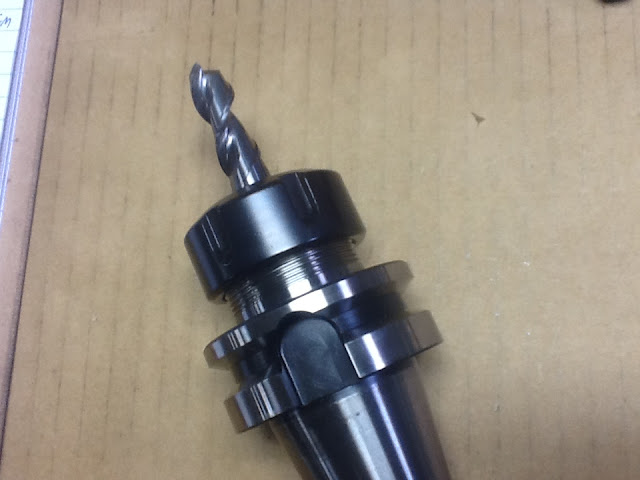

Anyhow- machining the major parts. This is a process I like using for parts made of plate. It works best with plastic, but aluminum can be done just more carefully.
I always start with a good aluminum-cutting endmill- the difference between an aluminum-cutting and a standard grind endmill is very dramatic in my experience.
I set out vacuum gasket around the border of the stock I'm using.
Set the work offsets in the machine based on the position of the fixture- I'm leaving the stock surfaces on the material- flatness is not important- so the offset is calculated from the bottom of the part (top of the fixture)- it's more important to me to not cut through the part into the fixture than it is that the part be a given exact thickness!
Verify the CAM programming for feeds and speeds, then post-process it to generate the NC G-Code file to load into the machine. I use GibbsCAM.
Before running the part for real I like to "dry run" with the tool offset 2" above the final location. This allows me to stop the machine during the deepest cuts and check to make sure the tool is more than 2" from the surface of the fixture- indicating that in the final run it will not cut through into the vacuum fixture.
Engage the vacuum!
And Go! The coolant doesn't cause a problem as long as the vacuum gasket is sealing well. If something goes wrong the vacuum system will suck up the coolant and things get a bit messy.
Twenty minutes later- a part! About .010 of material is left around the part to allow the vacuum to continue to seal. This is removed later with the belt sander/die grinder. It's a little bit of a drag, but it allows these sorts of parts to be made easily without building fixturing, and in only one operation. There are some tricks- that .010 of material is fragile and if the cutter picks it up (the foam gasket can sometimes push the thin material into the cutter and cause the vaccum to be broken) things can go bad! One tip is that if you plan to cut say, five depth steps and then a finish step- you might instead want to cut four depth steps, leaving .100 at the bottom, then in the finish pass cut the last .100, as well as finishing the walls- instead of running the cutter on and off the part over the thin foil at the bottom- where it's most likely to pick it up and break the vacuum. If the foil is captured entirely between two pieces of part- as it is in the center bore of this part there should be no issues. But in situations like the outside contour of this part, where the cutter moves on and off the part- give opportunities for the cutter to pick up the foil and break the vacuum- at which point the part is pretty much ruined. Also, mind the machining forces caused by excessive speed or depth. There was only around 500lbs of force exerted by the vacuum on this part- if I cut in depth steps that are too large or too fast the part would shift around during the cut. Another way to scrap parts!

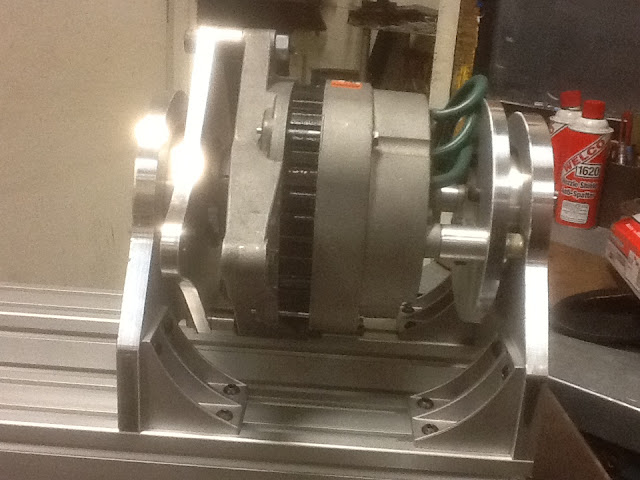

My order of parts arrived on Wednesday and my friend and collaborator finished a batch of assorted parts yesterday- so we spent some time today attending to last minute details and doing a test-fitting assembly. Time to see just how effective my solid modeling and tolerancing was!
These bars are attached to the main base plate and allow for leveling feet to sit outboard.
All the screws and T-nuts are preassembled through the plate so the extrusions can be slid right over. I realize that this is massive overkill, but I figure distributing the clamping along the length of the extrusion will help make it more rigid.
The 90 degree brackets from Misumi have little protrusions that drop into the slots in the extrusion- since once side is bolting to the mounting plates I made instead my friend used an endmill to spot-face the protrusions flush with the surface.
I installed 3/8-16 threaded inserts into the back holes of the alternator.
Here's the assembly- test fit together. It looks really fantastic! The alternator rotates on the thin section bearings along its axis in a very satisfying way! My measurements of the mounting holes in relation to the shaft axis were not perfect- but we turned some alignment bushings that fit along the inside of the main bearing supports and fit with shaft-concentric features on the alternator that will force the plate into center with the shaft. This way the holes in the plate can be drilled extra large and the alignment is achieved during assembly using the bushing. I'll post a photo later to make this clearer.
My friend and I figured that I'm probably somewhere around $650 in at this point. There is still a significant amount that remains to be done- hooking up the load cells once they arrive, setting up the lovejoy and a motor mounting plate, as well as the electrical work of setting up the DAQ system and tachometer/encoder.

Thanks for the positive comments! Since the Grange race I have been working on rebuilding and tuning my hub-motored ebike so that I have something to ride around (keep me happy!) Now that that's about done I will be picking this project back up- there are several tasks that need doing in short order- I will hopefully start making some progress this week. I would like to be able to test this small dyno in the next couple week or two. I have a handful of 6364 motors to (rewind, and) test with. I have backordered some 80100s, I hope they come soon. I also have an Astro 3210 which I am very curious to compare.
Back in march I said:
acuteaero wrote:There is still a significant amount that remains to be done- hooking up the load cells once they arrive, setting up the lovejoy and a motor mounting plate, as well as the electrical work of setting up the DAQ system and tachometer/encoder.
The load cells have arrived now... first up is hooking the Lovejoy coupler to the alternator shaft. I think I have a plan for that, we'll see if it works. Add to that list constructing a resistive load bank. I'm thinking light-bulbs at this point. :idea:

I have gotten some good work in on the dyno project over my winter break- it's almost mechanically complete now!
New since last time:
-Motor mounting plate: This I ended up designing as a two-part system:
The plate that bolts to the skid is used for any different sort of motor- the plate that the motor bolts to is bolted to the face of the fixed plate with the three socket head screws that fit in the circular slots. The screws have plastic bushings that are a nice snug fit in the slots. This allows the motor to be rotated over 90 degrees by loosening the screws and swiveling the plates with respect to one another. The action is actually very nice and smooth, does not bind at all. The purpose of building it this way is so that the load rotor can be locked and the motor can be moved through its electrical cycle and positioned at any arbitrary position, say a position of peak torque- stall torque can then be tested. Or something- it seemed like a useful way to set it up.
-Lovejoy couplers: The motor under test is attached to the load via a L-75 size Lovejoy coupler, which is completely encased in the tube support in front of the load. The coupler on the load is a standard off the shelf steel Lovejoy that I bored to fit the (17mm?) shaft. Torque is transmitted by a setscrew onto a flat on the shaft- not 100% happy with it, but I think it will be OK, if it's not I'll redo it. I made up custom couplers for the motor side out of 6061 aluminum. The custom couplers are a bit longer than standard and have bores set up to work with several different sizes of trantorque bushings. With the two couplers I made I can accomodate 8mm, 10mm and 3/8" shaft motors. There is just enough room to sneak a socket in around the trantorque and tighten it down. It works really nicely. The collar on the load-side of the front load mounting plate has two 1/4" holes through which 1/4" dowel pins can be inserted into holes in the load's lovejoy coupler, locking the load's rotor position.
-RPM Sensor: I added a spindle to the rear shaft of the alternator with 12 alternating Neo magnets on it, and placed a latching hall effect sensor next to it. Works fine!
-Load-cell Mounting: The solidworks screengrabs show the load cell mounted off the side of a piece of extrusion. I tried this and found that the torsion exertited on the extrusion by this setup caused a lot of movement in the business end of the load cell, allowing the whole load to rotate a fair amount. This eliminates the benefit of being able to lock the load's rotor, and throws the geometry out. I redid it with the extrusion mounted lower and a bracket added to eliminate the torsion effect. The rig is nice and stiff now. The load cell appears to return to a consistent zero position as long as torque is applied in one direction only- maybe stiction in the swivel bearings causes the zero for opposite torque to rest in a different place...

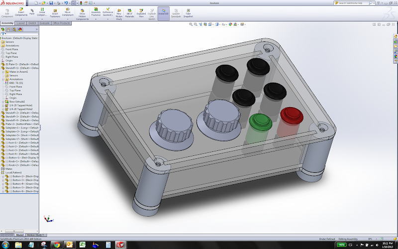

I have a blower that I intend to use to cool the load through a air-shroud that I haven't got entirely figured out yet...
I've been working on detailing out my plan for electronics/software, and buying all the odds and ends I will need. The key component is the LabJack U6 pictured above, along with a little load-cell amplifier. After reading the U6's book I'm pretty sure I can use its differential inputs and PGAs to read the load cell directly. Same with K-type thermocouples for temperature measurement. The internal hardware counter will be used for RPM (frequency) measurement. Where I have gotten a little snagged in my thinking has been when it comes to throttle command output to the motor controller under test, field strength control, and current and voltage measurement. The LabJack is not isolated, and does not isolate the USB connection-- it is reading some small signals with some large amplification- it seems like isolating any connection to any power electronics is a really good idea.
Anyone have thoughts about this? I'm interested in suggestions about the importance of this. I think I have a pretty good plan for how to isolate all the signals to/from the LabJack in question, and then I was thinking moving V/I measurement off to a cycle analyst, having the computer program read the data from it via a USB/serial cable, potentially also through a USB isolator since the CA has zero isolation...

Postby fechter » Sat Jan 19, 2013 2:02 am
A typical alternator can easily do way more than 12v. Most have diodes rated for 50-60v, so don't exceed that unless you know the exact ratings. If you run a higher voltage into the load, you can get much more power out of it for a given amount of heating. Pumping the power back into the pack driving the motor is not such a bad idea (as long as you stay below 48v or so). Since there are always losses in the system, you could never overcharge the pack running. If you wanted to run over 48v, you could get a different set of diodes for the alternator.
Your load cell setup should make for very accurate measurements.
