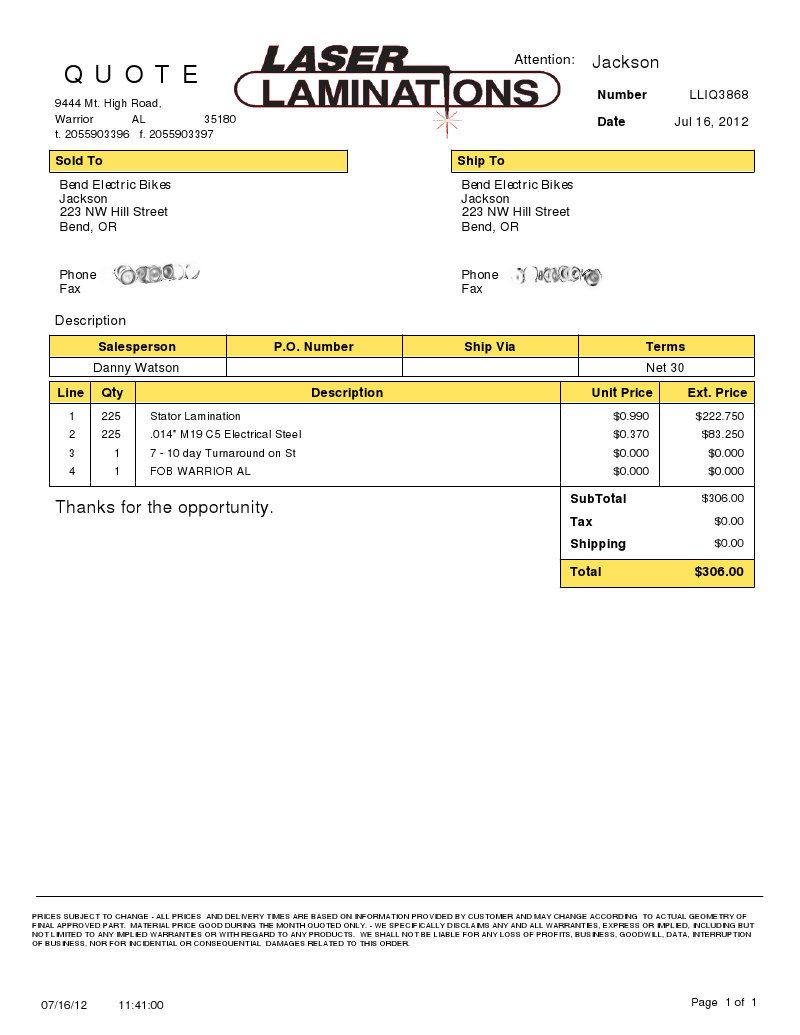

Farfle   1 MW
Posts: 1757
Joined: Jun 27 2010 10:42am
Location: Redmond OR
Re: Miles' 90mm inrunner build thread
Post by Farfle » Nov 07 2012 6:35pm
Not sure if you have a source or not, but laser laminations out of Warrior AL, was very easy to work with, and were very interested in a small motor project. Plus the price quote from them was only $300 for my big outrunner's lams (.014" ~ 0.35mm)
