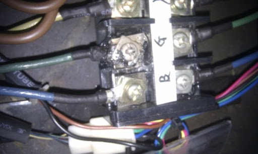

skeetab5780 wrote:i can probably guarantee this is not your issue, but even if your cable is rated at 170Amps it looks like your still using 30Amp rated crimp-on style ring/fork terminals on all of your phase wires. It looks nice and clean, but they're rated for a reason.
Very well observed! But are they rated at any less than the wires themselves? You're quite right in that this seems to be one clear, weak link in this system, and others with the same bike are talking about upping the AWG rating on the phase wires to the motor. I also admit to being unsure of what this implies in terms of the number. I was assuming that three phase wires in parallel with a 30A limit means 90A total limit. I'm just going on what other people with this bike have been doing...
Your note of warning here is well taken. One poor soul in our forum did this to his junction block with an 18-FET controller :shock: :
skeetab5780 wrote:hook a Voltage meter up to your SLA bank while ur riding it, and within 1 minute you'll know if its voltage sag causing the problem or not. Process of elimination FTW.
That was my next plan :) But I have to set it up so I have a meter taped onto my instrument panel and wires run under the seat and tedious stuff like that, and haven't got round to it yet!
skeetab5780 wrote:if its not the Voltage sag the next bet is hitting the Max Amp setting on the controller, from a stand-still moving all that weight can spike a ridiculous amount of Amperage.
I have the Lyen 72v 30A controller and have not had an issue like this..but i also ride a converted mountain bike and im not that heavy (180lb)
Good luck trouble-shooting your issue! keep us posted on the solution.
Thanks :) It's only been a real problem when I set the controller to above 50A, but it has been dicky on a couple of occasions at this level too, usually once the batteries have been run down a little or worked hard for a while. It might just be a combination of lvc and SLAs struggling to keep up. I've only noticed it when I've been harsh on the throttle for a while.
Then again it might be the controller limit... No matter, it isn't a big deal as mostly it runs fine. I did 28 miles on it yesterday (with a long recharge) and it only happened once.

Zenid wrote: I was assuming that three phase wires in parallel with a 30A limit means 90A total limit.
Unfortunatley, no, they're not actually in parallel. Instead, they're in series (or rather, two at a time are, with the third unused at that moment).
So 30A is all you get thru there, if that's the limit of the phase wires and/or connectors and or windings themselves. :wink:
