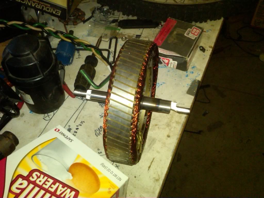

Postby Farfle » Wed Jun 01, 2011 8:15 pm
Here's a shot of a modified stator, You can see the motor end of the wiring loom on the left. Sorry for the bad picture, it was taken while in a hurry to get the shop cleaned to start production of some new axles.

Postby wojtek » Mon Jun 27, 2011 2:42 pm
Farfle wrote:Here are some pictures of a pair of HX motors done up with high-quality 10 Awg wire and upgraded axles for a customer here on the Forums:
great job! have you also find a way to "waterproof" the inside of the motor after making the holes? to prevent from rust? any spray or something?

Postby oatnet » Tue Jun 28, 2011 12:07 pm
You not only copied the initial post in your reply, but copied all the pictures too, which clutters the thread.
At the factory, the windings of electric motors are covered in a varnish which "waterproofs" them, the rest is not waterproof. There isn't really anything Farfle can do or spray to waterproof the rest, and it isn't really necessary. Drilling holes in the side covers is a standard practice for a hot-rod motor (nicely executed here by farfle), and there are many threads about it that can give you insight to the practice, just use the search box.

Postby wojtek » Tue Jun 28, 2011 2:24 pm
apologies - i have sorted it out.
I am wondering if xlyte with holes is a good idea for offroad riding. Quite a lot of dust, little rocks ect...

Postby oatnet » Tue Jun 28, 2011 4:16 pm
wojtek wrote:apologies - i have sorted it out.
Methods has posted several times that he didn't have a problem with dust etc on trails. The search box is your friend! There are several threads that discuss this common, basic modification, so the search engine can get you an answer from a how-to thread without knocking a for-sale thread off-topic.

Postby Farfle » Fri Aug 12, 2011 8:36 pm
oatnet wrote:Meanwhile, back at the ranch... Farfle was machining some nice mods...
9C sidecovers for an ES member, milled with slots in the new jig, oddly enough the bolt pattern is identical to the HX series xtalyte motors :shock: only found that out after making a second identical jig :roll: :
The bit got a "flake" stuck to it and caused a small disturbance in the force :evil: it only succeeded in scratching the paint tho :D .
But Anywho down to business, assuming the deal goes thru, the first 6 lucky ES members that send me a PM can reserve one of three 5404s or three 5403s done up with all the mods. Here is some info on this bad-arse modded motor:
motor core cost: TBD
Axle mods, Bigger/smoothed wire groove, bigger axle flats, all tempered and case hardened $20-$60
milled sidecovers $40
Wiring upgrades done with Polarwire Arctic Ultraflex Blue in either 10 or 8 AWG. Want to know why I use this wire, just ask $35-$45
Hall sensor replacement done with genuine Honeywell SS41s, high-temp glue and wiring $40
All the mods done for 35 bucks off the total, $150 even.
These motors should be capable of some ridiculous horsepower, 10-15 kw is easy for these guys.
[edit] also, 45 bucks for matching clamping torque arms, also tempered and case-hardened. Built to fit [edit]
