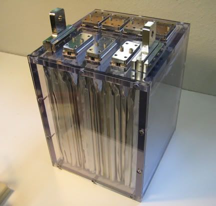

Postby cassschr1 » Tue Feb 07, 2012 3:43 pm
Can you show me a picture of a clamping bus barPLEASE How can I buy em, if I can't assemble the cells. Cass

Postby amberwolf » Tue Feb 07, 2012 5:25 pm
There are a number of different clamping bar designs here on ES that you can make (I'm not aware of any commercially available ones yet, except for the ones EIG seems to be using with their own mounting hardware for their own cells, based on the pics that have been posted of such packs). Most of these are beign used on 15/20Ah A123 pouch cells, and are in threads about the A123 cells, some of them are older threads (more than a year) and some more recent (a few months, I think).

Postby FFR Trikes » Tue Feb 07, 2012 5:30 pm
countermeasure wrote:I am interested in the clamping buss-bar. Are these parts from DowKokam? Or do you have to make your own clamping bars?
I want to build 1S3P, 25 Ah. Is there MSDS sheet available for the 25 Ah?
How do you solder to the battery tabs? Is it aluminum like A123 20Ah?
Thanks.
cassschr1 wrote:Can you show me a picture of a clamping bus barPLEASE How can I buy em, if I can't assemble the cells. Cass
The manufacturing of the clamping buss-bar pieces is up to you guys, they're relatively simple by design. Here's a great example from the folks at Plasma Boy Racing:
Obviously, they're handling a ton more amperage, so the copper or aluminum bars don't need to be nearly as thick for these applications. There's a lot more photos of their setup here: http://photos.plasmaboyracing.com/LiPol-Module?page=1
Do you mean 12S3P? What total pack voltage and Ah are you shooting for? The positive tabs are aluminum, the negative tabs are nickel. They can be soldered directly to one another with a standard high-heat iron, if you don't want to do the assembly mechanically.

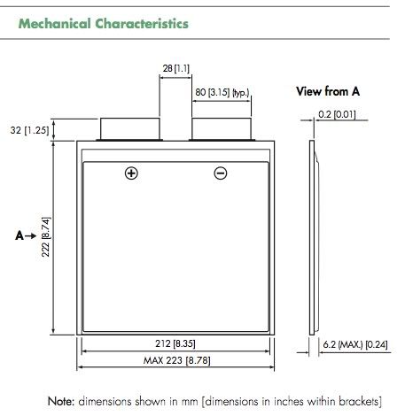

Postby cassschr1 » Tue Feb 07, 2012 7:07 pm
I thought of a way to clamp them. How high do the tabs stick above the cells. ALSO how thick are the tabs....in thousandths.
cassschr1
Posts: 507
Joined: Fri Aug 14, 2009 11:57 am
Location: LaCrosse, Wisconsin
Re: Group Buy: Dow Kokam LiPo Cells
Postby FFR Trikes » Tue Feb 07, 2012 7:16 pm
Hey Cass,
Tabs are 1.25" tall, 0.01" thick on the 25Ah cell.
The tech sheet for the 25Ah cell is attached. Thanks
-Tommy
SpecSheet_25Ah(1).pdf
