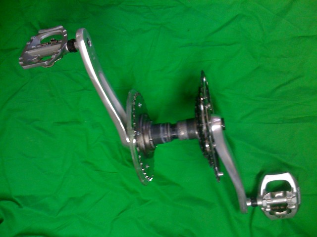

We had ACS make up a batch of custom flanged freewheels (based on Crossfire) with 5 threaded 5mm holes and 5 unthreaded holes for 5mm screws, so that you can attach unthreaded or threaded chainrings to them. That makes them pretty versatile. If anybody is interested, we can put more info here. Here are a couple of photos:

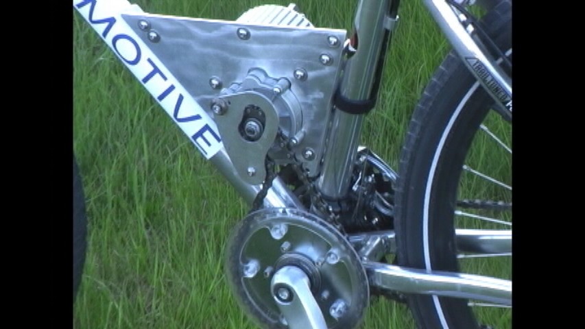

Here are 3 different uses of the freewheel with chainrings. (And now I wonder if there is a name other than "chainring" for the steel discs; I have to admit that can confuse me too.)

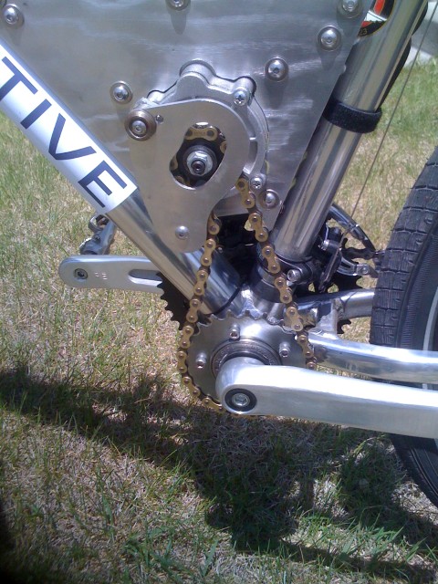

1. Single steel "chainring", in this case mounted on the left side of the bike and motor driven. Freewheel allows motor and chain to be stationary while cyclist pedals. If the disc-type chainring is threaded, then the unthreaded freewheel holes are utilized; and vice versa.
Same architecture with smaller "chainring", in this case providing a considerably taller final gear.
2. Dual steel "chainrings" (one driven by a motor, one driving the rear cluster), mounted on right side of bike for fairly inexpensive setup but losing the usual triple front chainring feature and requiring movement of the motor-chain when pedaling (presumably there would be a freewheel at the motor shaft). Here we can use the non-threaded holes in the freewheel flange if one of the chainrings is threaded. If both chainrings are threaded, then one of them would be drilled out to remove the threads. We used a spacer between the freewheel flange and one of the chainrings to make room for both chains in simultaneous operation.
3. Triple chainring setup (utilizing custom spider):

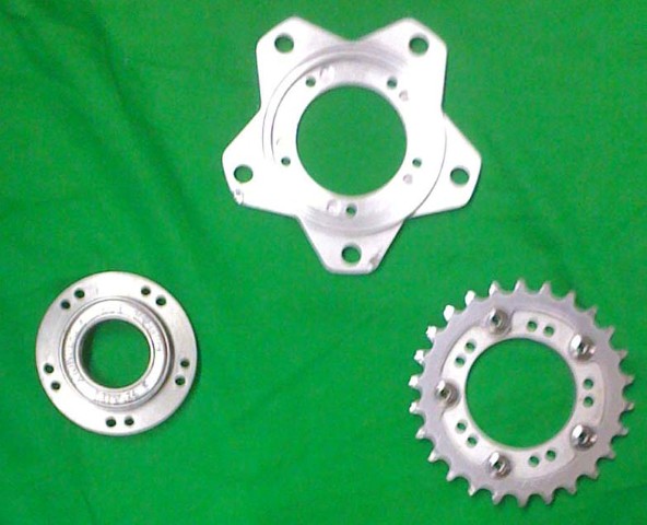

The parts, showing a 74/110bcd 5-arm custom spider. The middle chainring is centered over the freewheel flange, while the granny and outer chainring are balanced on either side. Not shown is that more recently we combined the two custom parts into one, so that granny and middle/outer chainrings are attached to a single custom spider.
How the parts fit together.
Another view.

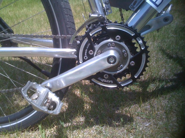

Finally here are the 3 chainrings mounted and fully operable on the right. Here we used a "64"/104bcd 4-arm custom spider but with a custom granny whose inner diameter cleared the freewheel shoulder.
This is our power integrator, not yet in production, that shows left(motor) and right(cyclist) freewheels, and with a single chainring on the left and a triple on the right. The concentric drive in the BB allows the motor to drive the chainrings through the BB from the left side of the bike without the cyclist having to pedal, and for the cyclist to drive the chainrings from the right side without the motor chain spinning.
The custom freewheels can be had for $15 plus shipping. We're working on making available the custom spider and concentric drive.

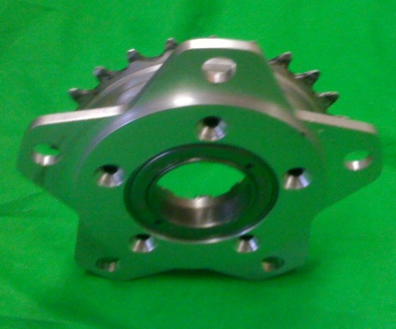

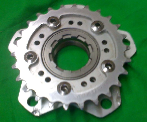

Can you post pics of the internals of the freewheel? What watts have you successfully put through them? Have you had any fail? If so, at what power level did they fail? Cool product!

Postby MotoMel » Thu May 24, 2012 2:50 pm
Have put 1000 watts through without any apparent issue whatsoever. Simply have not tried anything larger yet. I suspect that a lot of its success at higher wattage will depend on the ramping up that the controller does, so that parts are not slammed.
It has time and again pulled a 320 pound rider/bike combo up 12 percent hills, and then run at 30mph plus on the flats. You have to have a motor that's up to it, though, along with appropriate gearing; I ran a couple of our motors too hard and they are "no longer with us". Holding things together solidly is the most significant reason that we had the 10-holes freewheels made.

Postby StudEbiker » Thu May 24, 2012 3:21 pm
I just meant the internals of the freewheels to see the teeth and pawls.

Postby StudEbiker » Thu May 24, 2012 4:39 pm
Right, I have seen that thread too, but as this is a new product not offered before, then I don't think this freewheel would be featured in that thread. :wink:
If it has the same internals as a Crossfire then that would be very exciting as that is one tough Freewheel. IIRC though even the ACS FWs had different pawls and teeth from each other.

Postby MotoMel » Fri May 25, 2012 2:29 pm
Yes, it's a flanged Crossfire. And to be more specific it is the std Crossfire not the Pro.

1. Sideplay: There is surprisingly little - I'm measuring 0.5mm or less at the outer circumference of a 52T chainring.
2. Noise: I don't have a db on it, but they are closer to silent than to a noisy rear-wheel freewheel. You'd notice it close-up but it's not remarkable. (I have heard some other crankset freewheels that are so loud that it's hard to hold a conversation near them!)
