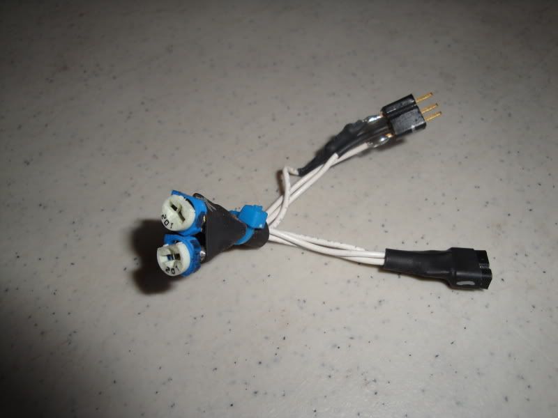

That neat having the pots adjustable. This way we can set what we want for 1st & 2nd speed.
Awhile back, at methods suggestion, I made one of these to go on the throttle wire to control the range of the throttle. Works great.
May your tote always stay tight and your edge eversharp :wink:

nicobie wrote:That neat having the pots adjustable. This way we can set what we want for 1st & 2nd speed.
Looks good Nick! Pretty minimal and can be placed next to the controller. But since there's no remote switch to mount on the handle bars I guess you can't change the speed on the fly... you have to stop, get off the bike in order to switch it right?

It's not made to do what methods unit does. It just fine tunes the throttle range to get rid of dead spots.
Methods unit is the real deal.

Is there any ideal placement location thought of to put the potted adjustment part on the bike somewhere hidden or out of sight?

I'm gonna put the potted adjustment blob near the controller. There is normally a cluster of connector plugs about 5 inches away from the controller that I normally just wrap up in electrical tape to protect from dirt and moisture. I figure just putting that potted blob right there as well.
deVries wrote:Is there any ideal placement location thought of to put the potted adjustment part on the bike somewhere hidden or out of sight?

I plan on placing the potted mass in my battery box, if it will fit. If that doesn't work, sacmans approach seems to be the way to go. Camouflage the wirey mess with another wirey mess :lol:

Best bet is to jack up the ass end of your bike so that you can do some testing. I like to flip my bike upside down... but this can be dangerous :twisted:
I would raise up the rear tire, secure the potted module with a piece of tape, take a screwdriver in my left hand, twist the throttle in my right hand, and turn the pots while watching the speed readout on your ca.
Matthew has some rough numbers he can share... but the problem is that the circuit is dependent on your controller input resistance so any absolute percentage mappings he gives you will be skewed a bit. Just look at your freewheel speed, calculate your desired percentage, and tune to that speed. (if you want to get all scientific ) :mrgreen:

They are not set at any particular setting right out of the factory right now. I did hook them all up to a bike and test them so they may be sitting at the maximum or minimum resistances for each trimmer pot.
I will have to look at my notes later to see what the exact percentages I found when hooked up to my bike.

The pots that are potted in epoxy are much smaller than I thought they would be. I can't wait to put these things to the test tomorrow morning and tune it up.

We toyed with the idea of installing larger 1-turn pots that you could adjust on the fly. In the end we figured folks would test and tune then pretty much leave it alone so Matthew went with the much smaller 10-turn pots that have more resolution and are less likely to get bumped.
