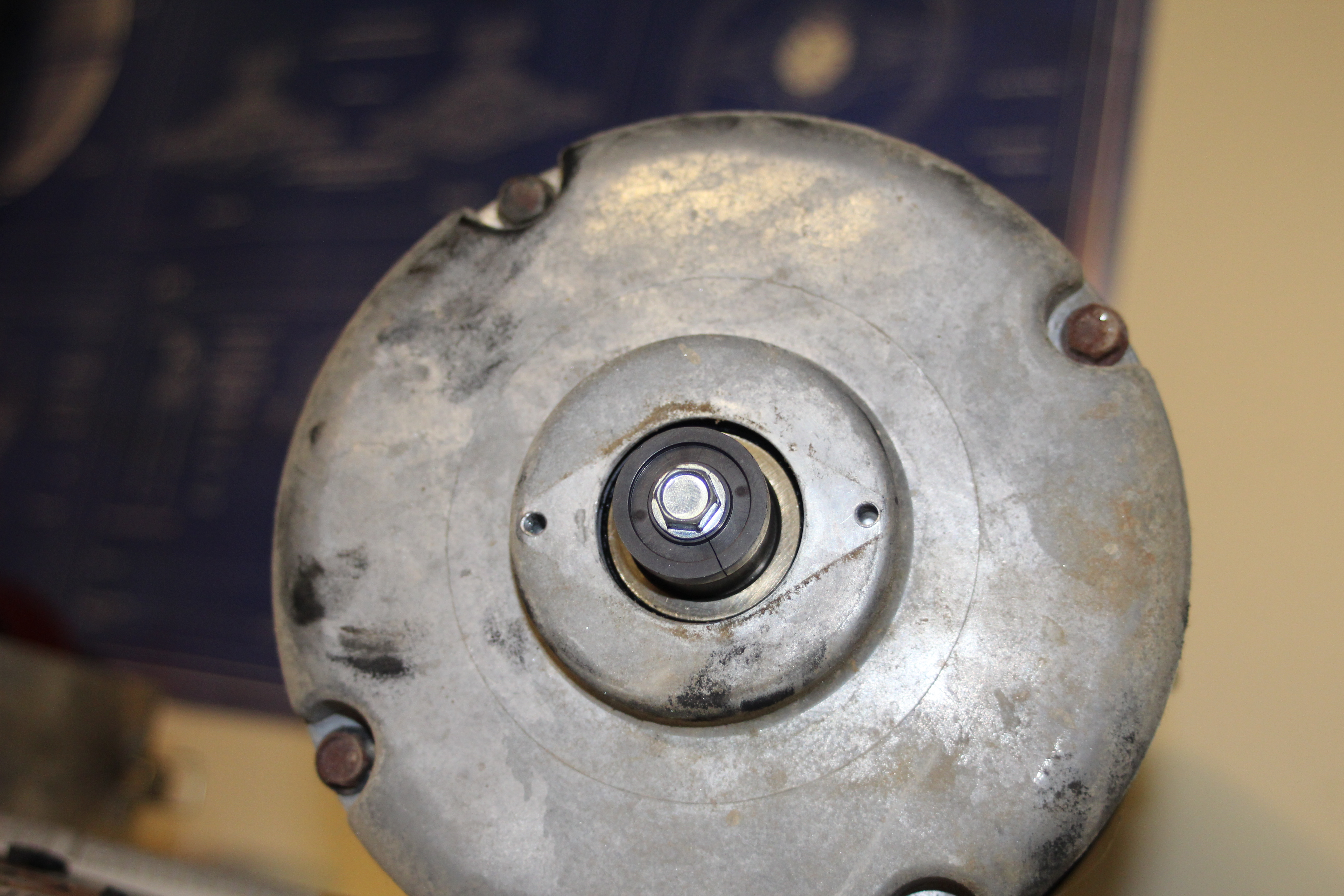

for the next step i demount the DC-Brushmotor
i also demount the axel
the rame is a real lightweight and easy to lift
and again rost everywhere

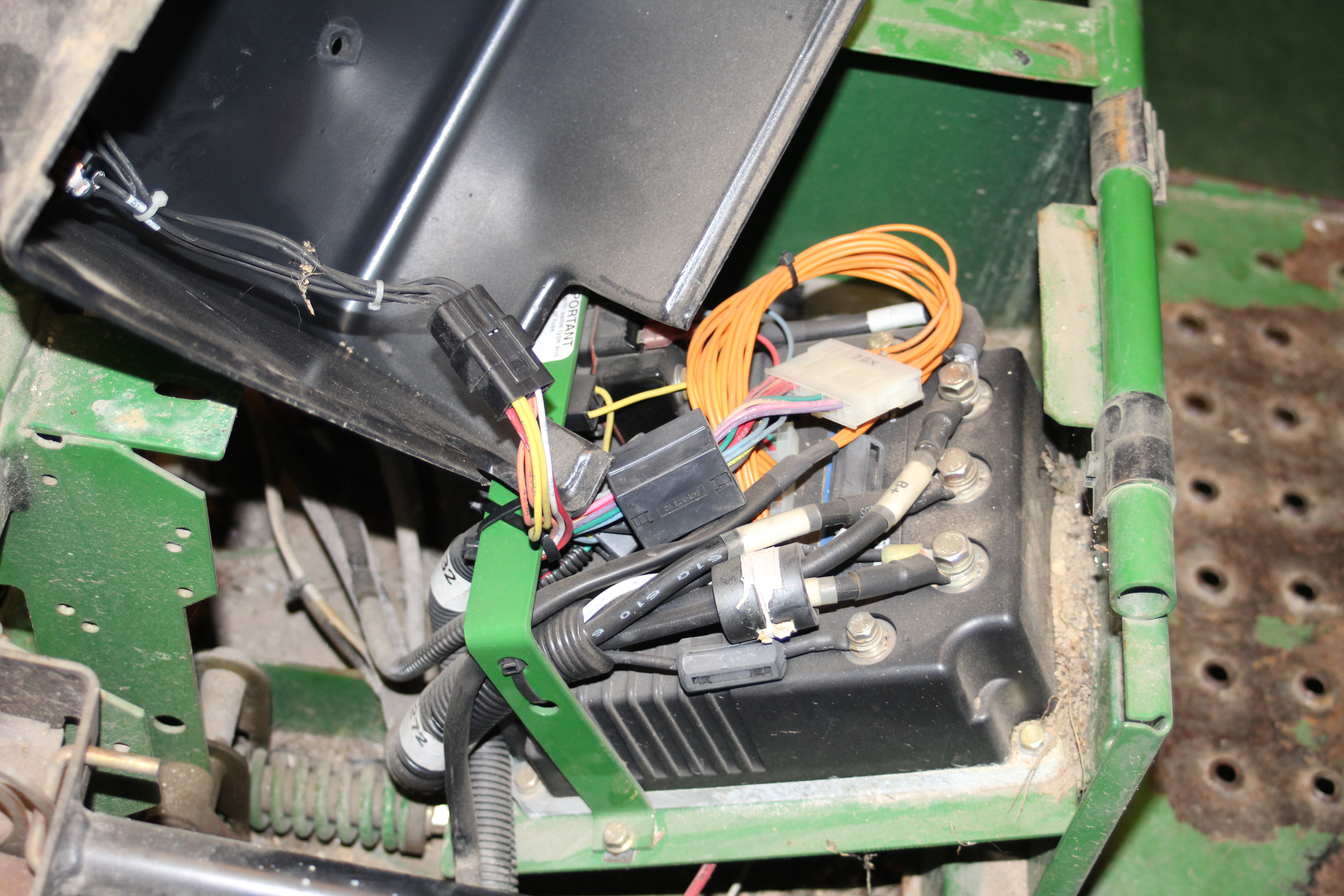

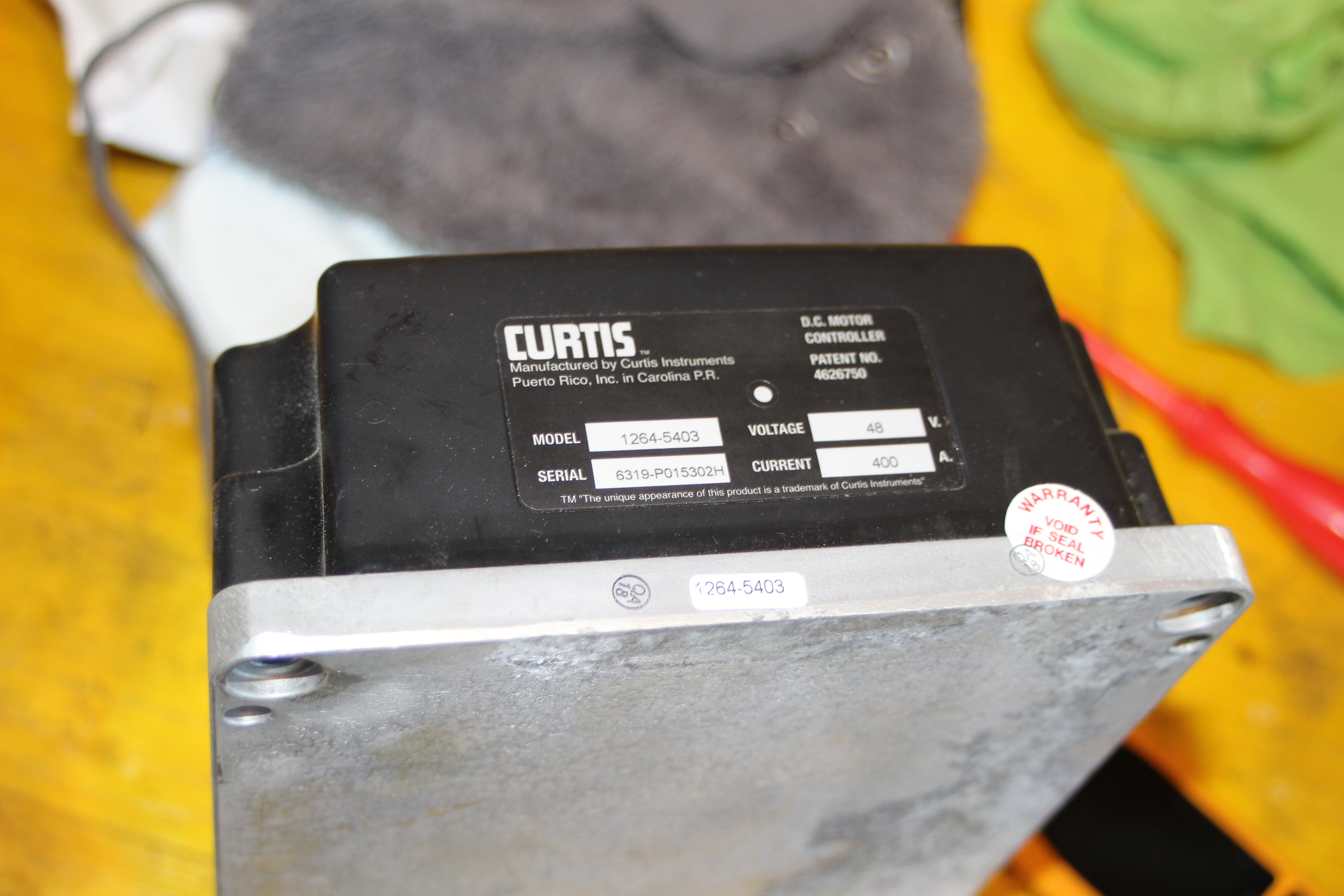

the controller -gasket was broken i made a new seal (luck there was only a little oxidized inside )
inside the controller

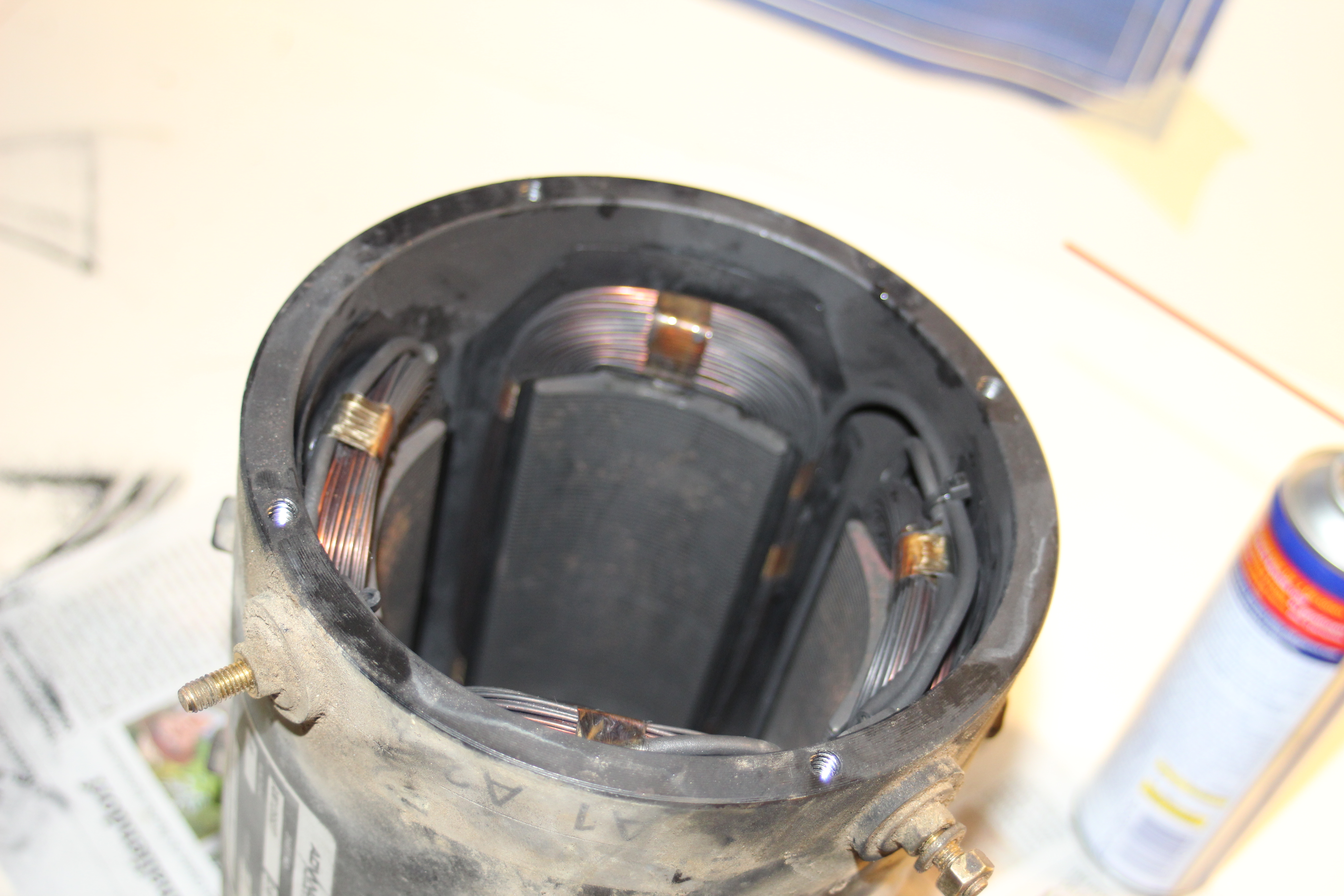

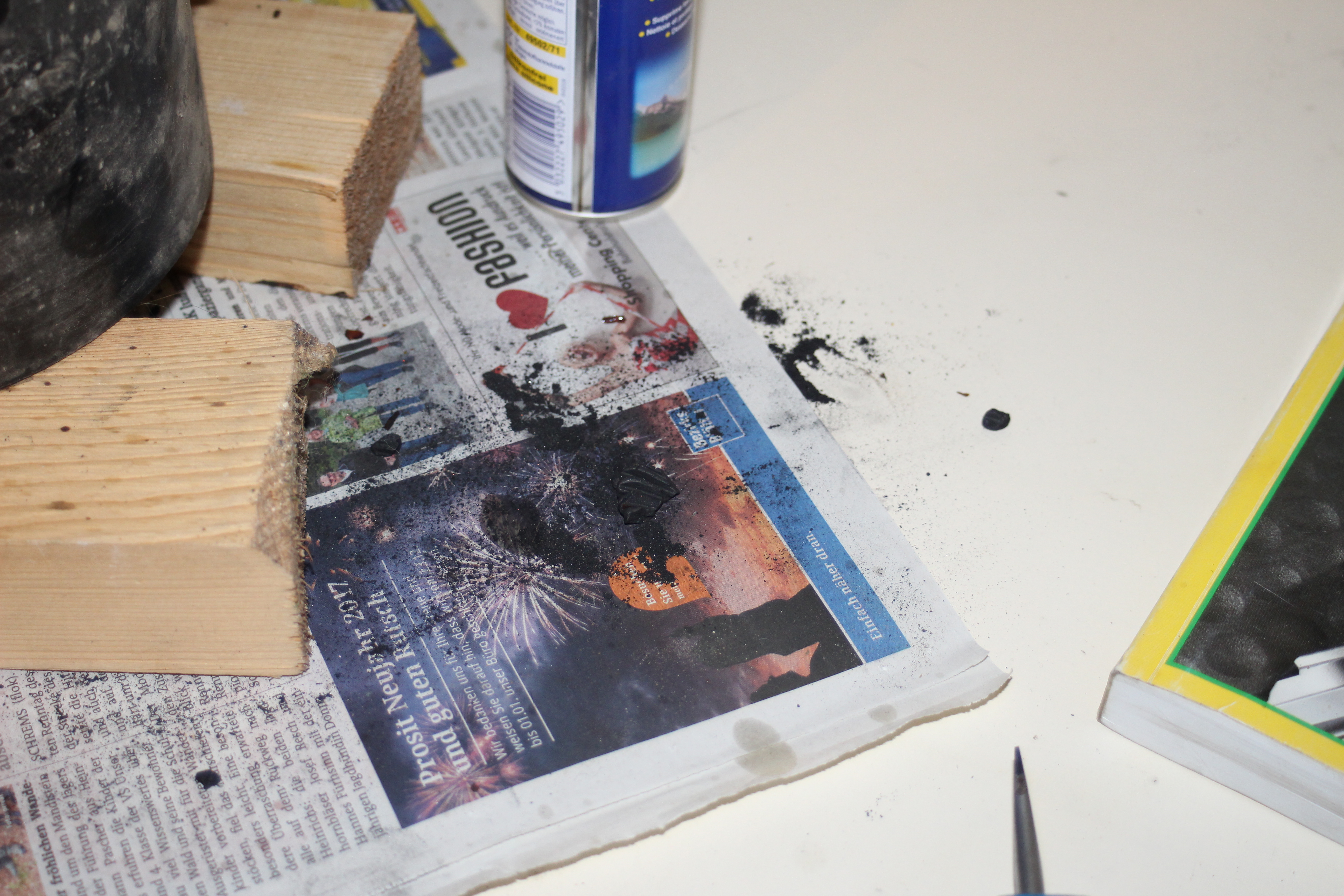

so next work clean the DC- motor and repair the dead TachoPOL-Wheel
much dirt inside

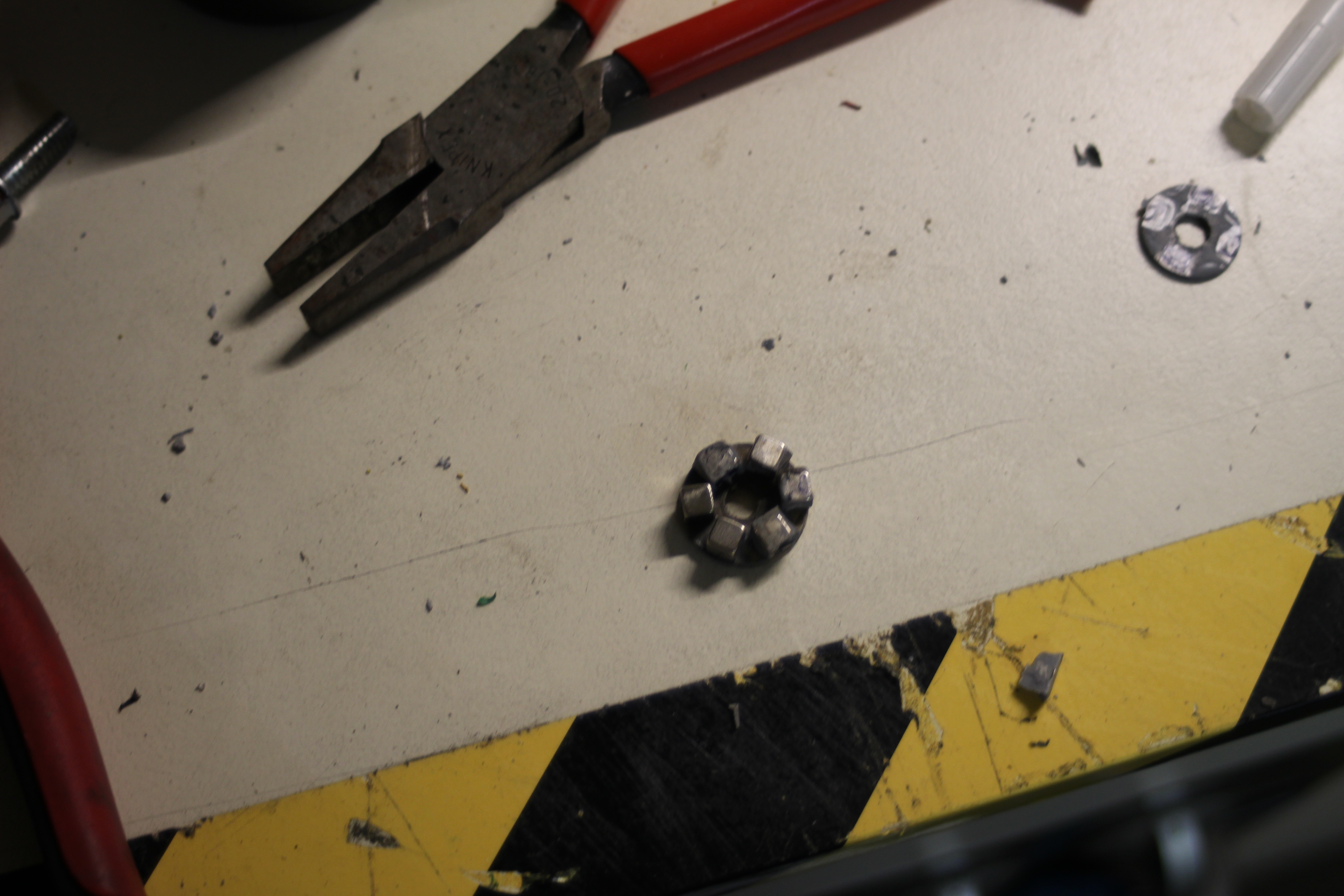

the old TachoPOL was broken so every broken Magnet build two new poles (North andSouth)
Thats the reasen why the motor turn to slow !
i build a new tachoPOl with little neodymmagnet N-S-N-S-N-S
after clean the motor i chek the Brushes they look really good so i dont change them !

Cell data =Panasonic NCR18650PF 3.6 V 2900 mAh (10Amp max )
i solder 13s *20 Cells so i got 46,8 Volt nominal and 58 Ah
i know that 58ah is not much but i calculate this Vehicle for a max range that i need is 10-12 km so it is fine .
the Controller does made 400A max for short time but continous it is between 100-130 Ampere .
First test drive i controll the heat of cell´s but the never get real hot ..so this DIY accu is fit perfectly .
And the fuse is a 200amp fuse so there is no Danger to the Cells .
