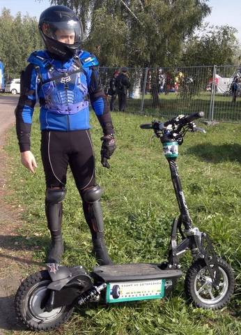

New project E-KickScooter EVO - Upgrade E-Scooter EVO.
Rear wheel: Hub motor direct-drive 500w/48v (12 inch)
Front wheel: Rear Rim (Single Threaded) with 5-Spokes for 12-1/2 inch
Battery: LiPol 28s/10ah (14psc)
Controller: Infineon Lyen 12 FET 84-132V High Voltage
Maximum speed: 67kmh
Maximum range: >35km
Weight: 31,8kg

1) The power put into the motor 1,5kw (continuously) and up do 2,5kw (peak).
2) With a power of 1,5kw can go a long ride (~20 miles).
3) Yes, with a maximum speed I can only move on a flat road with no wind and no burnout motor and controller. At high speed, very good cooling on the move.
4) This is motor sensored.
5) Yes, this wheel is greater than the EVO, but it can be put back without any problems, do not need to hack.
6) I charge the 24s battery charger Hyperion EOS1420i and for this I break it into two parallel parts of 12s. Balancer wires are also parallels with a special connector (it can be seen in the last photo).

Replaced the controller on Infineon Lyen 12fet High Voltage and increased the voltage of the battery - LiPol 28s/10ah (14psc).
Maximum speed increased to 67kmh and maximum range > 35km.
Add my photo that was made yesterday.
