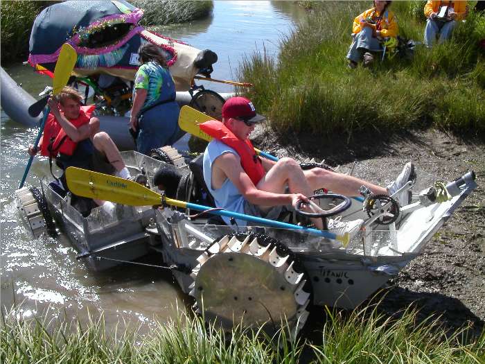

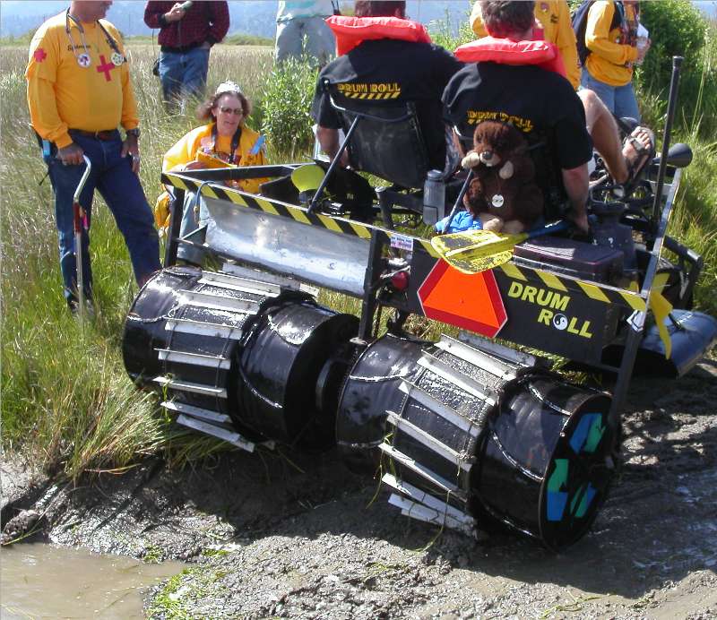

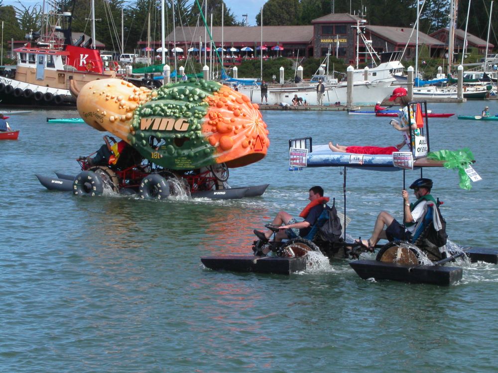

Awesome! To keep ahead of the pack next year you might try one of hitachi's new brushless drills
Quote: Only in England would you see this level of eccentricity, I suspect
We have our own wacky Amphibious races here in norcal
