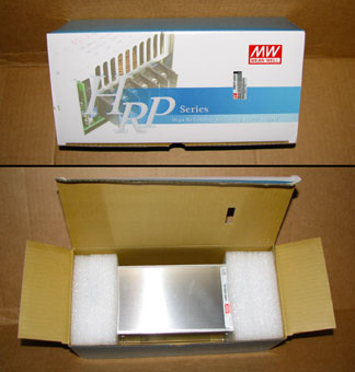

Packaging:
This is the genuine article, the real deal, well-boxed, and externally appears smartly assembled. I did not take the cover off to inspect the circuitry as there was no need (more about that below). Compared to the Meanwell S-350 series, the HRP is the same length, although from there the similarities end. The HRP units are more narrow and more tall ever so slightly. They also weigh about 25% more. AC line power connections are in the front of the unit, and the output and controlling features are in the rear.
Well packaged and without issues.

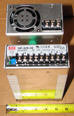

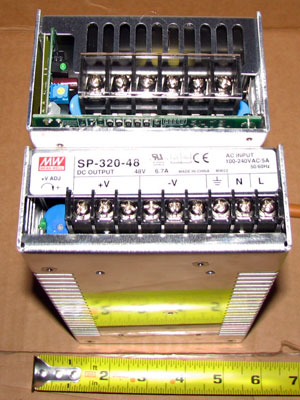

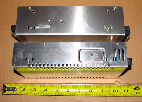

HRP on top, SP unit (same size as the S series) below. The length is the same.
Widths & heights however are not. S and SP units have a fan on the top cover which inhibit stacking.
The HRP unit has the fan at the "front end". The AC connectors are located here as well. The SP unit is below for comparison; all connections are made on one side.

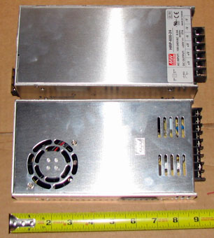

The "rear" view of the HRP unit on top. Note the copious venting. On the left side there's a little green LED and the Voltage Adjustment POT directly below. This is very similar to the SP/S units.
