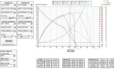

And I remembered finally to try the ebikes.ca simulator for htis motor. I only really played with one estimated configuration for CB2, which appears (when using hte HSR3548 instead, listed there as H3548) to come close to what I actually get using just that rear motor in most situations I tried, so it should be close for the X5304, too.
So here's some comparison charts (which may not properly compare *anything* :lol: ) of the HSR3548 in 20" on teh same controller and battery and bike and conditions as the X5304 in 20".
The first is my typical cruising speed of just under 20MPH, though I don't get to do that for all of my usual riding (stop and go traffic, etc). I get closer on long trips, though, especially if I can pick a route that doesn't have a lot of traffic and also has no stop signs, just traffic lights that I can often time my approaches to so I don't have to stop. Because the mtoros are wound diferently, it means I use a lot less throttle on the present HSR3548 than I would on the X5304.
The next is full throttle on both motors, just to see what their max speeds might be, potentially.
I don't need anything above 20MPH normally, though it's good to have some GTFOOTW speed/power for the rare emergency when going faster is the only way to avoid someone heading for me (when braking would only make things worse and there is no where else to go), so the x5304's estimated 26MPH max sounds fine...I definitely don't need the HSR3548's ~37MPH max. ;)
The next is full throttle on both motors, but instead of 0% grade, I used a 20% grade (not something I'd encounter much around here :lol: ).
I'm not sure how I can simulate things to tell me *how fast* I would get to 20MPH, though, which is what I'd like to guesstimate before actually mounting the thing up on the bike. Presently that's around 3.5-4 seconds, depending on what battery/gross weight/etc I have it setup with. Quicker acceleration would be fun (if not strictly necessary :lol:).

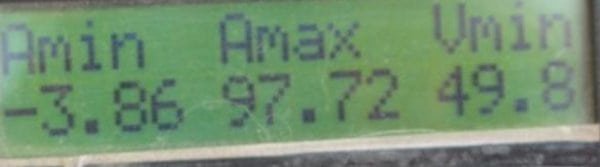

Rather than mess with teh battery more today, I decided to test the x5304 at the highest torque I could manage in a quick test, so I left it in the old worn Manitou Skareb fork that was on the Coil frame, which turned out to be a mistake. :(

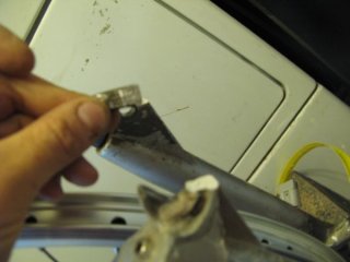

I did the same thing I did before to see what the current pull coudl be on the older crystalyte controller, and held n old roll of paper twoels against hte rim, while I had it at ful throttle--but htis time I leaned hard on the roll, instead of just pushing a little--I was wanting to see if I could stop the wheel.
I had a 12FEt Crystalyte contrller on there, instead of the 6FET. I don't know for sure what it's current limit is, but 40A is a common limit for 12FETs.
However, the max current I got out of it before the failure occured was almost 16A, about 750W (since the NiXX pack dropped from about 53V to 46.7V).
. It didn't cut very far into the paper before it broke the dropouts off and rolled off the fork. :roll:
Well, so, that was that.

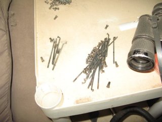

I began unlacing the 20" 9C first, setting aside the spokes and nipples.
I broke one spoke at hte jbend, though, I'm not sure exatly what I did but it just snapped as I was trying to loosen th enipple. There's also four of them that are larger gauge (12) where the others are 13. That's a probelm cuz the 12g nipples won't fit thru the reinforcing rings in the zero rim.
Since I'm not gonna drill them out, I'll do the present testing without those, so the rim will be missing 5 spokes (all on one side, as symmetrically as I can). I probably won't actually use it on Crazybike this way, but I will likely at least test
it on there for accelearation/etc.
Spokes and nipples off the X5304 26" rim:

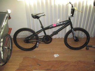

So, I decided to use the BMX frme to test the motor in, since it's veryliklye strong enough to survie the motr...but on the rear droputs instead of the front fork. ;) They'r eat least 3mm thickm aybe 4 or more.

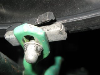

So I bolted the motor in, and tested it with the 12FET crystalyte first, but got no more than about 16A with the paper towel method. So, since the BMX didn't have any brakes, I used the set that came off one of the U forks I'd used on the kennel trailer, and mounted htem so they were already engaged on teh zero rim as tightly as I could get them by hand, and then I used the adjuster on the brakes to tighten htem up enough that I coudn't turn the wheel by hand at all, regardless of force levels I used. I moutned an ebrake handle on the bars, with the cable running up to them, but no elecrrical hookup, so I could apply addiotnal brake force if I needed to.
That got me 17A out of hte controller, and the wheel jsut barely turning...with lots of rubber smell form teh pads.
Gripping the brake handle and squeezing as hard as I could, I snapped the stupid crappy ebrake assembly fof the handlebars. :roll: There was still no more curent out of htat controller, so I'm not sure what it's status is--it's obviously wokring but somehow not pulling as much as it should (or did before).

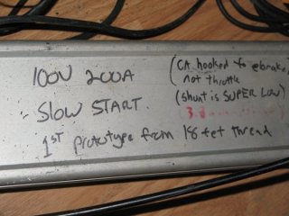

So I swapped it out for the Methods 18FET, which is one of his original prototypes from hte infineon mod thread. it's shunt had originally been soldered over so it would do like 200A; I'd long ago removed the solder but it is sitll capable of at least a third of that or more (dunno for how long, or exactl how much, but I did try a stall on CB2 with it a long time back, before the hosue fire at least a year or two; have to dig up the data).
Anyway, with that controler, and using pliers to hold the brake handle's bar-holder, and a screwdriver then inserted in between the handle's end and hte housing to use as a prybar, I managed to finally pull enough current to stop the wheel, at about 45A or so, just as the NiXX pack reached it's dropdead point around 30V, and it faded out real quick to <20V (in about half a second).
Since I didn't wanna wait hours for tha tpack to recharge, I got hte A123 pack out, which is about 54V and 20Ah. Figure that ought to let me put some current thru this motor. ;)
Redid the test with that, and got a pretty hefty curent pull of 64.1A, at about 50.3V, for 3.2kW of power.
I did several instances of the test, and coudln't get it above that level, nor could I stall the wheel; eventually it ripped the brake padd off one side, leaving the metal holder scraping the rim's paint off. I called it quits at that point and sat down to start writing this up.
Bits of brake pad (and paint off the rim)
brake pads before:
after:
Definitely requires thick dropouts sized exactly to fit it.
Axle slightly twisted in dropout after tests, even with nuts as tight as I could get them, and it's original lockwashers:

EDIT: added this crude drawing to show the adapters in-place:
And this one to show the actual adapters:
The adapter would first be secured to the axle itself, and it's hole would be filed to fit the axle exactly. Then the whole wheel would be put into the droput area, nand the three (more likley two actually used) holes lined up with the dropouts on the bike, and bolted thru those holes inot the dropout itself.
That *should* secure the wheel well enough for testing, yet still be fairly simple to make just by welding flat plates together and drilling the holes, then filing out the axle hole from a pair of smaller holes drill-pressed in next to each other.
With the vertical orientation of the axle, flats to front/rear instead of up/down, it should also make it less worrisome about the bent axle. I hope. :)

I did some pull tests like that in just the yard, and the resutls on the CA didnt' peak higher than before. But now that I had data from the Turnigy meter:
Pack now down to 56.8V, it hit a min voltage of 51.76V, while pullin 58.07A, 3011.5W peak. Just on the X5304.
That's sufficient to push the bike against the front mechanical *and* regen brakes, though only up to about 7MPH. When the front wheel touched looser dirt or grass, it would lock up and the bike would surge faster for a moment.

I was going to test out the controller itself on the tirke too, but I seem to have misplaced part of the internal JST connector harness for the hall wires. :/
