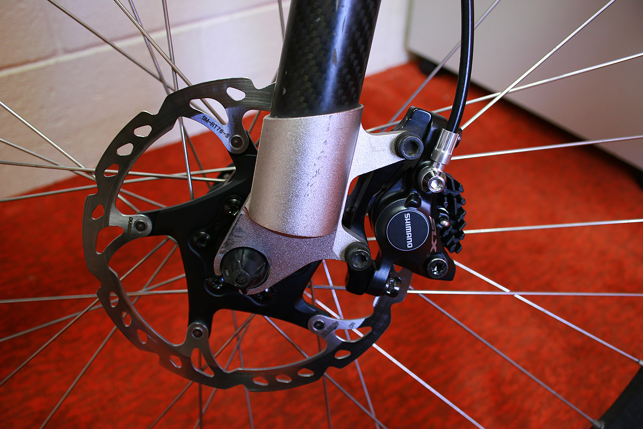

Rear Brake Upgrade
(232.27 KiB) Downloaded 11 times
(178.03 KiB) Downloaded 11 times
(181.3 KiB) Downloaded 11 times
byebyepetrol
Posts: 228
Joined: Dec 11, 2013 4:19 am
Location: Tasmania
Re: Bafang BBS01 350w vs Dillenger 250w front hub
Post by byebyepetrol » Mar 10, 2016 10:16 pm
Brake upgrade from SRAM to Shimano SLX = no more brake rub.
The SLX calipers seem to have a little more tolerance/ clearance. Being new they also
don't squeal or shudder.
