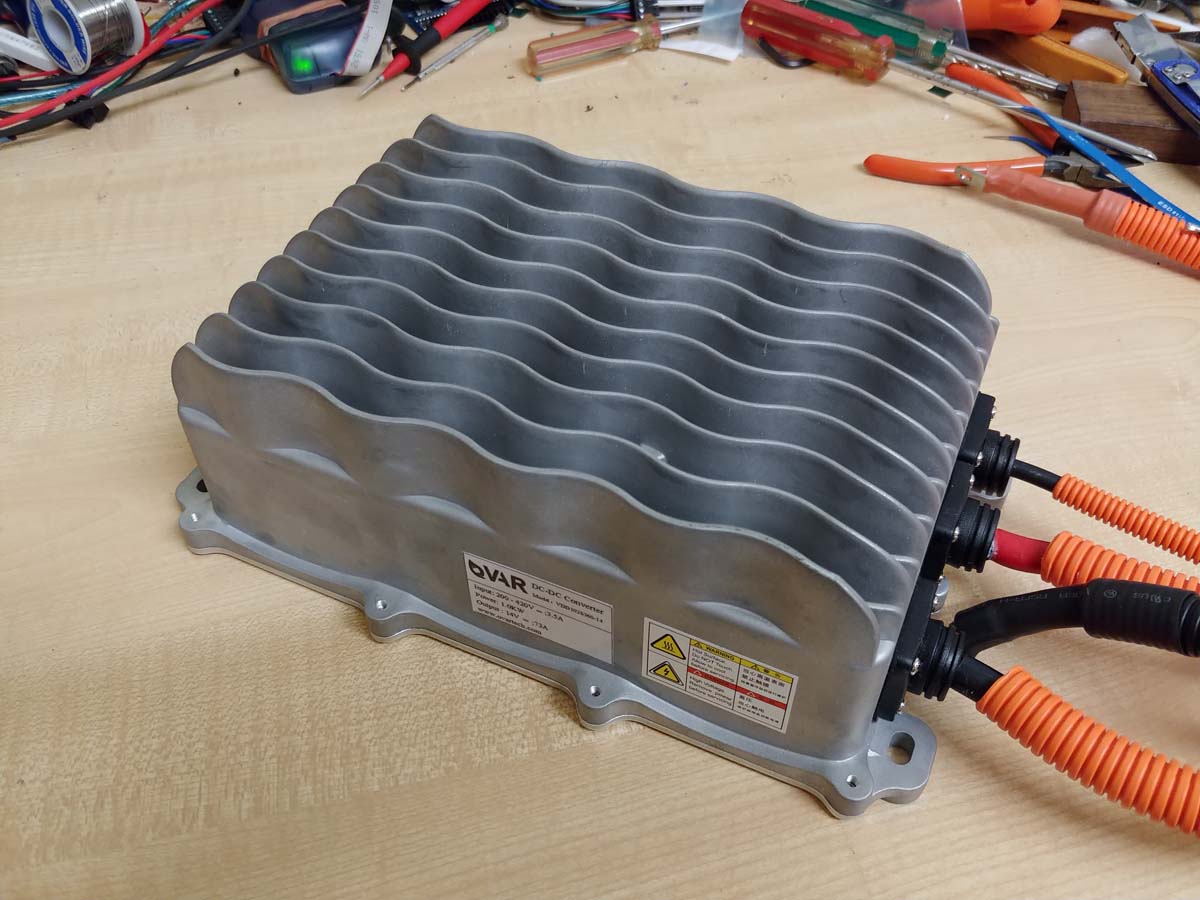

A quick update - look what turned up today:
Build quality seems good. I will put it through its paces over the coming weeks and report back.
Yes, about 5 months total - make of that what you will! In truth, I had given up on it after a few months. The most charitable explanation would be that the product was actually still in development, maybe took longer to finalise than they expected, and they had started drumming up presales well in advance.
It's certainly too long a lead time to be viable for most EV businesses / resellers / end users, but perhaps the situation will improve. In my experience there aren't a lot of good DC/DC converters on the market in this sort of size so it *could* be a useful product..
