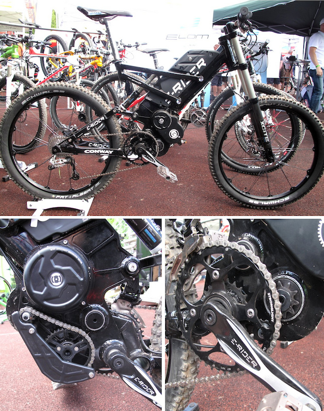

Postby courcheval » Thu Dec 27, 2012 10:14 pm
Conway e rider
Tench s prototype Number 2 : http://www.electricbike.com/specialized-super-charged/
