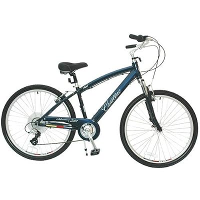

Think your bike just got discontinued xyster. Don't see it for sale anymore. Seems like its hard to find a full suspension comfort bike. Maybe Cadilliac will make it better the next round.
D-Man
Posts: 1564
Joined: Tue Nov 28, 2006 8:43 pm
Postby xyster » Tue Oct 23, 2007 10:39 pm
D-Man wrote:Think your bike just got discontinued xyster. Don't see it for sale anymore. Seems like its hard to find a full suspension comfort bike. Maybe Cadilliac will make it better the next round.
Yah, looks like they cheapened the replacement model while keeping the price about the same. Gone is the rear soft tail and -- on the one advertised at Amazon, but not the one below -- also gone are the disk brakes.
http://www.cadillacbikestore.com/comfort-bikes.htm
The (I guess) replacement model at amazon:
Last year's better model that I have is still advertised here:
http://www.cadillacbicycles.com/adventure_avp21.html
The lady's 06 is still available at Amazon, but the men's version is not. It looks easier to pack batteries midframe on the lady's version. Hmmm....:)
