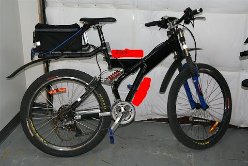

I built up an ebike using the amped bikes rear geared motor. I recently relocated the battery to mount in the frame. Here are some early pics:
Here is the battery in the frame:

Thanks!! This is my first ebike. The only other ebike I have ridden was a bionx so I can not compare the power of the amped dd hub. With my 36v ping I can cruise at about 20mph on the flats without pedaling and of course faster if I pedal. I have not done extensive testing of range but I always pedal and have gone 20 miles with hills and still had power. I think I am already wanting a 48v. :p

I like it a lot, especially the battery in the frame. :D It was impossible to do on mine. :cry:

Thanks!! I like it a lot, especially the battery in the frame. :D It was impossible to do on mine. :cry:

This bike is night and day compared to the first build on the donated pacific. In general I think full suspension is the way to go as it really helps soak up the bumps and at 20mph+ you really feel the bumps on a hardtail!!

I want 48w but I barely fit the 36v in the frame. How does the 11 tooth work? Do you just swap out the smallest gear?
nice bike and a clean build
i really like that frame triangle i could fit alot oh lipo in there
