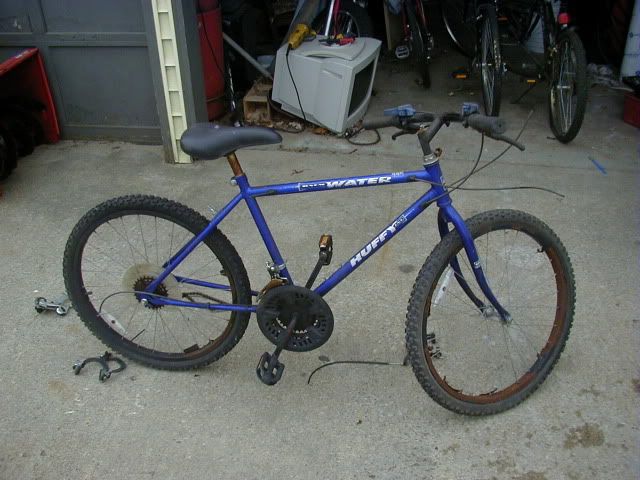

I've finally done something with the old huffy mtb that's been hanging from a roof truss in the shed for a couple of years. It's taken so long because I haven't been able to decide how to mount a battery pack to it, and I've been concentrating on the road going bikes. After taking it out for a bush bash and getting all muddy I wish I had done this earlier, I had the biggest ebike grin yet, and that was even before I got to the good stuff! Took me right back to my bmx racing days.
I know it looks a bit wierd, but that was the easiest way I could think of putting a battery box on it solidly. In the end though I'm pretty happy with it and the weight is evenly positioned with the battery sitting in the lower 2/3 of the box. The toolbox ($11 at Bunnings) contains a 48v10a headway pack and temporarily a 15 fet 35a controller running at 60a without its case, ie the fet mounting bar attached to front of toolbox using it as a heatsink, with a 72v 45a 12 fet Lyen edition on it's way to replace it programmed at 48v 70a. Hub motor is a sanny kung/GM higher-torque-version HBS48 1000w, it only maxes out at about 38kmh on 26" tyre but has plenty more grunt down at low rpm than their normally wound motors, which is ideal for how I will ride this bike. Spinning the rear wheel out of a muddy creek and doing donuts on a cheap ebike, who would'a thought? Rear shock is from my now returned-to-original and sold longtail, compression/rebound adjustable and new angle makes for a plush ride compared to before. The forks are absolute crap though and gotta go asap, deciding whether to weld on an 1 1/8 headtube or get some semi decent 1" screwtop forks. Seatpost is about 2" further back now.
Dirt-e-biking is now my favorite thing. A really great thing is the noiselessness, there's been a lot of complaints about ice dirtbikes in the areas I've been riding. No one even knew I was there.

I started with a 24" mnt. bike frame. I need to streach it a bit to get the riders center of mass more between the axels
this photo is taken after I have cut all the rusted cables & parts off
it's ok to mod the frame as it has a "Life time" warranty :twisted:

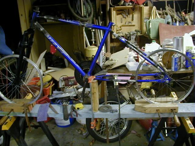

next we Jig it up & measure the caster angle. hmmnn kinda slack at 28 deg. I will steepen it to 26ish & see where the trail come out at.

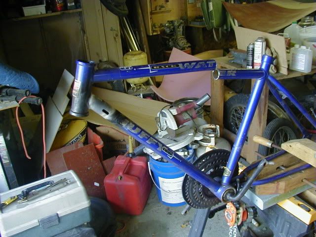

I chop the top tube so the frame will give a little, theres a come-along & a tommy bar to keep things straight heat the lower tube & crank to desired geometry.
Next we streach the rear triangle 4-1/2" to get the wheelbase out to 49"

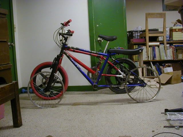

along side my first build for compairison.
I still need to add some bracing & gussets.
& yes there is pedal clearance. I will put a tiny crank set in there to gain a little but this "bike" will only have pedals to make it a bike. I may put a detent to hold the pedals horizontal & add foot pegs back for head foward rider position.
