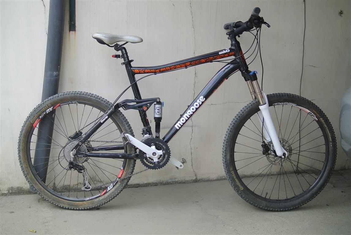

Postby geoff57 » Mon Jul 16, 2007 3:20 am
Hi all
here is a picture of my latest project before conversion. it has one of the worst riding positions for a pedel cycle I have ever seen, but as an E-bike for pure motor power with pedels just to keep the law at bay, it will be perfect.The rear wheel is 4.25 " wide and was screaming for a hub motor, so I've given it one a PUMA with a single cross.
The bike should be ready riding within a week.
Thats all for now
Geoff
now charged with with 50% eco friendly ( wind, hydro electric) electricity.thanks to e-on
geoff57
Posts: 822
Joined: Wed Apr 25, 2007 5:32 pm
Location: England

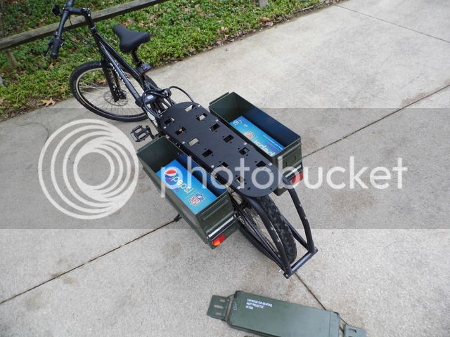

Postby ChopperMan » Fri Aug 24, 2007 1:40 am
Hi All,
I have been lurking for the last week and thought this was the ideal place for my first post. The photos below show the before and after of my first build completed about two months ago. It's based on a geared 250W chinese scooter motor and 24V 18ah Gel Batteries.
I hacked the frame in half with an angle grinder and welded in a subframe to support the new drive train and give it a very comfortable stance.
Top speed is currently geared for about 14mph and I get 12 miles range so far. I haven't pushed it to it's limits yet as there are some long steep hills around my home no matter which direction I go!
It wasn't until I was finished that I realised it might not be road legal in the UK, no pedals, but as my legs don't work properly (I haven't used a push bike in ten years) it didn't even occur to me to keep the pedals.
I have since been stopped by the 'plod' but only to ask how I made it!
:D
I hope it gives all you hub motor demons a good laugh..... but it did only cost £200 to build. Next project will be using a Puma!!!
Many thanks.

Postby fechter » Fri Aug 24, 2007 9:04 am
I love the before pic. :D
As long as the welds are strong, you can always 'beautify" them later.
Too bad about the pedal requirement. It might be possible to add some. They don't have to be optimal, since they're only for looks.
In fact, if it appeared like you were pedaling, I bet they would never notice if they weren't connected to anything.
