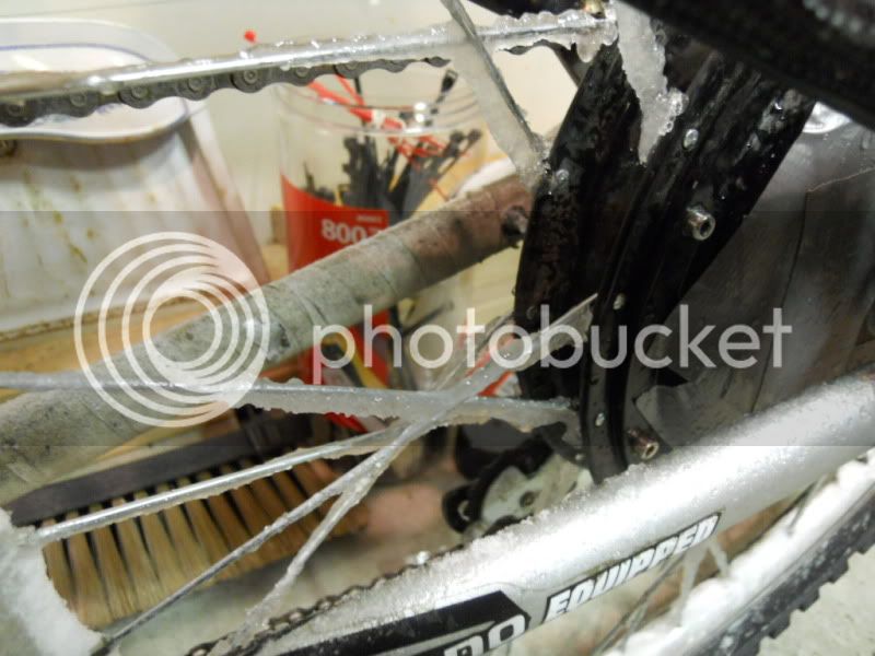

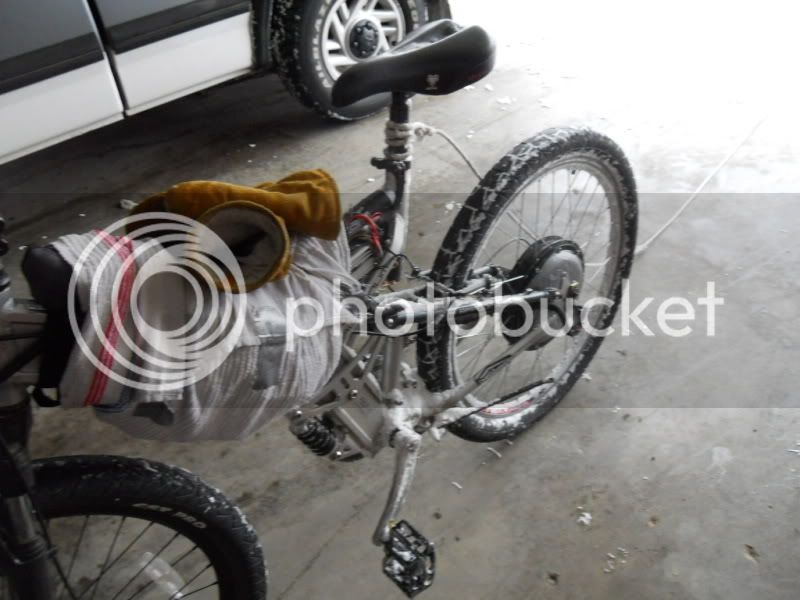

I went on another ride in the snow, without a sled, with a better rear tire. It was VERY fun. :D I rode on the river but it wasn't completely frozen over yet so I didn't ride too long there. I went trough a couple fields hittin' the drifts like a champ! The snow is supposed to be 8" deep but I would estimate 4-6" deep.
I still had motor overheating problems though.. Slow speeds are tough on a 26" motor! This tells me 67v on a 9c needs cooling holes to work properly. I will have it at 44v for next ride that should solve the problem.
My duct tape has kept my halls safe so far, hopefully it continues to do so!

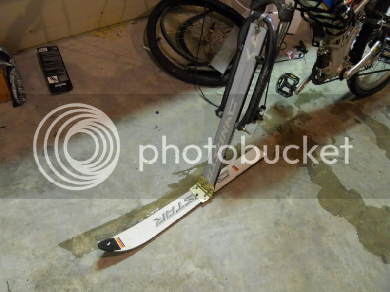

Awesome vid, looks like you are having fun! We put a ski on the front of our electric bikes here and rode it around. Good times.
A ski sounds SO AWESOME!! Do you have any pictures of your ski? I might run in to goodwill today and look for a set. :D :twisted:

OMG! :D :twisted: :D OMG! :D :twisted: :D I AM SO HAPPY RIGHT NOW! :D :D :D :twisted: :twisted: :D :D
I went to a local goodwill, got a set of skis and poles for $5, and used a door hinge as a pivot on the bottom ski. Best friggin $5 I've ever spent! :D It sucks on ice/hard packed snow but with powder it is god!!! :D Twice as good as my front tire on snow!! :D This is so much fun to ride!!! :D Everyone has to try it before they die!! :D

On our bikes we just put some wood blocks on the ski, and strap the ski to the front tire. Your method looks pretty secure too.
