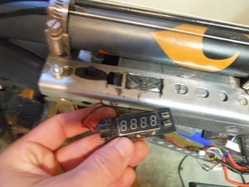

Postby neptronix » Thu Jun 02, 2011 7:26 pm
Oh, haha, that's good.
I've done that before while putting a multimeter up to my battery in the field to check it, luckily the multimeter leads and battery connector vaporized, not anything else! There was a guy nearby that had a screwdriver and some MAF cleaner, used that to clean the contacts and got back on my way. My hands were black for a while though :lol:
You should probably go to andersons or 4mm bullets for the charge lead though so it doesn't happen again. You got lucky!
Also if you are charging over 10 amps, you may want to get a thicker charge cable too, like 12-14 gauge.
Pardon me if you already know this stuff :D

Postby Metallover » Thu Jun 02, 2011 7:56 pm
Ha! I've had a similar experience! :lol:
I think the picture of my wires may be a little deceiving.. The plugs are 4mm bullets and the wire is either 12ga or 14ga speaker wire. The cable is about 4ft long and just gets a little warm during full power charging,, just enough to notice the warmth. It's not ideal but it's better than dropping $10 on nearly 4m of 12ga hobbyking wire.. :)

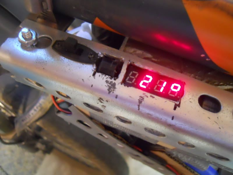

Postby Metallover » Thu Jun 09, 2011 5:12 pm
Yeah SD is flat! Great for farming,, and wind. :|
I did some switching and moving in preparation for the plastic to house the batteries.
It's MUCH cleaner now. I'll have to keep an eye on controller temps for awhile to make sure the lack of airflow won't ruin it... but I'm confident it wont if I don't push it that hard.
My ac/dc converter (which powers fans in my motor) let out some smoke the other day when I unplugged my pack. I'm not exactly sure why it let go, but I am going to install my pre-charge resistors before I replace the converter.
As of now I have ridden 288.54 miles. On one stretch of only 4 days I rode 108 miles. It's supposed to rain 6 out of the next 7 days so it won't get much use then, but that also means I will have time to work on it if needed. :)

Postby torker » Thu Jun 09, 2011 5:32 pm
I would worry about burying that controller. It would be good if it could be at the top rear of the triangle and cover everything but it. Maybe a temp sensor for it? It has been over 100 deg. here for 6 days straight. :roll: Probably not usual for you though. Actually it is too early for it here. Broke records set in 1933 I think. Normally doesn't hit 100 till July. We really need a pigtail on these controllers for temp. I wish we had some of your rain :mrgreen: Are you anywhere near Sisseton/Aberdeen? The landscape looks very similar.

Postby Metallover » Thu Jun 09, 2011 6:12 pm
I am 160 miles straight south of Sisseton, about 10 miles out of Sioux Falls. Everything on the east side of South Dakota looks exactly the same, lol. You need to go to the west side of the Missouri to find any deviation!
Weather here as of late has been really hot!, but not quite as hot as you! We have has low-mid 90's the past few days, but yesterday was cold and now today it's 55 with thunderstorms. :cry: We usually hit 100 degrees up here a few times a summer but it's not too common, thank god. :)
When I was planning out where to put the controller I overlooked the top part because of another piece I had holding the batteries on earlier... I think now I'll change it! It'll give me more suspension travel breathing room and maybe a little more crotch room! Thanks for pointing that out! :)

I've installed my VT monitor in one of the upper battery pieces. I've also put in switches for that and the ignition on the controller up there. Very convenient. :D
And I've had some time to take out the flashlight.
