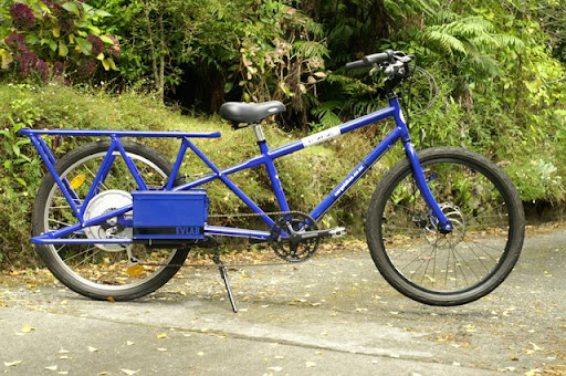

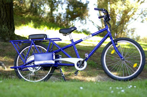

Here are some photos of the Yuba Mundo cargos I have built over the last few years.
2 72v15ah beasts at 40amps with disk brake upgrades crystalyte x5305 motors.
72v20ah 100km range, x5304 regen, disk, 52 tooth front chain ring, temp monitor...wahoooo, this bike is awesome.
48v10ah nine continent front
2 x 36v15ah 25amp controller nine continent front. Really nice set up. 36km/h cruise 40km range.
They make such great electric bikes. SO useful.
Really looking forward to getting some of the new frames.
I have designed the battery cases and torque arms specifically for the bike. Yell out if you want some.
I have always thought that they would be great e-bikes, but couldn't see a good way to use a hub motor on it because of the 14mm dropouts.

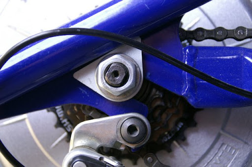

How did you do it?
There is a thread on it here. http://lh3.ggpht.com/_xtfwwaIXUcM/SrmQ6kx3EiI/AAAAAAAADH8/NZVl5ZvlC00/PICT0376.jpg
Basically the axel is 90deg to the flats, so the 14mm axel fills up the space. Then I use custom torque plates to transfer the load to the frame.
The picture show the first ones I made, but then I changed to longer arms, worked perfect.
The distance between flats should be 10.1 not 11 as shown in the drawing. Once zinc plated they are a snug fit.
Showing original reaction plate.
Showing new plate design (note should be 10.1 not 11.1 across flats.)
Sorry dont have picture of new plates they have gone with the bikes.
I can supply a DXF file for you to take to a laser cutter or CNC mill person, or can make and send you some reaction plates in the post.

these are just great! I'm way envious.
I've been pondering the ammo box battery concept for an xtracycle build i have going - and this has me completely convinced.
Are you happy with the balance of things where they are? And why did you go to the trouble to stick batteries in the triangle if in fact you liked the rear balance.
the xtracycle will be less rigid than your bikes. the guy before me just put them in milk crates on top of the rear up behind the seat.
Joe
Sorry, never experienced riding a big dummy so cant say.
With 2 big batteries on each side they are heavy bikes. With one battery in the frame its much better handling and you can get better use out of the carrier area. I am building one at the moment which will have the batteries under the running boards, so you wont see them and they will be down low. It will have a rear NC 8x8 or 9x7 @ 72v 30A.
If it helps you at all, in my various experiments with placement on CrazyBike2, the one that really improved handling the most was to put them in the frame as close to a line between the axles as possible, where they are now. It was actually a bit better when I had the powerchair motor mounted just below them, as that weight was below the axle where the batteries are mostly above.
When they're out to the side, then it doesn't seem to make too much difference whether they are above or below the axle line, as their outboard placement has more effect. I tried them in the cargo pods, forward and rearward, well-forward of the pods and as far inboard as they'd go under the seat along the lower pod rails, etc.
The closer they are to the center of CB2, the better, in every axis, so far.
BTW, when I have the cargo pods taken off, it rides even better. ;)
