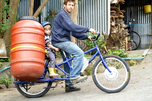

Postby Kiwi » Mon Nov 07, 2011 5:01 am
Our main Yuba, me and son taking a 200l barrel full of bird netting to neighboring farm. Had to counter balance about 10 deg.
