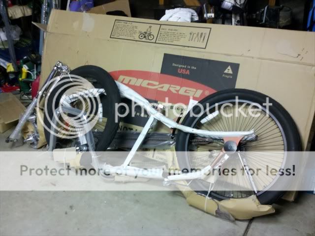

Postby joystix2 » Tue May 24, 2011 5:23 pm
Purchased from online Store - $380 shipped.
Here are a couple of Pics before and will update as I go along with build.

Components for my Build. Cute-12 1000wt Rear hub Motor, Crystalyte CT4825, (2)14s5.8ah Lipos.

I ordered the chopper style tri forks instead of the suspension cruiser forks because they had the front disk brake option
OMG when I ordered the rear CUTE-12 motor I didnt even consider the rear drop out space of the cruiser. Its only a little larger than 4.25" wide. It will not fit! Not even close. So a rear hub motor is not an option!
So I ordered a front Cute-12 motor and had to remove my front disk brake since the front motor does not come with the disk adaptor.

Finally got to work on the Beachcruiser some more. The hard part was trying to figure out how and what I was going to use to cover the frame. I decided on some Hard Plywood panels and Hard Pine for the mounts. I sanded the paint off of the area where I was going to install the mounts and used 30 minute Epoxy to mount.
After the mounts were in place I attached one of the side panels using self tapping screws. The other side I wanted to make it so it could be removed easily so I decided to drill larger holes in the mount and epoxied some R/C car body mounting posts I found from my local hobby store.
I covered the Panels with some Carbon Fiber Vinyl purchased from EBAY. The vinyl was easy to install and I think they look pretty good. Next comes the electronics install which my younger brother who I think is an electrical Guru is going to help me out with.

Yah this guy maytag wired it all out after about 3 gin and tonics. We finally got the phase wires working on the last combination of trying them all out.

Installed the rear fender tonight but cannot install front fender due to having to add reverse caliper brake on front to help with the coaster brakes. Will have pics tomorrow of the completed bike with the rear fender on. Below is a Pic of the first install of the caliper brake mounted on the backside of the front wheel. Have updated it to Tektro Long Reach and Kool Stop pads for better braking.
Had to take Pic of the brother figuring out the wiring with his Gin and Tonic and my Johnny Walker Gold Label in the background. Its the only way to work in a cold garage.
All Electronics in Place. Crystalyte CT4825 controller. (6s in Series with 8s 5800mah Turnigy Packs) in parallel with another set for 51.8V 11600mah pack
