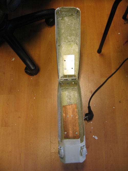

Then i started designing new battery box that i could insulate from cold and weather, but also take off the bike when neccessery without too much hassle.
Voila, batterypack V2 was a go:

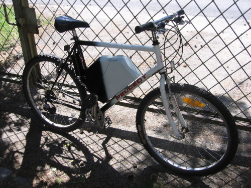

After it was halfway done, a friend showd up who had some bike lying around waiting to be thrown out but offered it to me. And well, it was much lighter and only needed little paintjob and crankset, also rear cassette was dead but i didnt need it anyway.
The new bike had much bigger frame that actually made my "removable" option a lot easier to solve.
bottom slides to a plate i've put into drinking cup holder and rear piece goes around seat tube, behind there i'll put a lock on it.

Added some metal bracing to the fiberglass box, the ride is really pumpy so I want to make it a little more sturdy.
Now i must figure out what will i use to insulate the batteries, then there's connections to be made..

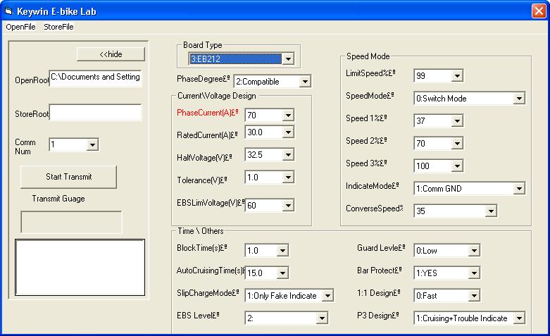

Installed motor on my new bike and tested out the Lyen controller but it makes disturbingly loud noise and doesnt spin up to speed that the old controller does.
There must be some configuration mixup, like hall sensors pulsing the phases wrong or something.. sent Lyen an email but not sure how busy he is, maybe someone here knows those settings and stuff and can also help with it?
it's a 12 x 4110 MOSFET Extreme Modder Controller LYEN Edition controller, and i'm using the e-bikekit.com read DD motor, the first controller on the video is also from that kit, e-bikekit.com 20 amp thingy.
.video removed.
here's the screenshot from settings i'm on atm:
different phasedegree? Halp
It seems on Lyen controllers 2 colors on the phase wires have to be swapped. Not sure of the colors but a search here should bring it up. Second version of the bike looks good. Welcome to ES

Phase wires were off before connecting and i noticed it, blue green red didnt match i had to switch side ones, then i ran this test and thought about well, maybe original setup was correct just wrong colors.
tried how they were initially but that mixed it up even worse and motor didnt move at all.
Should i try third alignment? and .. what should it be then.. :D
on the video they run: yellow green blue
non moving was: blue green yellow
Sorry I never programmed one. I run Ebikekit controllers with a modded shunt. I just added wire to the shunt to up the amps and I run 60v through them. Poor mans setup :oops: Someone who knows programming will help soon I hope.

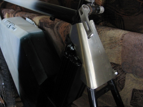

Thanks, "the bent metal piece" got my attention next, it is shielding relay and battery connections and hosts keyswitches for main power, controller and precharge :)
still much to do with them wires, must shorten many that run to the handlebar and see how I can hide the rest of them after getting mudguards installed.

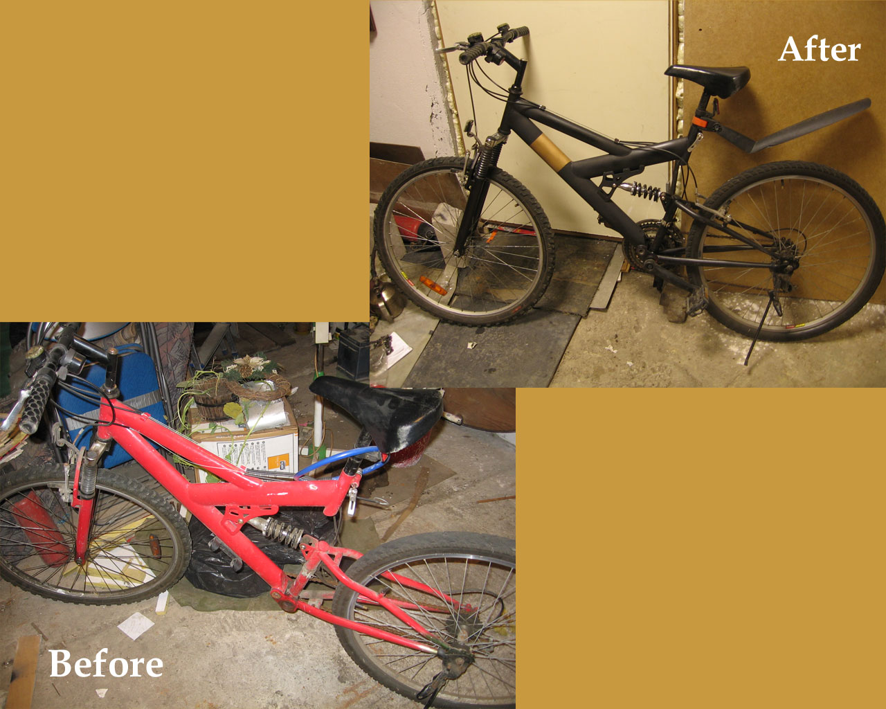

so.. I went and looked up my old FS frame.. of the "coca-cola" bike.. and decided i'm going to modify it :)
going to weld new pipes to the red zones, bring the suspension connection little lower and cut out everything in the green area, for battery space.
The pipes over rear suspension are going to go like this ( )
what do you think? ;)
