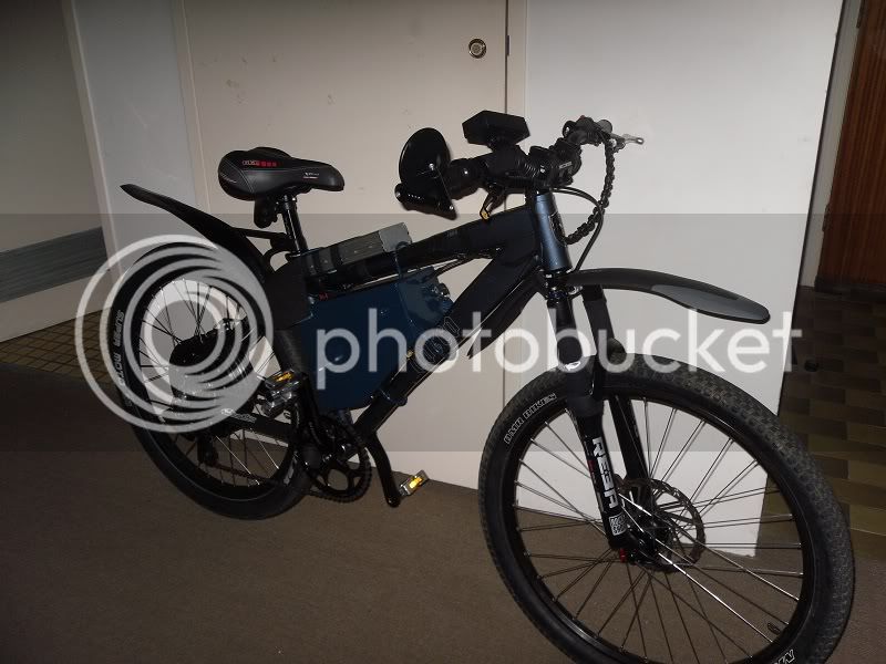

Well it took me just over a year, but i finally have a working ebike.
I decided to start from scratch so i could learn all i needed to about bike parts and servicing at the same time.

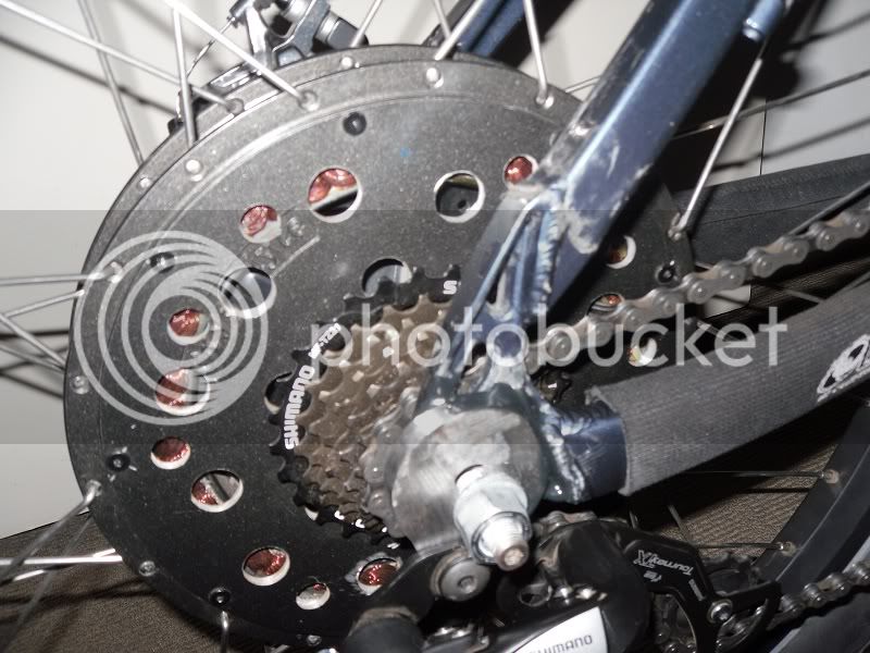

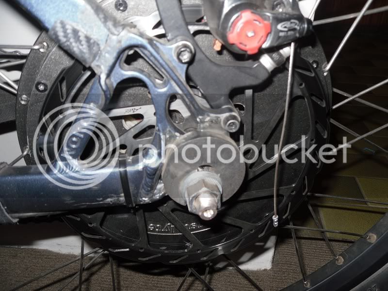

(Hub motor now has much bigger cooling holes)

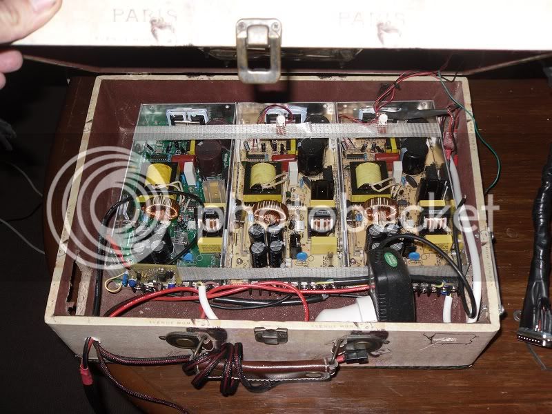

Charger V1
Charger v2, nearly finished

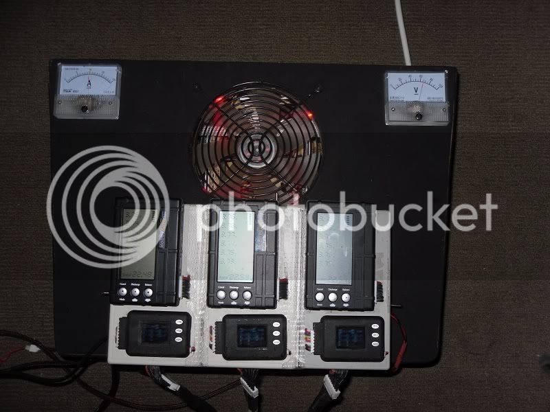

Battery medics have been boosted by adding resistors and are fan cooled. The fans can either be powered by the 22v packs, or via a 12v supply in the charger box. The cell-logs are for HVC. (thanks to Gary Goodrum, fletcher and all those who contributed to the meanwell posts)

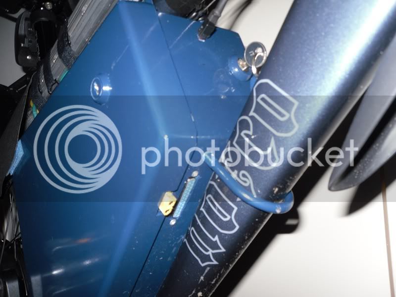

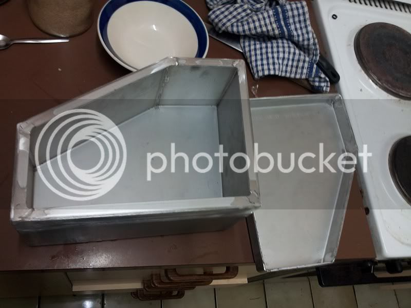

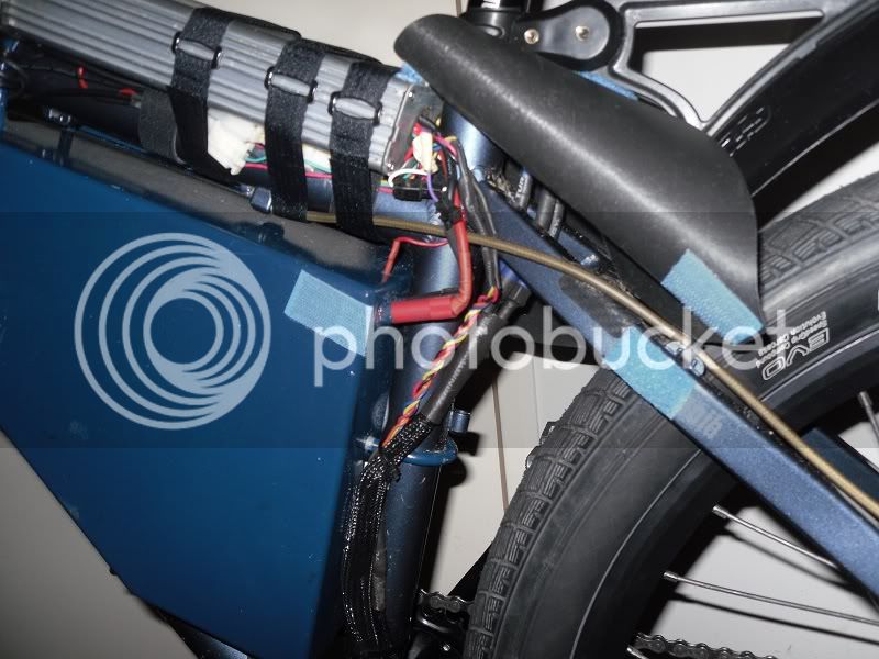

battery box on arrive from a mate who built it for me.
battery box power etc hidden by green shopping bag plastic and velcro. hahah (gotta fix that up a little)
Charge and balance...

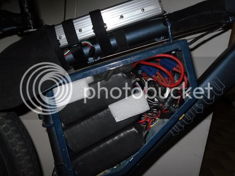

Inside the box.... needs a bit of a tidy up also.
Batteries were getting far to hot in the box so i installed a window

So its a hs3540 on a lyen 18fet running off 18s2p of zippy's. Not loving the motor. Its great if you want to ride at 60km/h everywhere and never have to start stop. I'm currently at 45/110 amps which is about the best middle ground i can find and gets me to about 65km/h. 50+ amps just heated far to fast around here especially on the 28c humid days we have been having lately.
If i lower the amps much more it also seems to heat faster. Took me a while to wrap my head around that but i guess cause it spending longer on the hills and longer to accelerate it spends more time in inefficient rpms.
I think the HT version would have been far more suited to my riding. If im not to late hopefully i will be in on the 5404 buy which should keep me more than happy off road.

You did a nice job. I like the components you chose too. Your battery box turned out nice. Nice clean build.
I agree about the HT motors being better for most of us. I had a heck of a time deciding on which one to get. But after comparing them side by side with Justin's simulator it became clear to me that at voltages 18s and up the HT would serve my purpose better. At 22s in a 24" wheel mine will go 39 mph and gets there fast.

I gotta ask mate how are you using the cell logs as hvcs? do they have an allarm for high V or something?
And as to beefing up the BM's, I'd love to know how you did it! im switching to bulk charging soon for most charges be great to have some super powered bms for balancing too!

I have one of Gary Gooddrums charge control boards for the meanwells which has a hvc function.
Gary helped me with the circuit on the cell log section here...
viewtopic.php?f=14&t=29458
Fletcher helped a little with the fans for the medics part of the circuit here...
viewtopic.php?f=2&t=278&p=452475#p452475
As for how I did it, Niel P, Bigmoose, Arlo1 and the rest of the thread contributes helped here...
viewtopic.php?f=14&t=27821&p=424555&hilit=icekreme1002#p424555
Few pics of what I did there too. Let me know if you wanna know more :-)
And YES i am worried about water. Im waiting on another db-25 plug so i can make a protector and will do the xt-60 plug at the same time.
Yeah i saw Hyena in it, which aided my desicion when i saw it on ebay.. hahaha.
Unfortunately 2 of the plastic bits that hold the straps have already broken on mine, so will have to see about replacing them with something better.
Edit: I should also add, have no idea how reliable the medics are going to be now... I made them easily replaceable so no biggy if something goes wrong. Already lost 1 when i had the fan circuit wrong :-(
So far to test, i ran em through 10ah packs from 4.2v down to 3.7v 4 times each and have used them to balance my pack a few times since that. As bigmoose explains there is a limit, somewhere..... hahaha

hey tom I meant to ask do you see much difference with heat after drilling the holes?

Hey Mike, yes you can fit it under a jacket, well I can just. So hot right now not sure how im going to wear it when I fix mine. Maybe as a shirt? lol
Cooling holes....
I majorly screwed mine up when I enlarged them. Got one well off center and scrwed the whole symmetry so struggled to get it back by drilling more small holes instead of larger.
I have 16mm holes on the inside on one side,
and 16mm on the inside and 12mm and 18mm holes on the outside on the other side. Almost to embarrassed to photograph it but yes it definitely did help with temperature. I'm not so sure it actually lowers temp, but rather helps it cool down faster when you ease off to cruise mode after a big hill etc. This hs3540 is a real heater for me. 3500w is about as far as i can get it unless i just plain don't want to enjoy it. at 3500w im still seeing 100c in the wingdings and getting the varnish smell so may back it off just a little more. Gonna try a 24" 1st though.
But... I dont actually have a temp monitor like some. Ive been pulling over after long rides, cross county stints, and 3500w hill climbs to check temps with a hobbyking temp gun so not sure if it is getting higher. But ive been doing my best to check when ive been giving it its worst.

Ran the tests stock vs mod medics again here are the results....
To start I balanced all the packs together on 1 medic to 4.06 4.06 4.06 4.05 4.05 4.05
Also results are taken from the same medic so they are more comparable.
Each pack was 6s2p of 6s zippy 5000mah cells.
After 1 hour 40mins
Stock 4.00 4.01 4.00 3.99 4.00 3.99
Mod 3.96 3.97 3.96 3.95 3.95 3.95
Another 1 hour 40mins
Stock 3.96 3.97 3.96 3.95 3.95 3.95
Mod 3.89 3.90 3.89 3.88 3.88 3.87
The mods with the fans still stay much cooler than the stock so I may even try push em a bit further in future.

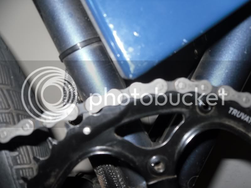

I need help! I'm having a hell of a time keeping my chain on anytime i leave the road, and due to the battery box have very little room for any kind of guide or bash guard.
I'm currently using 48t-11t and this is about perfect for this motor. But most chain tensioners only support up to about 40t. I could maybe get away with slightly smaller chain ring, but i really love the 48t.
As you can see, room is tight! And no room to attach anything to the seat post either...
In other news I think i did the nuts to tight when 1st installed docs torque arms and pushed away all the dp-420. The drive side arm fell straight off when i removed the wheel to change tire yesterday. I redid it with way more glue this time and even if it comes loose its installed so it wont really matter unless the nut loosens too. But the nords should take care of that.
Some more photos,
That should keep them on there :)
Charger finally finished. Love it!
