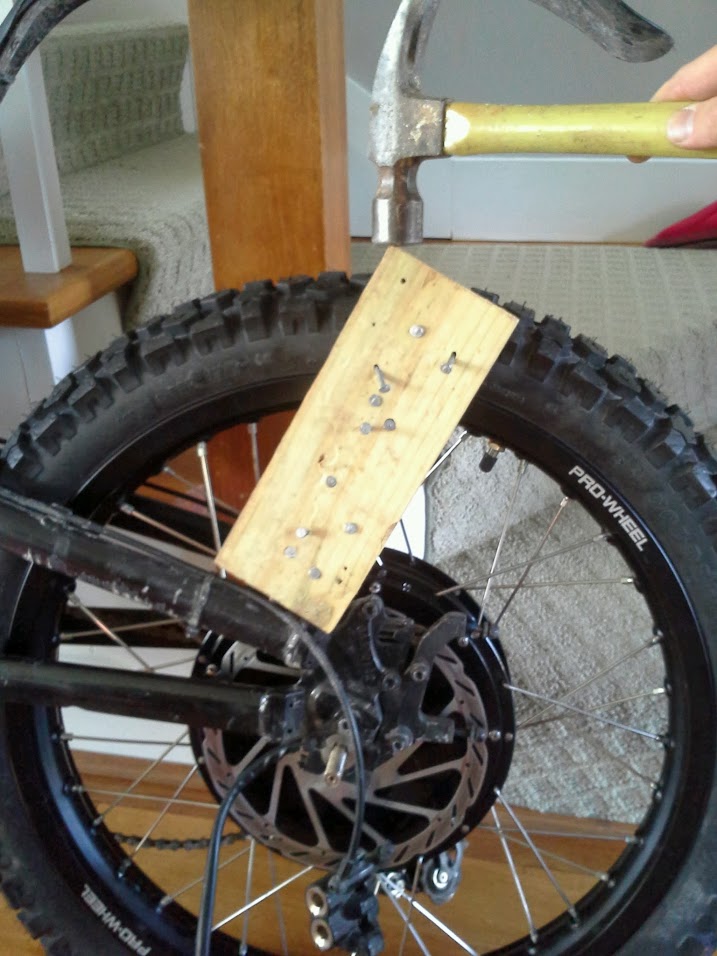

I am unable to use the pinch bolt on the disk side because of how the wires come out of the cromotor and they have to go through the drop out part were the bolt normally goes. What do you think about using regen with only the chain side with a pinch bolt?
I did have to grind down the inside of the drop out a little bit but the disk side is very tight and I have to lightly hammer the axle to get it all the way down in the drop out.

Scott wrote:I am unable to use the pinch bolt on the disk side because of how the wires come out of the cromotor and they have to go through the drop out part were the bolt normally goes. What do you think about using regen with only the chain side with a pinch bolt?
if the axle's as tight in the dropout as you suggest, there's probably no problem, IMO. bummer tho. start easy. i was able to tell when my axle rocked/ w/ regen on my GT (not this adapter). might be worth finding an alternative to that bolt tho. some kind of clamp mod that does the same thing. and i'm not sure how much power you got, cause looks like the warranty's up at 15kw. :lol:
Kiwi wrote:I did my best but hold no responsibility if you tear your bike and your self apart putting 15kw into a CroMotor or something silly like that.
Scott wrote:I did have to grind down the inside of the drop out a little bit but the disk side is very tight and I have to lightly hammer the axle to get it all the way down in the drop out.
the axle has to go straight thru, so if the dropouts are perfectly aligned, they'll pinch in spots. i used a long flat file, filing both dropouts at the same time.
i've done the hammer thing too w/ new axle (when bike's upside down), but figured out a better way once you get the axle halfway in the slot - flip the bike over and use a block/hammer on part of the frame directly above the dropout. (disregard nails, was scrap board kids were playing with, none went through):
