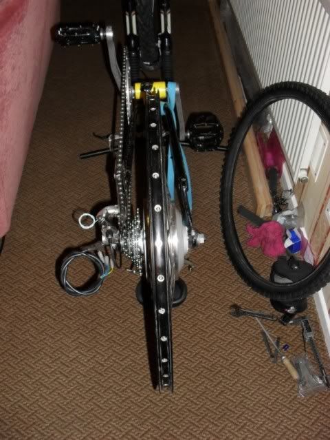

While waiting for the spokes i decided to fit the hub to the bike and see how it fits.
The drop outs on the rear frame were very shallow in depth, so i had to file them deeper for safety.
The flats on the spindle are now firmly located within the slot. I could have filed it deeper but i already planned to have torque straps.

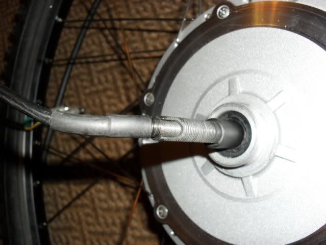

The supplied torque washers were a nice fit and substantially stronger than the flat pressed steel washer normally supplied with the smaller 250W bafangs. Being 4 mm thick as well, I can make good use of these.
I wasn't looking forward to filing out a perfect slot in my torque arms. This seemed like the easiest and strongest option. Drill a 23mm hole in some flat steel and weld the torque washer in the correct position.
I wasn't sure if chinese metal was going to weld ok but i need not have worried.

I added a welded captive nut to the inside of the frame.
Torque arms completed.

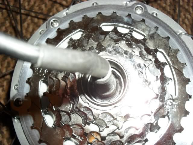

I have made a bit more progress. The 7 speed freewheel turned up earlier this week, so i fitted it to the hub for a trial fit. The thread was nice and clear and it slid on no problems, but, do you think i could get the thing off again?? no way.
I had to buy a freewheel removing tool. Not a bad idea to have one in my toolbox anyway. While waiting for that to arrive i realised the freewheel extends way past where my frame sat against the spindle. Adding some temporary spacers solved that issue.
An improvement i want to make with regards the freewheel frame clearance issue is a spacer that can take the load of the bike insead of relying on the threaded part of the spindle, this of course has a hole drilled down the middle and leaves the whole assembly incredibly weak.
Now i discover the rim is no longer central to the frame. It needed moving about 4-5mm. I had to dish the wheel, which was a shame because i had it running nice and true. Oh well, it gets easier each time i do this.

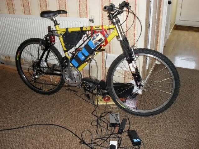

Time to update my build thread. The bike is 'on the road', not finished (are they ever?) but it's in a usable state.
So let me back track.
I was thinking about building a pack out of headway cells, but this ping battery was for sale in the classified section. Not a bad price and it saved me shipping, duty and taxes. Not my first choice of battery, but an instant solution.
It's a 48V 15 Ah, which should be good for 35A peaks thereabouts and should give me (by my calculations) a 25mile range. I want the bike to be able to cruise and just over 20mph and have plenty of higher speed should i ever require it. Range/time was actually a more important feature than absolute power.
It's a bulky thing.
I like the downtube fitment in the last photo but i want to be able to remove the battery easily and the top tube will be in the way. I'm going to fit the battery as the first photo.
My intensions are to make a slide in mounting bracket and house the battery and BMS into a metal sleeve which can be removed from a bracket fitted to the bike. I don't mind a bit of fabrication so i borrowed a sheet metal folder and made up this box.
The BMS is fitted to a thin piece of plywood and the cover is made from clear acrylic plastic and a bit of kapton sheeting for more insulation.
The charging socket and anderson power pole are fitted to the cover.
Next thing to make was the bracket. Well....it's more of a sliding shelf really. Here are the bits and peices....
And it all goes together like this.

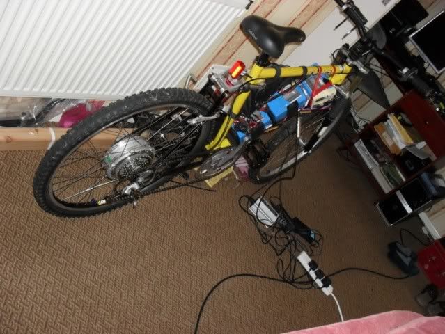

I welded in a couple of aircraft overcentre fittings i had 'aquired' i think it's a nice touch. I just need to carry a 12 sided 3/8" AF spanner with my toolkit to remove the battery. It's not going to be the easiest thing to steal unless you know how it all comes apart :)

Yep, i spent a long time looking for the suitable victim. Try to get one thats a steel frame (including the rear frame). £165 is ok if there are nice parts fitted.
I am really pleased with this bike. I have never had full suspension before, it rides lovely.
I have to upgrade the brakes....i mean, i really have to. Coming down the hill after this climb the brakes heated up big time. The rim and the tyre was hot and the brakes were squealing like hell.
The front forks have the brackets for a disc brake, but the rear don't. I will have to fabricate a bracket and weld it to the rear frame. I think there might be disc clearance issues too.
Work in progress...........

My brackets and battery box were starting to go rusty (like everything does in England), so a coupleof weeks ago i decided to paint everything up. I had a spare BPM that needed a shot of paint, so everything was masked up.
Damn i wished i did this at the very start before i laced the wheel. It's really fiddly masking up every spoke
On goes the etch.........
My build - GT LTS
viewtopic.php?f=6&t=35298
Wurly
Posts: 120
Joined: Mon Dec 29, 2008 7:05 am
Location: Somerset, UK
Re: New build - Old bike GT LTS
Postby Wurly » Sat Mar 31, 2012 12:20 pm
2 pack shiney black
Assemble the battery box for the last time, i added some black plasic with a tiny window to view the BMS led's
Thats much better.
With the yellow frame against the black it makes the bike is a bit more stealthy. Time well spent.
Improvements needed are the brakes, i'd like to wire in a current limiter, dcdc converter for hard wired lights some method of carrying stuff.
A front rack probably.
Having ridden the bike recently, it's turned better than i thought it would. Not ridden it any distance so far, but i'm sure it can take me at least 25miles at just over 20mph average for any terrain. I use the bike for commuting and will ride it to see my elderly father instead of taking the car each time.

Postby Wurly » Mon Jul 23, 2012 3:56 pm
Not much to add, except i put some disc brakes to aid slowing down.
They are Avid BB7 160mm. I bought some brand new wheels and laced up the rear hub once again so front and rear wheels match, this time using 13G spokes in a x1 pattern.
Loads of work, but much improvement. The front discs might need changing for larger diameter one day.
There wasn't a bracket on the rear frame so i fabricated one and welded it in place.
I also treated the bike to a comfy new seat.
Bike is running really well and the BPM motor is getting quieter the more miles i put on it.
No issues with the Ping battery either.
(Not a very good photo)
