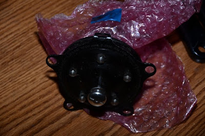

I have a crankset that has planetary gears and 110mm chainring mounts. It provides 1:1 and 1.6:1 selectable gearing, making your chainring 60% bigger, or straight through. With this you can use the singlespeed 16T freewheels and still get high speed pedaling with a reasonable chainring, and avoid the derailleur altogether. The original units are spendy but this Taiwan licensed Schlumpf unit was about half the cost and takes standard chainrings and crank arms.

Postby Alan B » Thu Feb 23, 2012 12:24 pm
I got it from Accountant, I haven't found a link to it. Lets see if I can find a photo.
This photo was to show the shipping damage, it has been repaired. One of the five ears was bent, it is a punched steel part that straightened out well. I'll have to take new photos. You can see the end of one of the cranks in the background. It is a licensed variation of the Schlumpf speed drive crankset with standard 110mm spider for chainrings and standard crank arms. It shifts by tapping the button in the center of the crank with your heel, one way for 1:1 and the other way for 1.6:1. Perhaps Zombiess will be carrying these, I don't know. I'm planning to put it on my Greyborg. I ordered a chainring and short bolts for it this morning. I need to choose some pedals and get the chain and freewheel for it.

Postby Alan B » Thu Feb 23, 2012 12:25 pm
nieles wrote:http://www.schlumpf.ch/hp/schlumpf/antriebe_engl.htm
This lower cost sub-licensed model is not shown on the Schlumpf websites. It is similar but the design has been adjusted for lower pricing.
