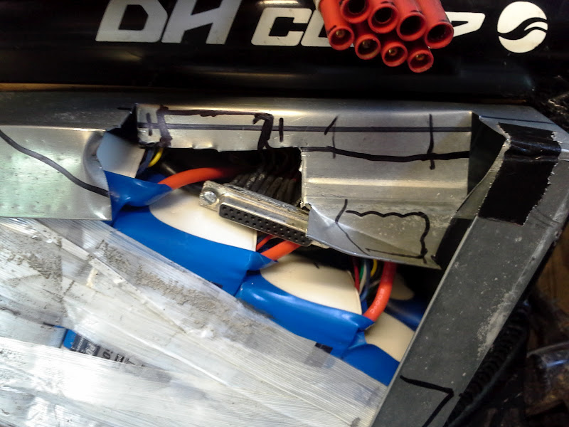

Postby GCinDC » Sun Aug 12, 2012 10:53 am
always happy to find no puffies! :mrgreen:
by golly i can fit a controller up there. don't think it's worth the risk of overheating tho. :roll:

Postby Hyena » Mon Aug 13, 2012 1:27 am
GCinDC wrote:by golly i can fit a controller up there. don't think it's worth the risk of overheating tho
Negative! seal up box your and bolt the controller heatsink directly to that. The whole case will become the heatsink and it's one neat and integrated unit 8)
If you wanted to get really neat you could fit a neat DB/serial type plug and have all your contorller wiring on that (throttle, brakes, 3 speed etc) I did this on one of my bikes and it was nice and neat but a bit of a pain when I broke a throttle and couldn't just plug a new one in.

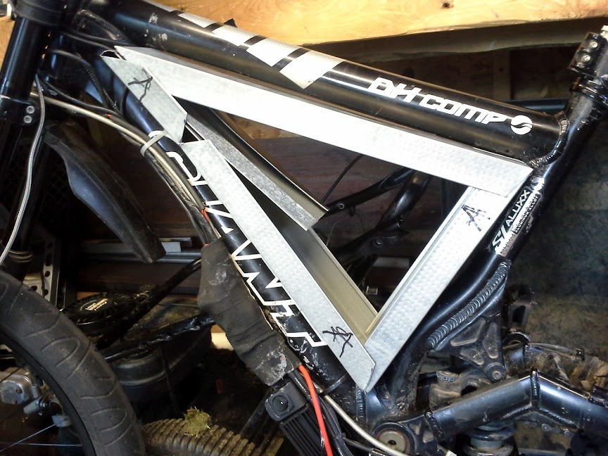

Postby GCinDC » Mon Aug 13, 2012 8:42 am
so just thinking w/ tin snips here... :lol:
i'm relocating the connections to the open space at top rear, and planned to tear up a velcro flap and access either the batt leads from controller to hook up to bulk charger OR 8x plug to balance charge at 5s. the flap i had in front near the handle never worked well. and it was too exposed. the flap i had for the GT worked great. the wires were the perfect length. they need a bit of dangle to be able to access and plug in, but too much dangle is no good either as they need to be stuffed in all the time.
i was also determined to use velcro instead of the bungee, which sucked because A) it wouldn't hold batt in during crash, B) and it put pressure on controller connections, C) and was hard to get around to reconnect to chargers.
but what i realized too late that a loose flap on one side meant i couldn't use a velcro strap there...
f' it. i could just tape the pack to the bike and wrap cordura around it all... i'm not crazy about how that looks tho. so anyway, no rain today, and here's how i rode in:
woops, how'd the controller get all black like that? :lol:
Hyena wrote:seal up box your and bolt the controller heatsink directly to that. The whole case will become the heatsink and it's one neat and integrated unit 8)
it shall be noted that this was my idea from a while back... :evil: not that i was the first ever to have the idea, but.. while i dispensed with at this time, considering how frigging hot it gets, it might stand some reconsideration. :mrgreen:
i'd have to lengthen all the motor wires, again. and the steel frame is far too flimsy to provide any cooling benefit, esp if wrapped in black cordura, but it might be worth spending a minute to find another suitable heat sink. having all the wires inside there would be SUCH a benefit. i've never been a clean freak, but wow that would be soooo nice.
maybe if i bolt the frame to the triangle, cut an access slot for the BATTS...
are we thinking about removing the enclosure here? :twisted:

Postby GCinDC » Mon Aug 13, 2012 8:22 pm
hmm. nah...
this was good for a day...
hmm
nah
hmm?
hmm. unfold the old one, mark the corners on the new one - the size was good so...
snip, bend, snip
hmm
uh huh
BRRRINNNGG. quitting time. stop what you're doing. get it ready to tape up for the morning commute. ok...
gotta remember to get a temp sensor on that controller in the am.
i actually got longer m3's and some steel for a heat sink, but it'll have to wait.
so much for those house projects... :lol:
