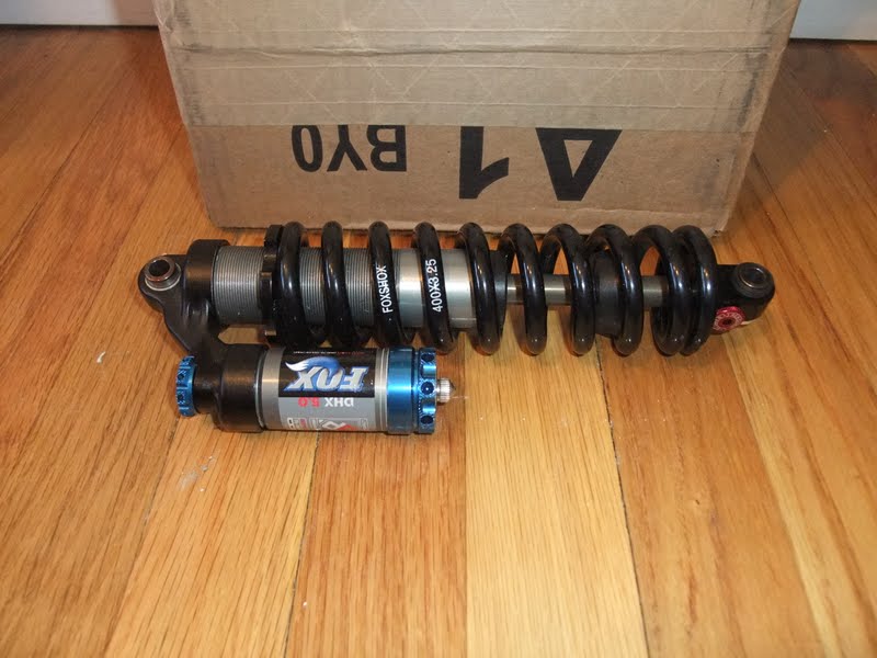

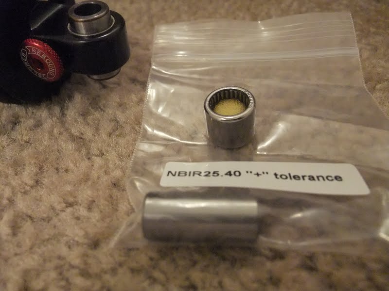

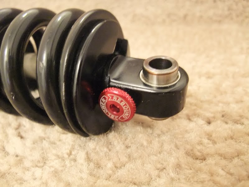

A medium frame Norco A-Line, pedal powered on the right by legs through a NuVinci N360, electric power on the left via a Recumpense DaVinci drive.
Lots of pieces missing... The next to be installed will be the shock, a used Fox DHX 5.0. I'm installing it with a needle bearing kit from Real World Cycling (http://www.enduroforkseals.com/id275.html), I hear they're worth the cost.
Hopefully I'll have at least a pedal bike out of it soon, seat post and seat are on order but have not even purchased chain, chainring or cranks yet (I have some ISIS front freewheel trials cranks lying around, is there such a thing as thread-on front chainring adapter?)

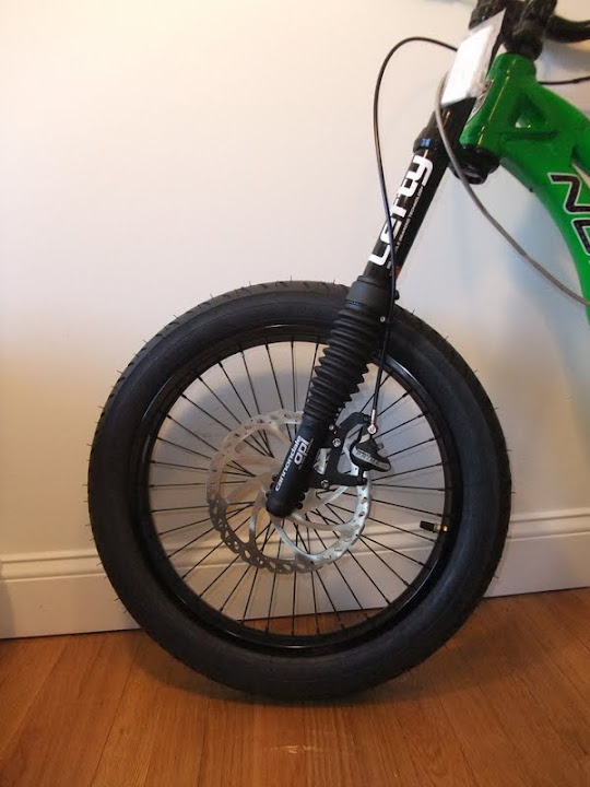

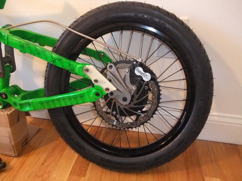

Postby MattyCiii » Sun Feb 26, 2012 8:26 pm

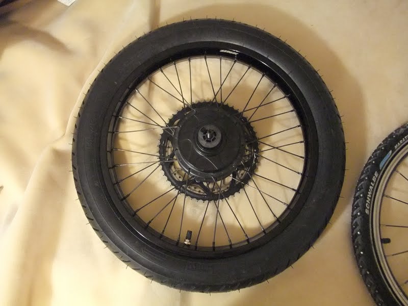

Those are certifiable ES wheels:
Spokes by JRH,
Rims from the Recumpense 47mm wide, 406mm rim group buy.
The tires are Pirelli 16" x 2.5" moped tires. Something I never would have thought would fit a 406mm rim without the ES collective knowledge base.
Up front the hub is a Lefty (of course) hub custom machined by Project321 (http://www.project321.com/), who was incredibly helpful in getting me the right parts to fit a lefty fork to the Norco. Stopping power from a Hayes Prime Pro and 203mm disk.

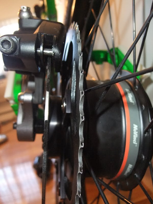

Out back the wheel is laced to that NuVinci N360. I've removed my dropouts in anticipation of Magudaman's replacements http://endless-sphere.com/forums/viewtopic.php?f=3&t=35654&p=532410#p518345 coming hopefully in March.
I gotta thank MadRhino for the tip about Magura Gustav M brakes
Image, there's not a lot of room between the brake rotor and the drive sprocket.

Postby MattyCiii » Tue Feb 28, 2012 6:42 am
Not even 1/2 built and I'm already making changes. I'm using Magura Gustav M brakes on the rear because of the tiny, ~10mm clearance between the left hand chainring and the brake rotor. I got the Gustav as a pair of used brakes through Pinkbikes - I paid $250 for the pair, bleed kit, and a bunch of parts including rotors and pads to last me a long time.
Now I'm thinking - why use the Hayes on the front - why not go with Gustav front and rear? That way I can standardize on one type of brake, carry only one type of spare pad, and have all that Gustav stopping goodness on the front, where it'll do me some good. Of course, I don't have the correct mount to use the front on my fork, so I'll have to figure out which one is right for me and buy more parts...

Postby MattyCiii » Wed Feb 29, 2012 6:45 pm
Here are some pictures of the tires/wheels. I took them to cross/post with this post http://endless-sphere.com/forums/viewtopic.php?f=28&t=29888&start=60#p542254, but also to show the wheel in relation to a close cousin: 406mm bike tires on a more standard bike rim.
Both front and rear are 406mm x 47mm rims (from the Recumpense group buy) with Pirelli moped tires:
Here's the whole thing, laced into a NuVinci N360. Mmmmmmm, beefy!
Here it is next to another 406mm wheel from my "daily driver" Dahon folding bike.
The Schwalbe is a 20x1.6 inch tire. Here it is alone:
And here they are stacked.

Postby etard » Wed Feb 29, 2012 9:37 pm
That's the perfect setup for high powered ebike for the streets, I can't wait to get my spokes in to lace this up! Those dropouts are sick too man. About the BB clearance on 20's, just put some 150mm crank arms on and you'll have a nice low bike and still have pedal clearance on turns. :twisted:
Hey can you put your calipers around those tires? I'm wondering if the wider rim profile flattens out the tire face at all.
etard
Posts: 2028
Joined: Sun Aug 03, 2008 3:28 pm
Location: Redlands, CA
Re: A-Line's Abound: Another A-Line build...
Postby MattyCiii » Wed Feb 29, 2012 9:53 pm
etard wrote:Hey can you put your calipers around those tires? I'm wondering if the wider rim profile flattens out the tire face at all.
67mm.
I have about 4mm clearance between the Lefty and the tire up front!

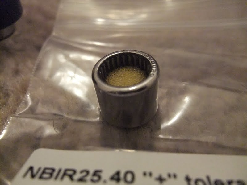

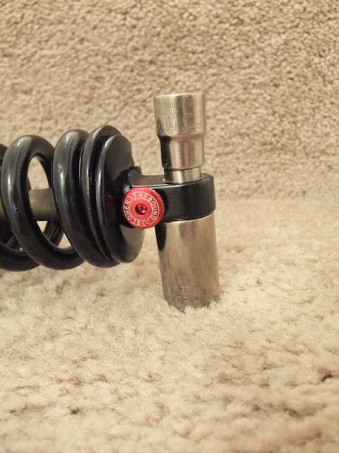

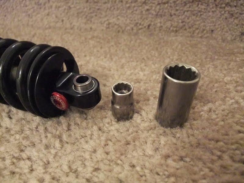

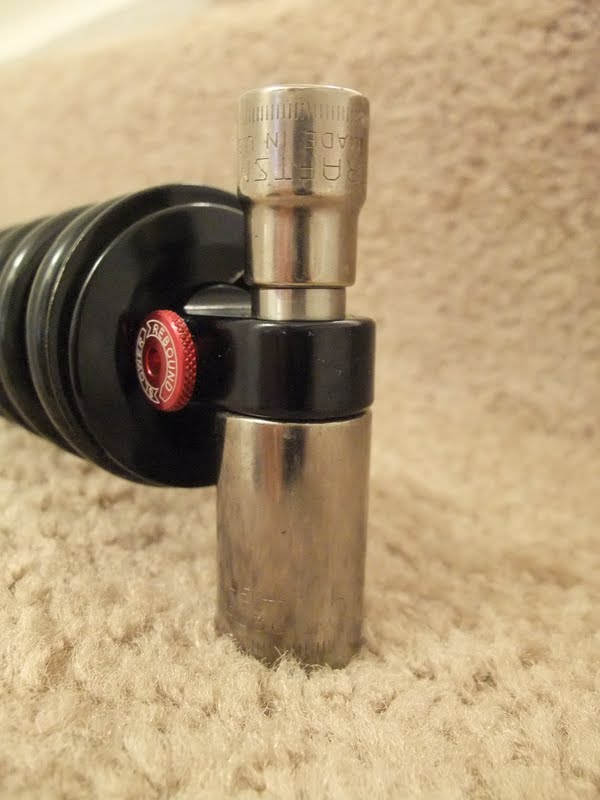

Postby MattyCiii » Thu Mar 01, 2012 4:35 pm
Suspension:
I'm going to replace the rear shock's bushings with a needle bearing kit from Real World Cycling. First I have to press out the bushing:
Don't need special tools to complete the task. Just some appropriately sized sockets, and a vice. The smaller socket presses against the bushing and bushing collar/spacer, and the large socket will be on the other side against the shock's shoulder.
I'll swing by a friend's place this weekend and use his vice.
Here's what will be installed in its place:
Not a lot of work, but without a vice I can't move forward and install the shock.
