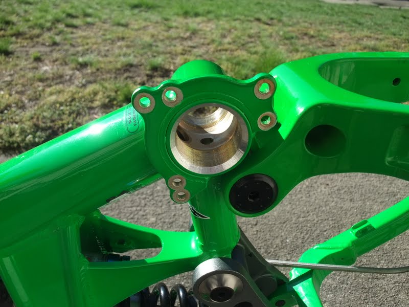

Re: A-Line's Abound: Soon able to move under pedal power...
Postby MattyCiii » Fri May 11, 2012 11:38 am
One step closer to having a working bicycle...
I received my Schlumpf High Speed Drive yesterday and installed it today
It's a real nice piece of kit
The bottom bracket was prepared back a few months ago when I rented the install tool and set my folding bike up with an ATS Speed Drive:

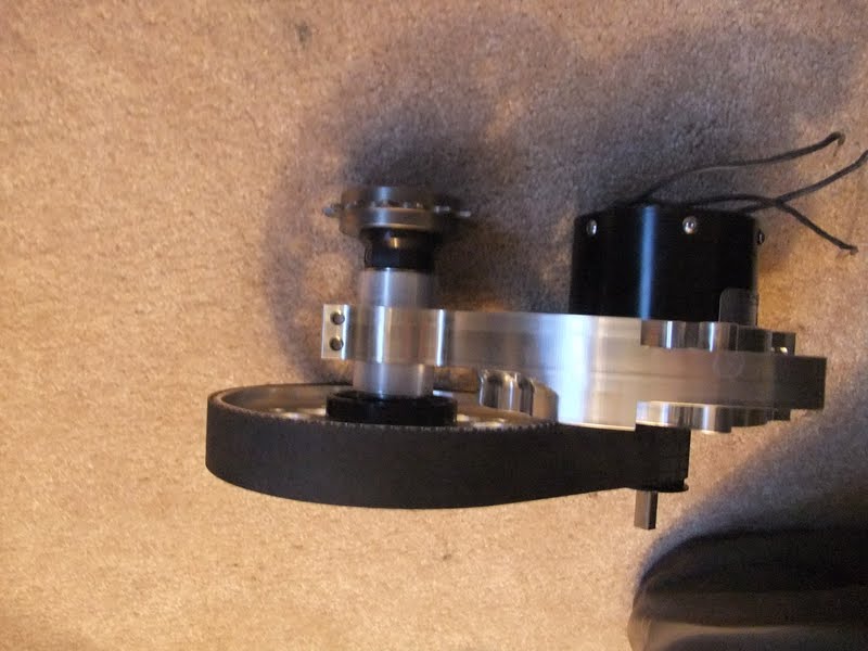

Postby MattyCiii » Sat May 19, 2012 7:31 pm
Electric drive:
My Matt Shumaker DaVinci drive arrived recently and I've finally had the time to look into how to best integrate it into the A-Line. Forgive the crappy pictures...
First, I did not buy mounts for it. I figured my design was just enough off the beaten path that I'd want to study the problem and figure out the best path to take. Here's where I'm at. I plan to fab some custom mounts that attach the shaft collar directly to the custom dropouts/chain stays. The drive will go here:
Hard to picture without the wheel, but the drive is sitting right on top of the border between the custom dropout and the chain stay. The piece that attaches the electric motor mount to the belt pulley shaft collar (see below) is exactly the same width as the chain stay/dropouts. See how I have the motor mount part of the DaVinci flipped, giving me about 15mm of shaft collar on each side of the motor mount. My custom mounts will grab this round tube on each side.
Here's an early design of the mount. At the top it clams around the shaft collar. I'll use a pair of these. The pair clamp down on the square shape in between - on the A-Line, the square shape is the chain stay (I plan to use this same clamp on two different bikes, which is why it has so many holes). This design will change, but it's good enough for now to illustrate. Also, on the A-Line, I have pre-drilled and tapped holes on the custom dropouts I can use to precisely locate and attach the clamp-mounts to.

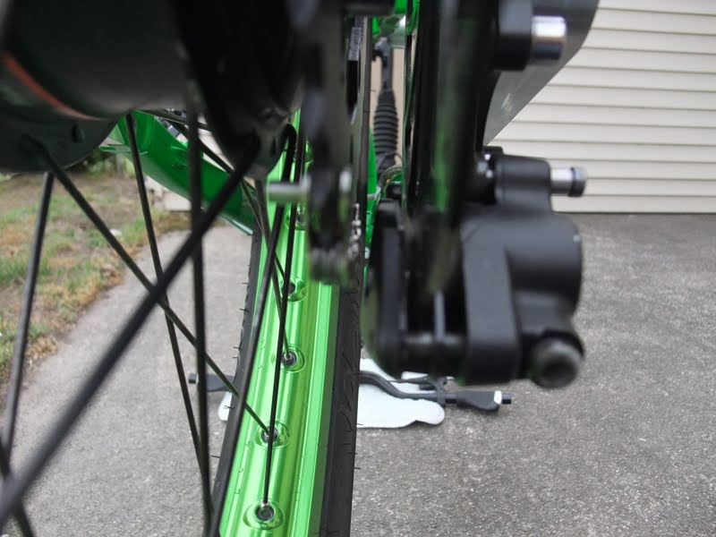

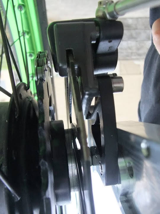

Postby MattyCiii » Sat May 19, 2012 7:39 pm
I'll need to get a slightly longer shaft for the drive. See I have the sprocket adapter flipped. This is necessary for two reasons:
1) If I don't flip it, the sprocket freewheels in the direction of drive - not good. I could use a left hand freewheel, but then I'd need a left-hand threaded adapter and I'm not in a hurry to find one/have one machined.
2) With it flipped I have a nice chain line.
What I won't know is if I'm clearing the spokes. I hope to have the wheel laced up within a week and we'll know. Worst case - I don't clear the spokes... then I'll look into having a shallower sprocket adapter machined, or one that's lefty threaded.

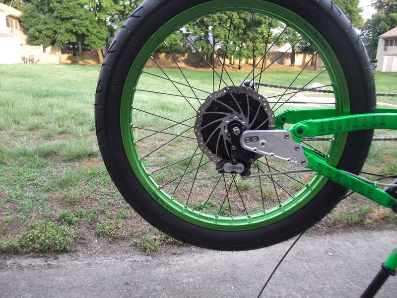

Postby MattyCiii » Tue May 22, 2012 8:45 pm
Received my spokes from JRH and laced up the wheel tonight. No pix, I coat the spoke threads and nipples with automotive anti seize when I build a wheel, my fingers get messy and I don't want to mess up my camera. Tomorrow I'll clean the wheel up some more and give it proper tensioning and truing. Then comes the struggle to mount the motorcycle tire onto the wheel.
Maybe the 5th wheel I've built, went very smoothly. Smooth, but still a pain in the back, sitting on the floor all hunched over the wheel. This was my first 2-cross pattern, normally I go 1-cross due to short spokes (e.g., NuVinci hub in a 406mm rim).

Postby MattyCiii » Wed May 30, 2012 6:49 pm
Thanks Tommy!
This thing is going to be a BEAST! I can still carry it around, but it is getting heavy.
I picked up my finished wheel from the motorcycle shop. I think the owner regretted quoting me $25, he had to do the install manually. I checked to be sure he'd be willing to do the front - I told him not to be shy about upping the price if he has to. I'd rather support a scrappy up and coming shop than save some short money. Well I've got the front laced and true, hopefully the tension is OK. Here's a pic:
I think that seat post will have to be shortened some.
Tolerances from here out will be in the 1/2 cm or less range... part of what makes this hobby fun. This pic is supposed to show the ~4mm I have between the Magura Gustav M brake caliper and the electric drive chainring. Too bad I focused on the rim instead:
Once I get the front tire mounted, I'll actually be able to pedal-ride this thing. And with it upright, I'll able to plan/measure specifications to mount the electric drive. With the wheel mounted it still looks like I can place the Astro 3220 DaVinci drive on the left side upper chain stay. But I'm better off doing all the measures with the bike upright, so that'll be kicked down the road a bit.
One last pic...
A close-up of just the brake side. The electric drive chainring is hiding behind that disc brake. Looks pretty stealthy now, but once I get that DaVinci drive mounted there'll be no hiding the fact that this bike is power assisted.

Postby MattyCiii » Wed May 30, 2012 7:57 pm
A couple more pix:
I just like this pic. Lots of green bike with a nice neutral background.
This one shows the clearance between the brake caliper and the electric drive sprocket, in focus this time.
