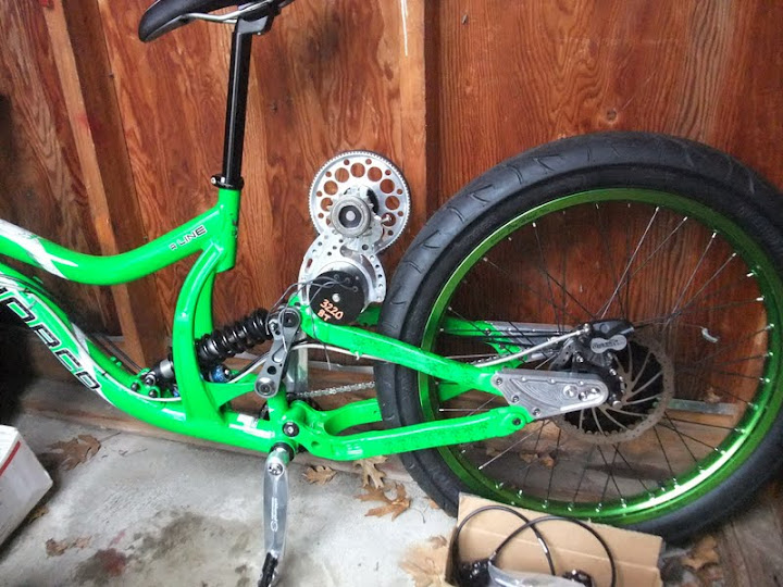

Postby MattyCiii » Sat Jun 09, 2012 6:19 am
I've decided to go tubeless on the front wheel.
With a legitimate tubeless tire and a good solid motorcycle rim, all I really need to make the whole thing tubeless is to seal the 36 spoke holes.
Rather than go with the "ghetto tubeless" approach, I'm going to follow the instructions posted here: http://www.intruderalert.com/cafe/index ... cID=132731
I've got an appropriately sized stream and GE Silicone II Aluminum and Metal formulation on the way. The stem, plus a roll of rim tape, are from Stan's Tubeless. Hopefully this works correctly on the first try, but if not I'm hoping I can just dump some Stan's Tubeless fluid down the stem and seal any leaks.
Form this I hope to gain the advantages of tubeless operation, plus maybe an easier install. The shop that installed my rear tire went through 4 tubes during the install, which does not surprise me considering how tight that tubeless tire fits on the rim.

Postby MattyCiii » Thu Jun 14, 2012 7:10 pm
Well I went with the Stan's type tubeless. The Stan's rim tape has a nice feel to it, but is thin and lightweight. I taped up the rim and use a Stan's stem. I just dropped the wheel off at the motorcycle shop to have the tire installed, now I'm counting the hours till he calls with it finished. Hopefully by 5:30 tomorrow so I can pick it up on the way home.
Once that wheel is done, I'll have a rideable bicycle, and I'll be able to start designing the electrics portion in earnest. :D

Postby MattyCiii » Thu Jun 28, 2012 9:35 pm
I picked up the front wheel tonight, mounted it and took a few spins. Gosh this thing is a ponderous beast! I geared it quite low for pedaling- which is nice, I think I can actually get it from place to place (slowly) by human power alone. The Schlumpf High Speed Drive will be useful for adding power to the (to be installed) electric drive... but without E-Drive, it's impossible to pedal the Schlumpf in overdrive even while the NuVinci is in its lowest gear.
I seem to be having trouble with the Lefty suspension, more on that later. For now, at least I have a bike I can pedal - and can pose upright while I measure for and design mount points for the Recumpense DaVinci power assist!

Re: A-Line's Abound: Achieved pedal bike status!
Postby fractal » Thu Jun 28, 2012 9:48 pm
you're gettin there matt! i really want to see how you will design the mount for the drive. this is something i might be interested in doing for another project in the near future.
Postby MattyCiii » Thu Jun 28, 2012 10:10 pm
You bet!
I really skimped on the pictures, because I was running out of time to put both bikes together before leaving town on a 5-day weekend. I was highly successful... Achieved all my goals. I just didn't take any build pix :oops:
I should be able to get some glamor shots though this weekend.

Here's the bike in its rideable form:

Postby MattyCiii » Sat Jun 30, 2012 9:07 am
Here are a couple of options I'm considering for DaVinci drive placement:
Option 1:
In front of and above the rear wheel. This will bring the weight of the drive closer to the suspension pivot, minimizing the impact of that unsprung weight. The down side is that it makes the chain line longer, and I don't have a lot of clearance past that 3" wide rear wheel. The suspension triangle is very curvy there as well, which will make mounting the drive a challenge.
Or:
Option 2:
Place the drive on the left upper chain stay, a little above and forward of the dropout and rear brake. This makes a shorter chain line, and should make for easier mounting of the drive system some flat surfaces and bolt holes available on the custom dropouts). Down sides to this are moving the unsprung weight rearward on the suspension, very little heel-strike clearance, and drive system closer to road debris/water splashes.

Postby sn0wchyld » Sat Jun 30, 2012 11:16 pm
ill take it there's not enough space between the wheel and the bike, between the 2 swing arms? I'd think option 1 is best, but you'll want to check that you wont end up hitting the frame under full compression. I've had a small pannier attached to my seat, and even with the smaller wheel it got hit by the tyre fairly often.

Postby MattyCiii » Sun Jul 01, 2012 7:04 am
sn0wchyld wrote:ill take it there's not enough space between the wheel and the bike, between the 2 swing arms?
Great question. It would be really awesome to have the motor right on top of the upper arm and the large reduction pulley & freewheel inside that space. Sadly the parts I have are too big. But I think if I change some variables, it will work out. For all its stiffness and cool-factor, the DaVinci drive is bigger than the V4 drive in many dimensions. I think I'll try my V4 drive here and see if it'll get the motor where I want it. Also the large belt pulley is just a smidgen too big... I got the 5:1 pulley and I know Matt sells a 4:1, so perhaps a 4:1 pulley will fit.
It will likely require custom brackets to hold things in place firmly and correctly, but I had a great experience with bigbluesaw.com making brackets for my other bike, so now I'm confident that if I can design it, they can build it.
