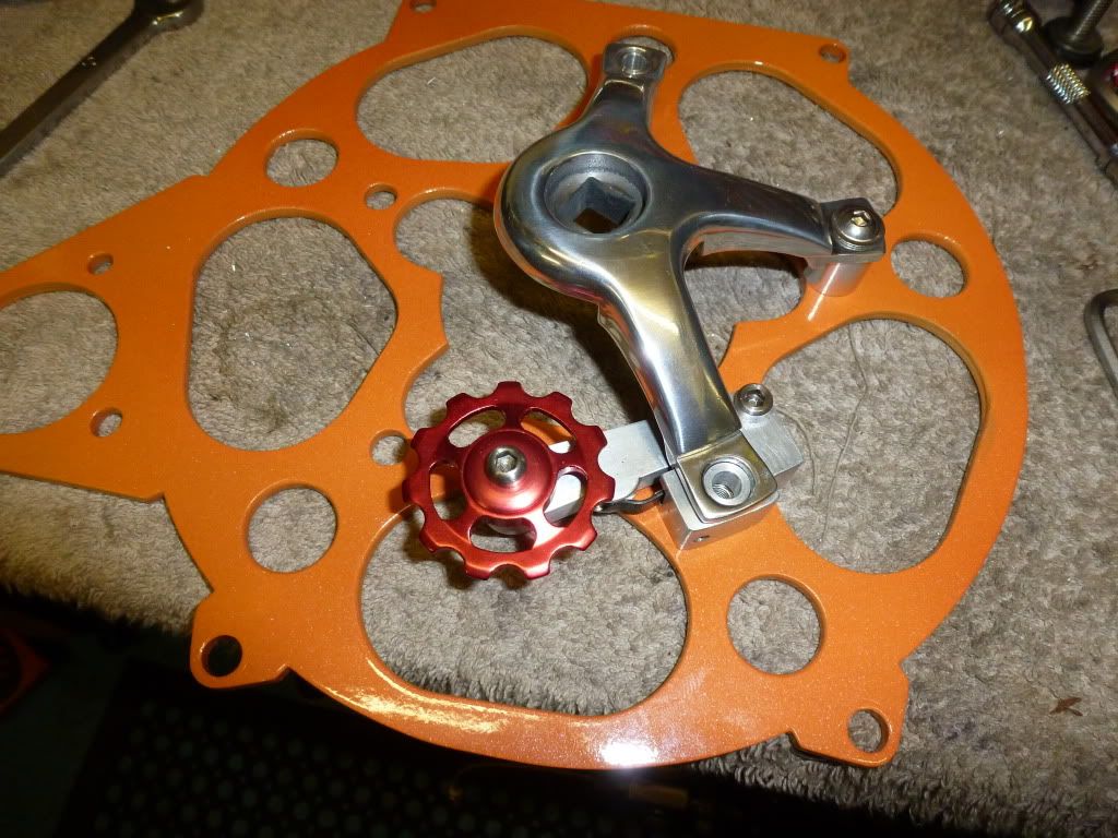

A few more pics cos i have them :D
The left side of the motor showing the new bigger O/D alloy spindle with larger seals and a spacer to protect the upgraded phase wires;
The right side showing the out rigger support bearing inside the sprocket carrier, side cover has the thread changed to L/H 30x1mm so it tightens when the motor is driving with a southpaw (lefthand) bmx freewheel (Ground down from 1/8" to 2.00mm for the 7 speed chain)
Pedal crank spiders have been used as the torque arms/motor mounts.
