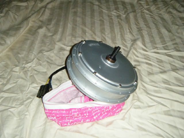

Having arrived safely, Monster sees the light of day for the first time.
Monster looking sexy in her sassy Panties. (Girlfriend is going to kill me for these pics)

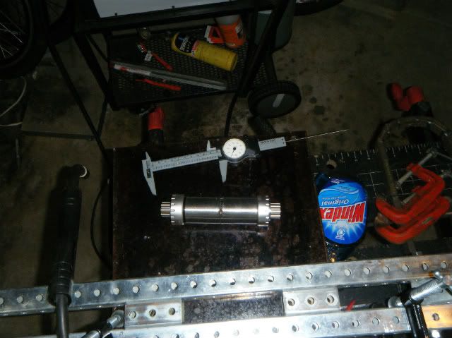

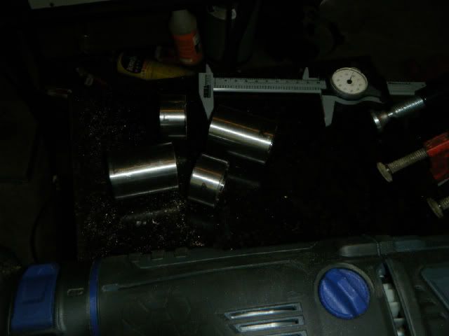

This is what happens when no one has a 100mm bottom shell in stock for 4 months....
I make my own out of 2 66mm

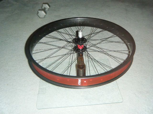

Front wheel going together. 65mm rim, 20X110mm axle

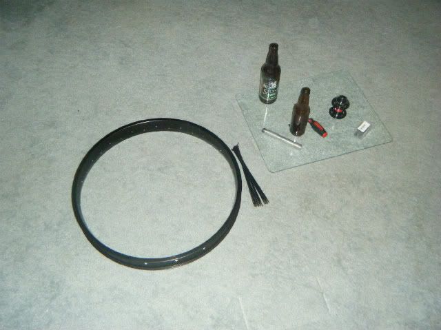

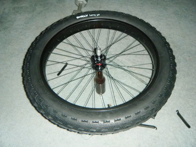

First was the wheel. Thanks to JRH for the awesome job on the 12g black spokes and 16mm nipples. Mmmm, big nipples...

I did manage to figure out the rear pivot point. I gave up trying to make my own, and cut one off a Motobecane moped I had been meaning to fix up. Its a perfect fit, mostly.
But then I managed to screw up my bottom bracket. after all the struggle this winter to get a 100mm bottom bracket shell, bearings, and shft, I managed to screw them up. I warped the shell welding it, its now egg shaped. And in the proscess of trying to bend it back round, I managed to jam and destroy one bearing shell. I'm going to have to replace the bearing, cut off the bottom bracket, and start from scratch. Luckily, these parts are more common than they were when I started.
So success and setback. But with luck, I'll have this bike standing on it's own tires by the end of the week.

Post by Drunkskunk » Sep 04, 2012 10:48 pm
Progress!
Well, Drew Barrymore Swings, and now my bike does too.
I finally got the Swingarm finished.
Except for the brake cable guides. I've got no clue how I'm going to make those yet. Zip ties would work but I want something more permanent. I can sort that out later. Its functionally finished.
And like Drew, this thing has some mass. Its 8 lbs of swinging goodness. Its also 27 inches long, 10 inches longer than My Kona's Swinger. That means it can move farther without changing angle as much. It should be a smooth ride over small boulders and survive everything short of an IED.
Or maybe not. But I won't be able to kill it.
