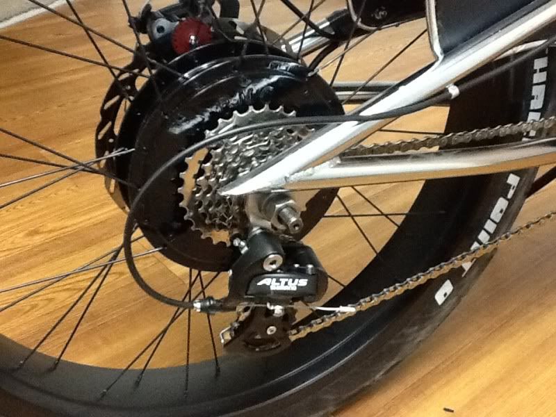

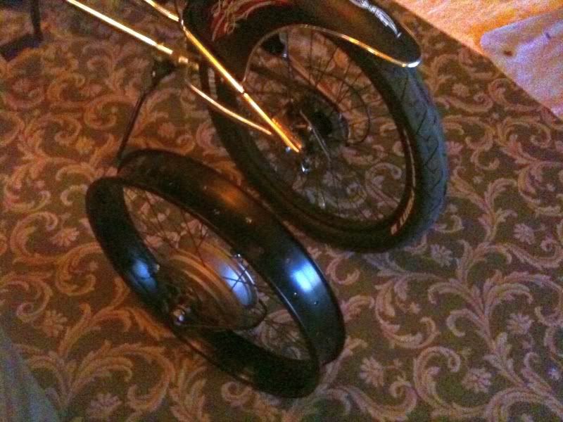

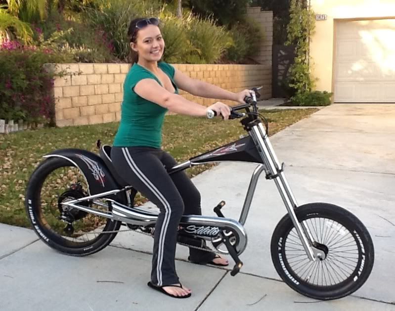

I was working on a chopper project of my own earlier this year. It's a Giant Stiletto for my brother. He likes riding the bike but it's difficult to ride in the steep hills where whe lives. Some of those steep hills have up to 15% grades. You practically have to pedal standing up and that's not cool nor comfortable on a chopper bike. So I "electrified" the bike so he could enjoy riding it around all those steep hills.
For the electrics... I chose to give him a BMC V2-T (torque) motor, a 18-FET BMC controller, and 12s LiPo batts (44.4v nominal, 50.2v hot off the charger). I mounted the controller and the batts on the bottom tube.
For the wheels... he had a 24-inch wheel in back and 20-inch wheel up front. I know a hubmotor up front on a chopper would feel sluggish and terrible for steering so I decided for a rear hubmotor. I bought a 3" wide black anodized rear rim (as an upgrad from his original 1.25" rims; fortunaltely I was able to find one with 36 spokes). I bought the black spokes and had them cut to the proper length, then laced up the BMC V2-T motor to that 3" rim.
For his brakes... he originally had 6" disc brakes. Fortunately the BMC motor had disc brake mounting holes allowing me to keep those rear disc brakes. But I also upgraded those brakes to a larger 8" disc and better Avid BB7 brake calipers.
Anyways, I've yet to finish the bike but here is the results on the day of the initial test ride...

The BMC V2-T motor is a geared hub motor that has plenty of torque @ 44.4v to climb up the hills as seen on this video.
There is an equivalent MAC 10T geared hubmotor that's availabe now for half the cost. In fact, if you look online at http://www.emissions-free.com/catalog/c5_p1.html you'll see the MAC 1000W Rear Kit (high power) for $385 that comes with both motor & 12-FET controller which is just slightly more than the $340 motor kit you were looking at getting. You can even ask Cellman to see if he can have that motor laced up into a 20-inch rim for you.
The benefits of having a geared hubmotor is that:
-it freewheels (and doesn't have the cogging/drag that direct drive hubmotors have)
-is much lighter
Since you have a smaller 20-inch rear wheel you also might even consider getting the faster wind MAC 8T or 6T motor.
You might also look into upgrading to disc brakes since rim brakes are a PITA to use on wide rims. I know you might not have the mounting holes on your frame for the disc brake calipers but Cycles US now sells this aluminum billet disc brake adapter bracket that allows you to put those disc brakes on. FYI the MAC motors all have the mounting holes for disc brakes just like the BMC motors do.

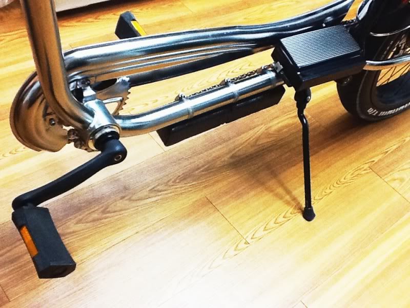

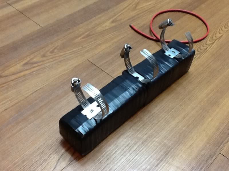

My only real issue at the moment is mounting the battery, I wanted to mount it on the back above the back wheel with a rear bicycle rack but I was not able to find one that would suit as yet.

Yeah my only issue has been finding a hub motor that will fit in the very wide 175mm dropouts.

My only issue is having the tempation to go faster on a cheap bike lol. I was thinking that the 750w or 1000w might be too much amp draw for my lifepo4 48v 16ah battery

Haha yeah I sure do worry a lot. I have made my order from Conhis, I would have loved to try through Cell-Man but its been a while and hadn't heard from them.
I have my order below. The 25amp controller will more likely put the motor into the 800w realm if I have calculated correctly, but the speed controller will cut out at no more than 25amp which is good.
I'll actually record a video on that first acceleration lol.
Assembled Hub Wheel:
48v 500W 20" x4.25" Wide Rim, Spoked and Assembled with Tyre and Tube
Motor Controller Specs:
New Style 48v Max 25amp Controller and Controller Bag
Throttle:
Twist Throttle with Key and matching Handlebar Grip for Non throttle side
