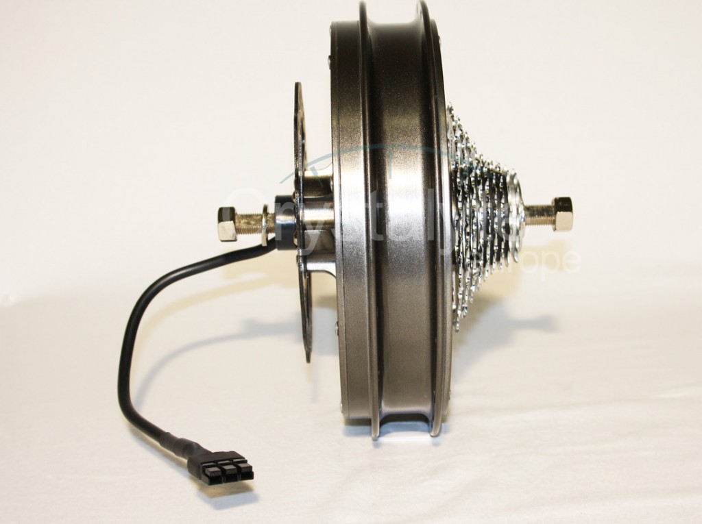

The motor came laced from crystalyte? Then yeah that is your problem, but they are sturdy rims man. Heavy, but sturdy. The spokes they use aren't a joke ether, have you tried to cut those things with wire cutters?! My hand was getting numb from all of the squeezing :shock: .

Lol nah no switch. Just a wire. They are a tidy package. Well the motor has a mini din for halls but the controller comes with male+female big square plug on halls. I'll look at getting a mini din for controller, much neater. And phase I will use the plugs that came with the controller and solder them together. As for not sucking power, we will see... doing burn outs in dirt seems to take a fair bit of current :) also I want my old mate trav to try this one in the adelaide hills, he weighs about 100kg Scottish/leboneese/Egyptian staunch mofo. Hopefully if it handles his punishment he will eventually get his own bike to :)

Lyen sells the mini XLR din style plugs that match the Xlyte motor. I always a few more when ever I order from him. I use them as standard all the time now.
As for the big spade terminals, I use them all the time too. Again Lyen sells them and whenever I get an order from him, I always get a few more of the same. If you look at them internally on the female side that have a flat tongue, so you have a full width connection on both sides of the male part. I have never had problems with them, running 100volts with a 18 FET 4110 at 80 or 90 battery amps and 270 phase. I use them on the phase wires too. Beats the big andersons hands down. They don't have plastic shroud to melt like andersons, and they are far more compact. The crimp end seems to come in two sizes, and it does seem to be pot luck what size you get. The bigger size will probably handle 8 or 6 gauge wire.
Thanks guys, so what's the verdict with halls? Xlr? I thought lyen would set up the unit with plugs for the ht3525. Not too fussed though. He was good to deal with, fast delivery and YouTube test video is a nice touch.
