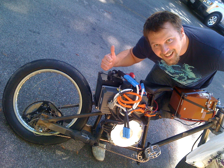

in the meantime this picture best explains the damage although not at nearly the same power as luke's "bike"
the problem clearly was the way the rim was laced...which (in all honesty) was a bit sketchy to begin with - but i didn't ever imagine anything like this happening (maybe a single spoke or a few at most). it was done at a lbs but in a somewhat crude manner. instead of using proper 12ga spokes (the correct size for the motor - but too big for the rim) or using a tapered 12ga to 13ga spoke (so it would fit correctly in both rim and hub) - a 13ga spoke was used with brass washers on the inside of the motor flange to prevent (or so we thought) the spokes from pulling through. im definitely gonna have a talk with them and see if i can get it laced up for FREE and PROPERLY this time. luckily (as far as i can tell) nothing was severely damaged. the rim is fairly scuffed up and possibly out of true - its hard to tell now as i haven't taken it apart yet - and don't have the time/ambition too atm. frankly im kinda pissed haha. the motor is also scuffed but appears to not have taken any severe damage.
